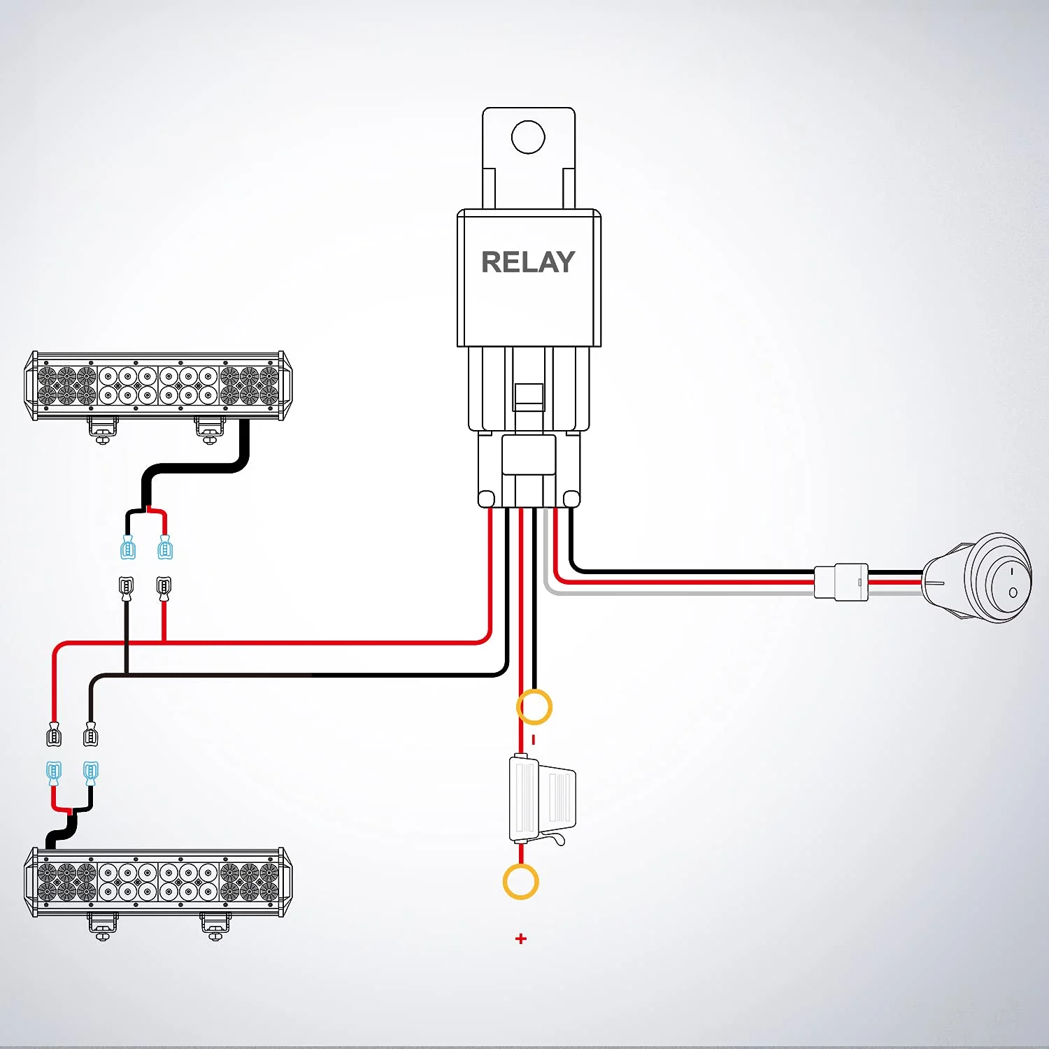

Thanks. What's weird is I have an inline fuse and relay but the switch still stays on. I thought I needed the Fuse tap to fix that. Maybe I wired it incorrectly?
yeah I would assume it's not wired correctly. Is yours wired kind of like this?

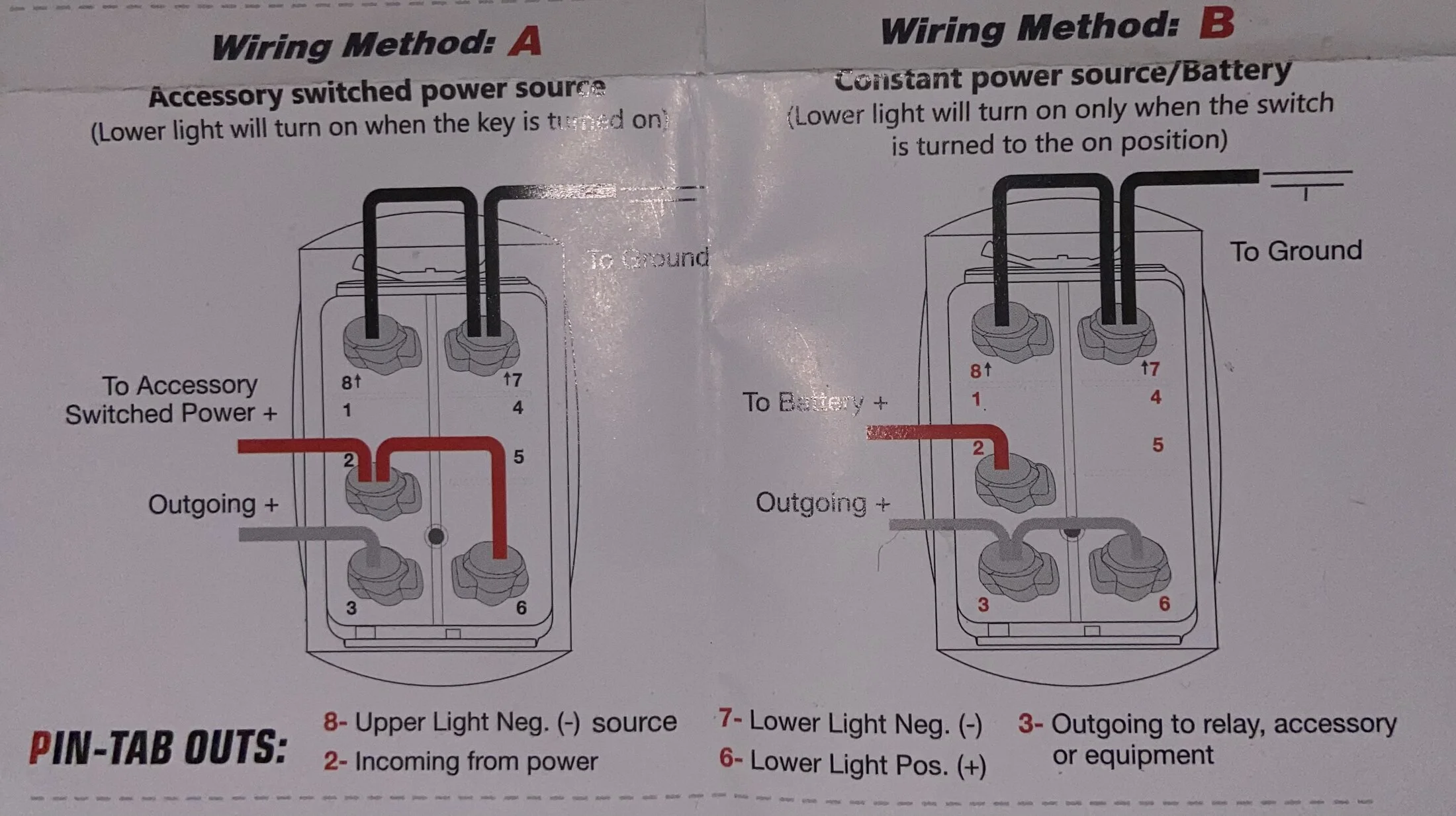

It’s typically based on how your switch is wired. There is usually a setting for constant light and one that only illuminates when in use. Below is an example.
