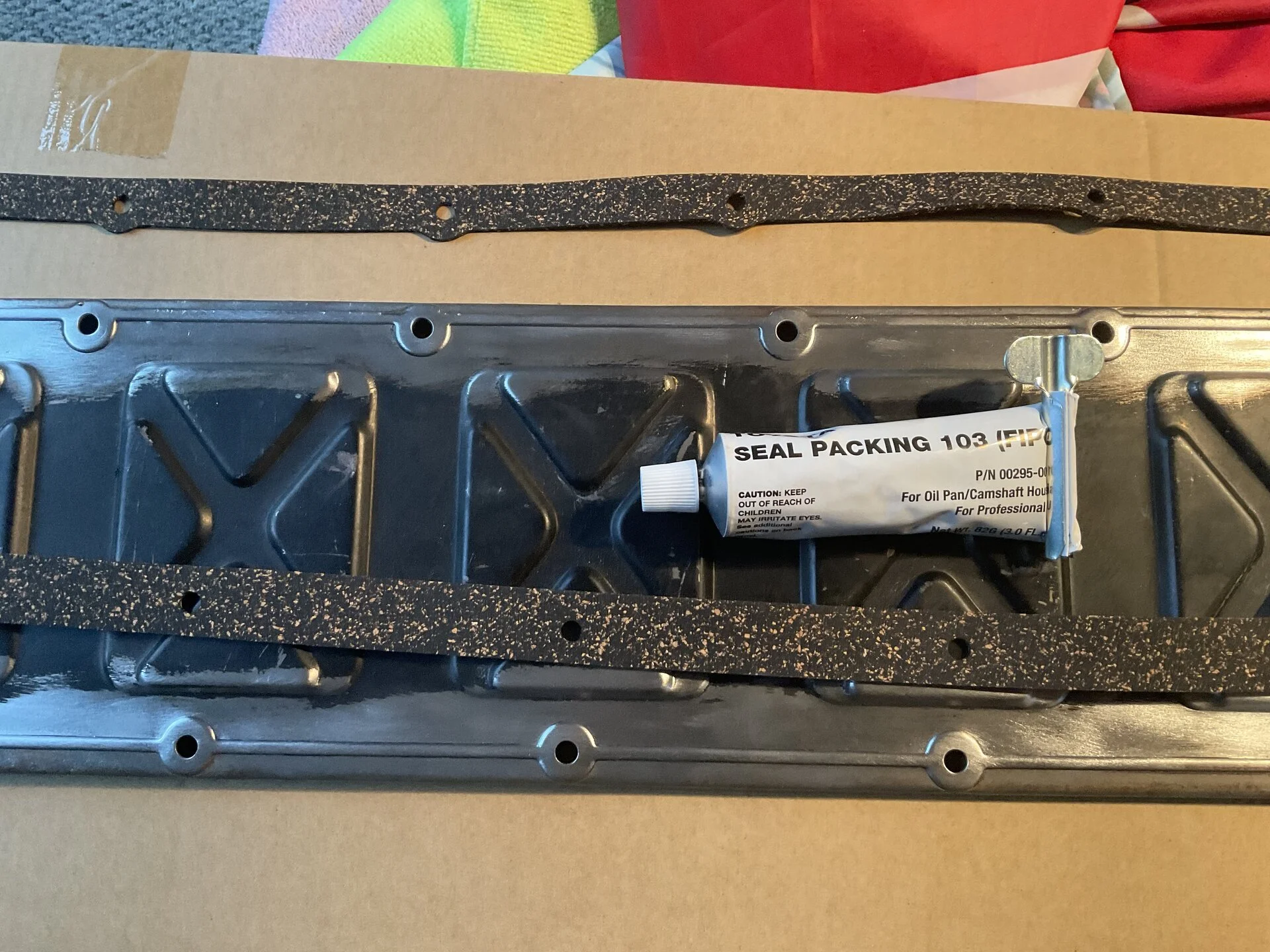

I read that the black Toyota FIPG (Form In Place Gasket) was recommended to install the oil fill tube in my 67 FJ40 block. Little dab around the base where it goes in he block.
I’ve seen discussions on the board that recommend FIPG use elsewhere, such as water pump and t-stat gaskets, even the t-stat bolt threads. I have a tube of black FIPG now.
Can I use FIPG on the gasket for the side plate (pushrod access cover)? Valve cover gasket? Oil pan gasket?
Is there a general rule about where or where not the black Toyota FIPG can be used? Is there a more recommended gasket in a tube? If I’m not screwing up, I’ll use the FIPG for oil pressure regulator, fuel pump, etc gaskets as well. Am I flirting with disaster?

Thanks from the VA Mountains.View attachment 3223778
To quote an old tv advertisement for hot sauce, "I put that sh!t on everything".
It's the best FIPG sealer ever, but expensive. Both flavors. A must-have in my tool chests.
I used it on both my pushrod gallery cover ("side" cover) and my oil pan. What I do is, spread about the thinnest layer that I can with a (nitrile-gloved) finger on both sides of the cork gaskets, then torque to spec, which is only 93 inch-lbs. Both are still 100% leak-free after 15 years.

Thanks @1911 ! Had to laugh, part of my brain remembered that ad—also a hot sauce lover. Adding phrase pushrod gallery cover to my tech nomenclature vocabulary, TY for that. It helps to be precise in most of these matters.
Roger roger on the inch-lb torque spec, not to be confused with ft lb. Thanks for the application tips as well. It all matters. @ToyotaMatt quotes make it easy to remember which ’everything’ is what. Time for me to go use up some nitrile gloves.
