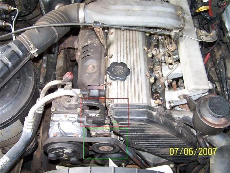

Which bits do you need? The ones in the red square also?

Cool! I'm not sure what that means, but if it means you think you can help me i really appreciate.

I have a picture of the tensioner. It's a sliding bearing guided upwards on a small bracket. I count 9 pieces total, including the mounting bolts. I have all the part numbers, but I need verification.

Mine looks just like the one that rosco posted a pic of, so according to his sig is a 95 model.

Dude, according to Toyota Parts DIY, the part numbers are the same from a 1990 HZJ75 to a 1995 HZJ75, so I think you are good to go.
There are three part numbers:
1) Bracket, Idle Pulley (cast piece behind pulley) 88444-60100
2) Bolt, Idle Pulley (adjuster bolt) 88446-60030
3) Pulley, compressor cooler Idle (pulley, bolt, washers, nut) 88440-60040
There are a pair of standard item bolts you can source locally.
I'll fax the local dealer on Monday and get you the Costa Rica prices. If they have them in stock and the prices don't scare you off, I'll buy them and bring them with me on my trip to Socal in a few weeks, then send them to you via UPS.
That work for ya?
Rick
