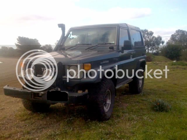

When i was cruiser hunting called past purely commercials looking at a 79 the bloke denied 100% it was not from the mines then i explained a few point outs of ex minners then agreed then denied it was ex underground ,everyunder body of underground utes id seen looked identical to this one same corrosion style rust on all chassis diffs bolts ,every vehicle ive seen there are trashed covered in black paint and it really bugs me that some poor bugger will buuy it and have problems.
He got it from a mob behind wangara toyota
he got prices around $4200 for a 2" lift and 2" body lift, so i said weil go see my mate colin at malaga springs for some dobs ,2g for springs etc and $600 for a body lift
In the later pics with his new rims it has the 2 in spring lift but not body yet

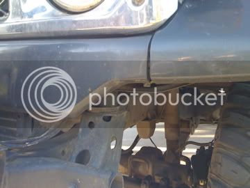

Why doesnt he just go for a bigger spring lift?:confused: I think you can go almost 4 inches on a 79 series
i think a 1" body lift would be better than 2" body lift , it dosnt rub now so it dosnt even need body lift but i think he is chasing "looks" 4inch spring lift cost a lot more dosnt it?, because you need to buy diferent drop arms to avoid death wobbles etc ?
The downside to body lifts is you have more sway between the body and chassis. This can cause squeaks and other annoying noises.

you also need to adjust raditator mounts or something with B.L's ??
I gave my cruiser a 1" body lift. Was easy as. Only had to change the negative battery cable from the batteries to the block
as it was to short. I think it looks better that way. Not as squaty as it was before. I kept the rubber cushion block under the
body/chassis mount bracket and have a poly block on top between the body and mount. Still lets the body flex. Works for me.
I will be able to fit 35's if and when I want to. A town and trail set of rubber is on the cards.
2" and over and there are a few more mods to do. The radiator shroud and gear shifts have to modded and possibly a few other things.
