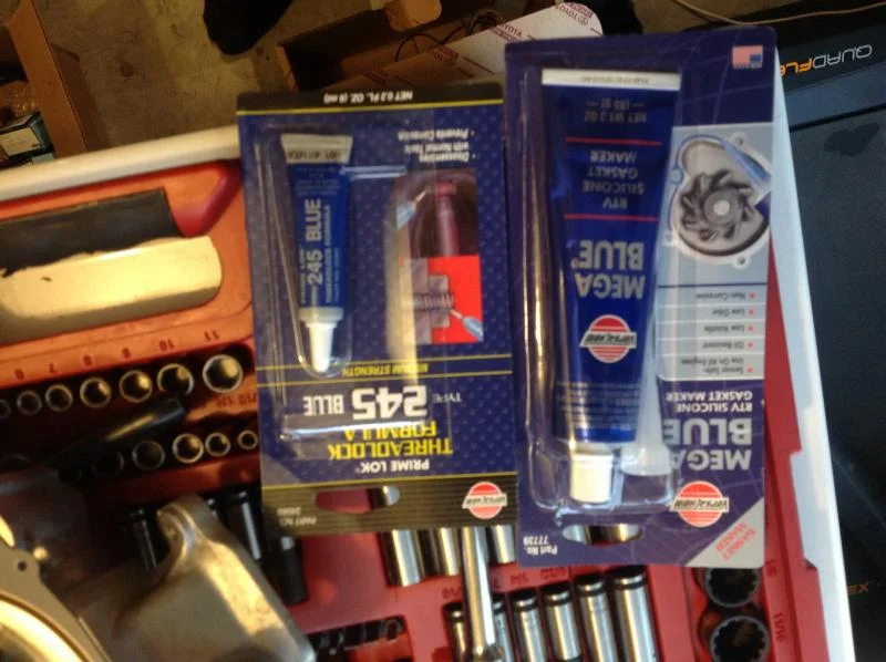

Will these products work for my applications? Edit: I have no idea why this pic is upside down.

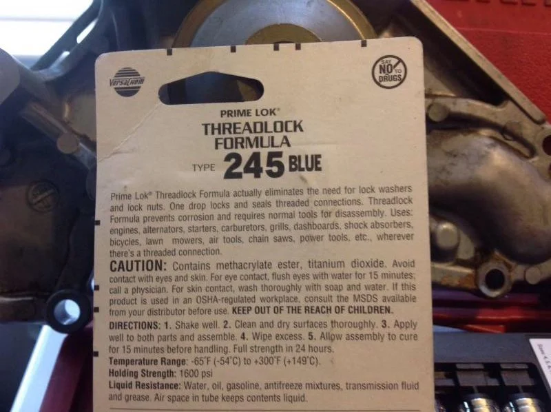

No if loctite 245 is permanent, 242 is for removable bolts. I've not done water pump on my 100 but would not use gasket sealer unless called for. If called for Toyota dealer has best you can get, ford & GM guy's even use.
Damn. The parts dept is closed on Saturday. The gasket maker is used once where the water inlet housing meets the water pump. And here is this little bit on the 245? Is it good to go?
The 245 is 1600 psi it will work but don't use much or next time this is going to be a b*#$h to get off. The FIPG will also work, but Toyota has unbelievably good stuff. I was missing water pump gasket on a Sunday when I did TB job. Decided to not replace water pump, since it past inspection. You can always wait a few days to finish job.

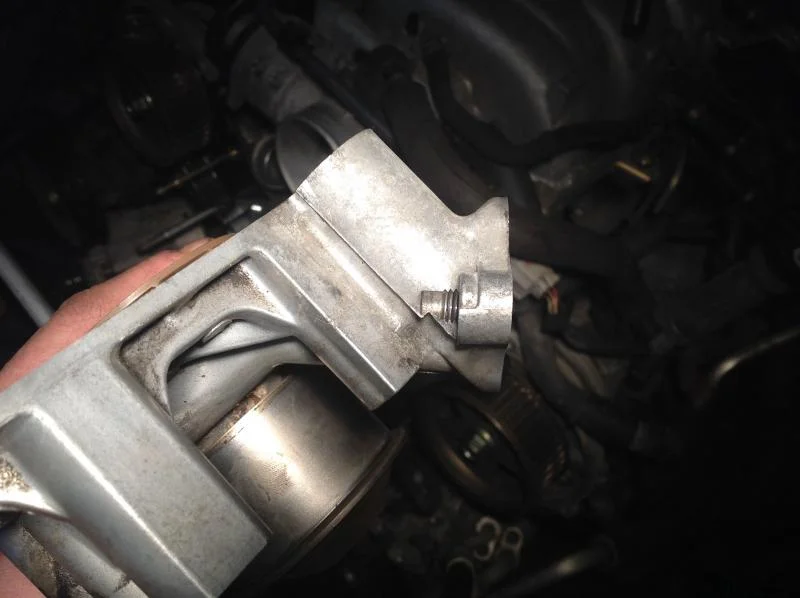

This is what an artery looks like after someone has been eating too much McDonald's.
No but this is my weep hole pretty much clogged. The pulley is just slipping back and forth. I'm surprised I wasn't overheating. Although when I'm driving I'm pretty hypersensitive to noises from the vehicle, so I noticed as soon as I heard the slightest sound of a noise.
Edit: air hole , not weep hole.
