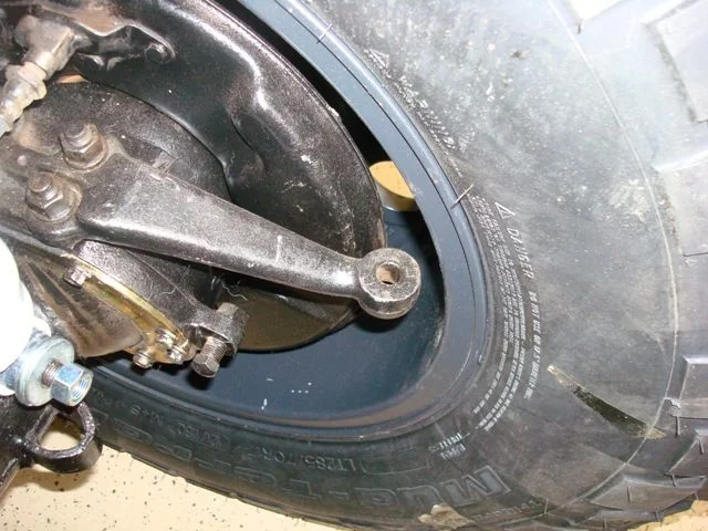

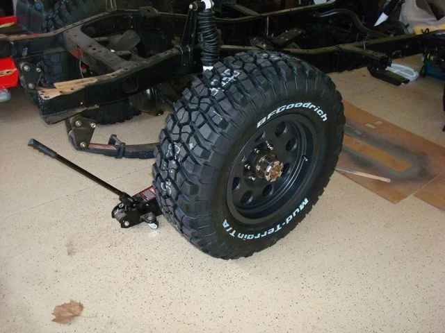

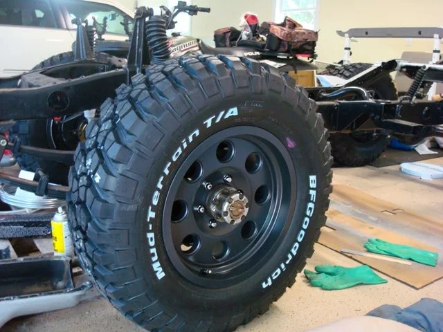

Well I broke down and bought some American Racing Mojave 17x8 and BFGoodrich MT KM2s (285/70R17). I think I will be alright on the TRE per pictures. :D
Does anybody know size of Lug Nuts? The ones they sent me are too small.
