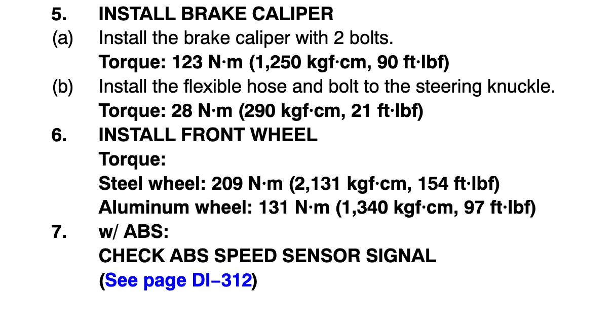

But in all seriousness, I torque my lugs to 97 ft-lbs
Book is 97ft-lbf (no oil/lube on threads)

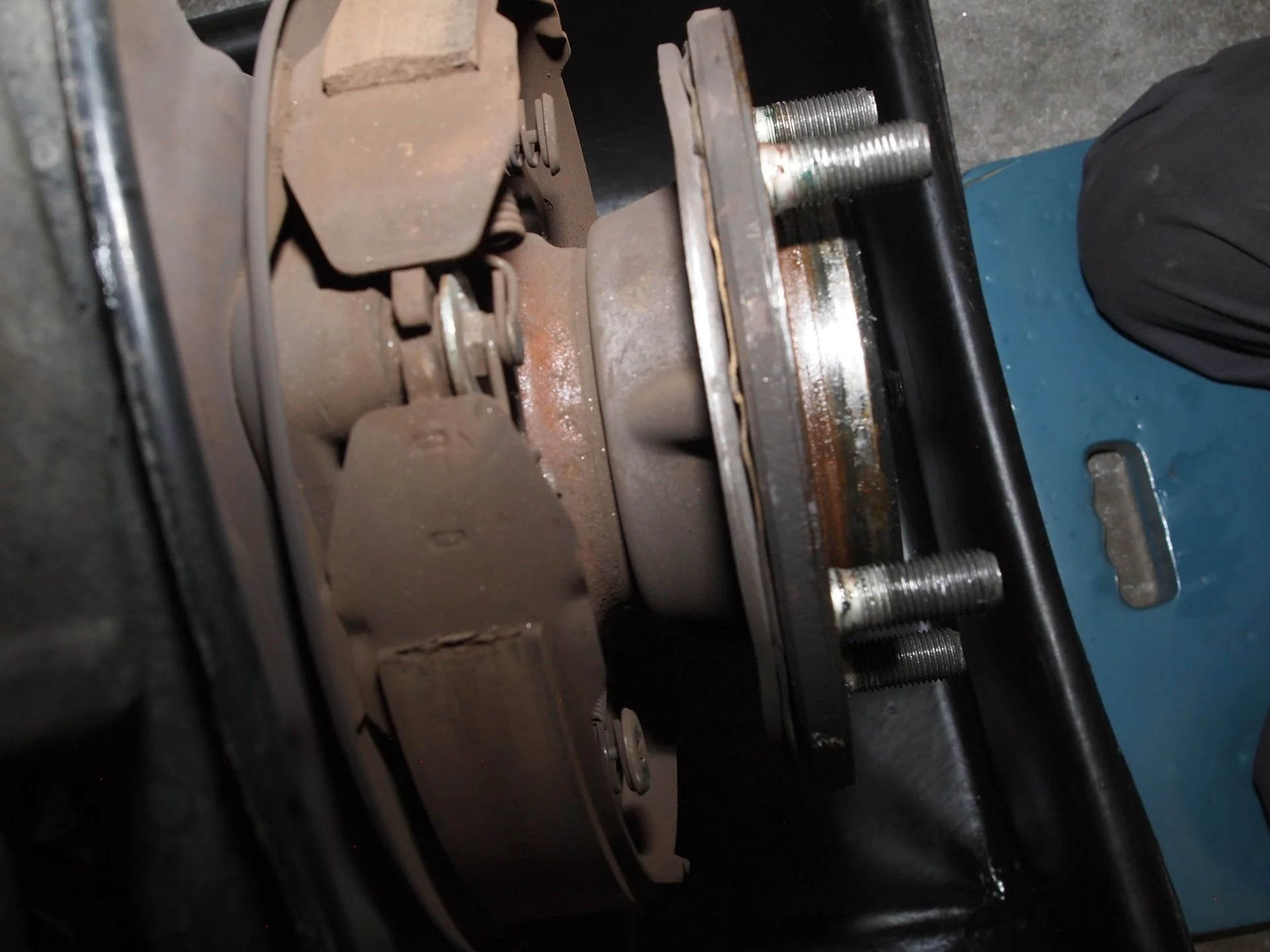

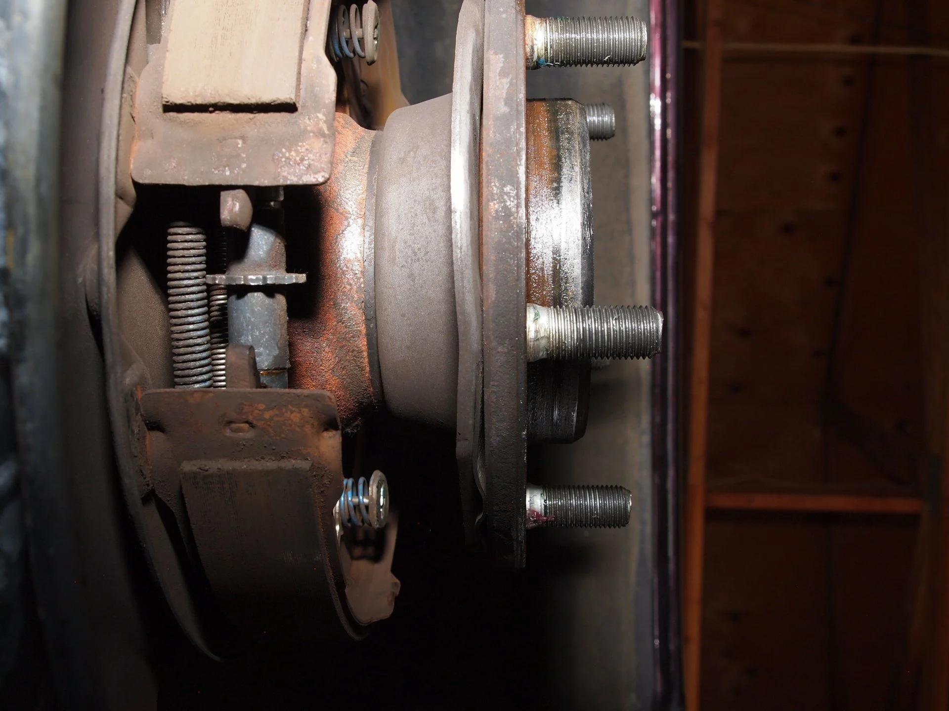

Here's one bad thing that happens when rears are over torqued.
Oil deflector becomes warped and gasket eventually falls into drum, yielding a funny sound hard to diagnose.
