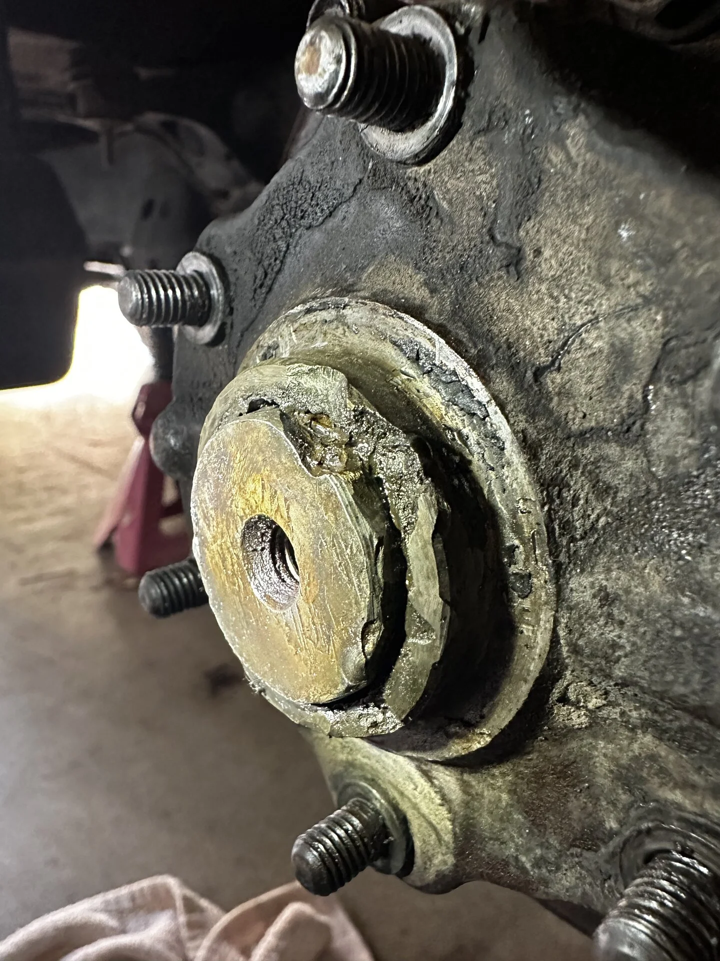

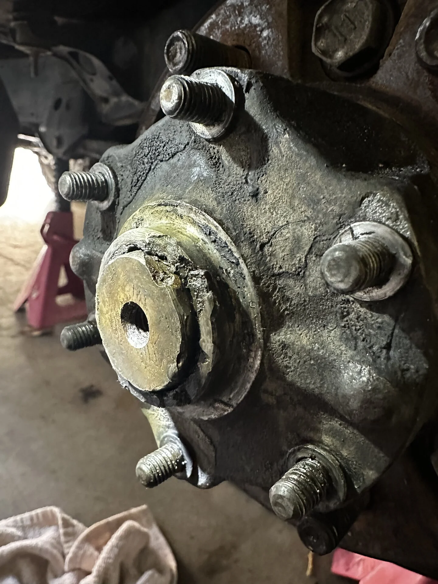

Wheel Bearing/ spindle damage? What am I lookin at?
Jan 13, 2023
5
25
Arizona
Was told by a shop to replace my front wheel bearings. After I got the hub cap off the passenger side, this is what I saw. I don’t see a snap ring. I don’t even see the grooves on the tip of the spindle. There is some narly damage on the spindle and the flange itself. Is it safe to say I need to just replace this whole assembly or can I just ahead and do the bearing only? If so could someone point me in the right direction as far as part numbers or what assembly to get. Thanks
Honestly, I don’t even know what I’m looking at. Is that the end of the spindle or birf? Someone please help clarify this for me.
You are looking at the flange, still attached. Get that off and you'll see the snap ring, spindle nuts, etc.
Hold on a sec, there should be a snap ring on the end of the shaft there, maybe under all that grease. Also, the locking cone washers are still on the studs.

Looks odd for sure,
check there's no snap ring on the end of the birf, try and get the flange off then hopefully you can better see what you're dealing with.

Prob a knuckle for that side as well, plus hardware, with no clip on the end the birf is probably chewing up the knuckle.
If this was me I’d plan on front axle rebuild plus all new parts not just wheel bearings.
You really won’t know till you bust it all down.

But can you wipe the end of the spindle off and take another pic. I can't tell if its packed with old dried grease or somebody's been beating the crap out of it with a sledge hammer.
The snap ring should be right there.
That sure does not look good... kind of looks like the shaft spun on the drive flange...
If you grab onto the hub, the thing with the lug studs, does it spin nicely, or can it move all over the place and sounds like steel on steel?
If it does... Not to worry everything is replacable, and you can get it all going again. In our local club we had a member @StucknKS that we replaced everything from the ball out and had it going again before dark....
That’s not the spindle, it’s the drive flange with the end of the birfield (stub axle) sticking out. And it looks like someone was beating on both.
Find a place to park it up for a few days, buy a front axle kit from Cruiser Outfitters or the like, and start digging in. It’s not too hard, just be methodical and take your time; it’s a rite of passage of ownership of one of these beasts to do a front axle service. As you dig into things, clean off the parts and inspect for damage. Take pics of cleaned components and post them here if an opinion is needed. Used parts vendors and folks doing part-outs can supply replacements of anything that is messed up that you find along the way. Just might take a few days to source and ship to you. Take your time and when you are done with replacing any boogered components you will have an extreme sense of satisfaction.
