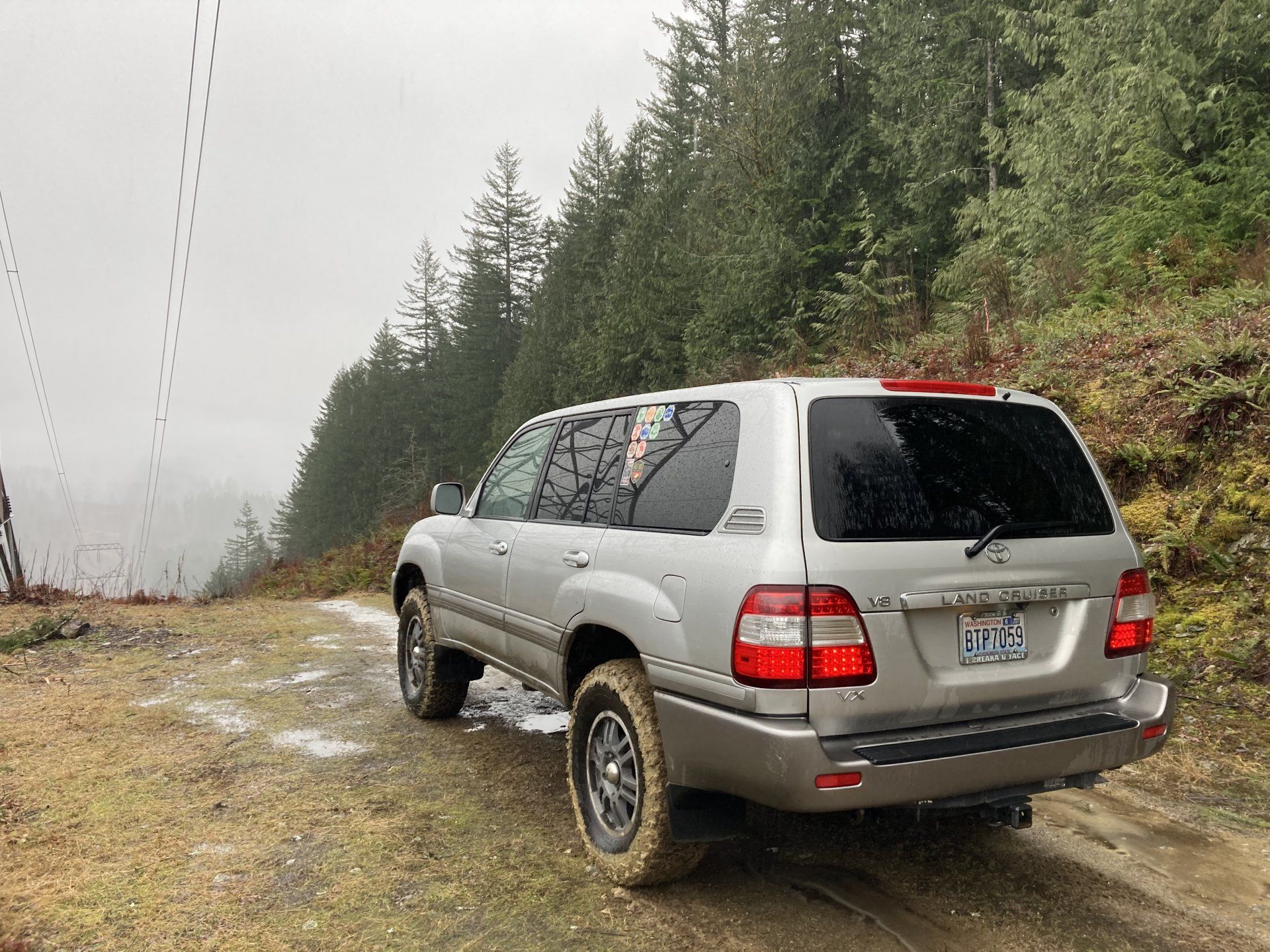

Got my Icons installed and everything is so much better! The sun came out and everything. The bad news is that before mounting these wheels my wife managed to hit a bump hard enough to push up the driver side fender—self clearancing instant fender flares I guess. Oh well, technically it’s her vehicle and the damage is cosmetic only.
