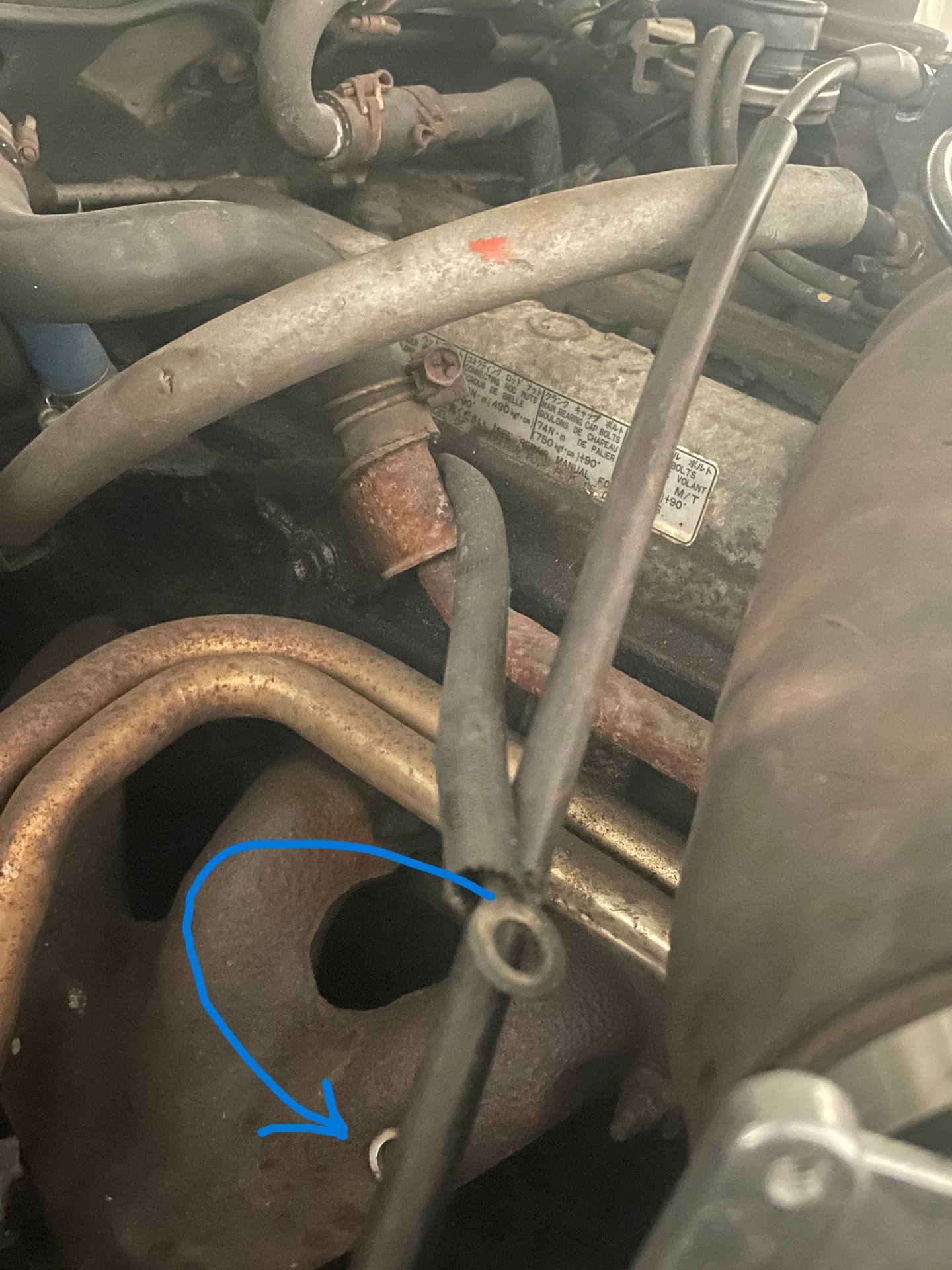

Hey there everyone. I have a 1994 LC and I was looking around my manifold when I saw this. Is this a ground? Im assuming it attaches to the manifold?
What is the purpose of this wire?
Am I correct about the placement?
I would appreciate the help!!

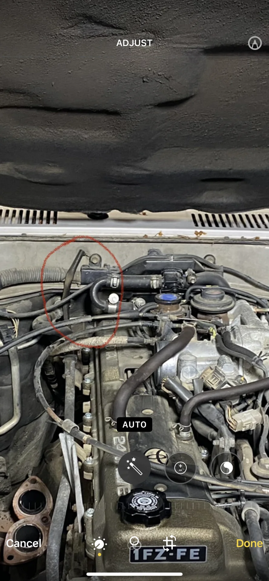

I think it supposed to go on the bulkhead where the main harness routes.

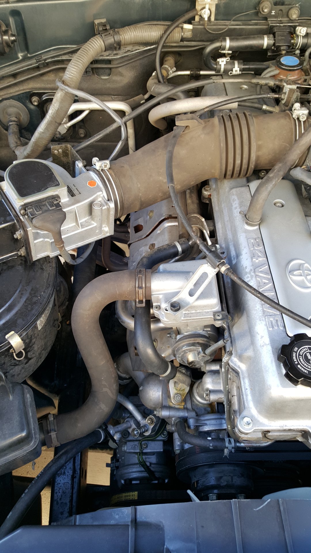

you can see it at the top center of this photo. Please note that cable should be in contact with the metal bulkhead and not on top of the plastic harness cover.
Yes it goes up to the bolt that holds the harness to the firewall. That hole you circled is where your heat shield bolts should be.
