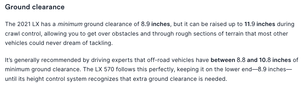

Thanks for the response. I was reading this article about the 2021 and it had the following regarding ground clearance that's why I was curious about the 2014.
