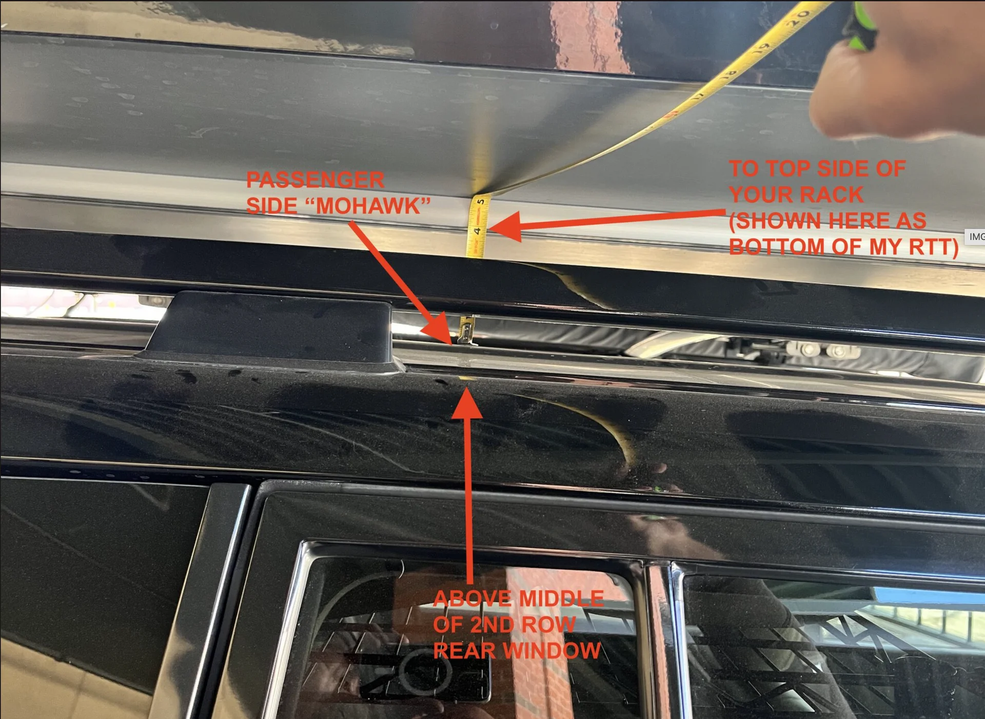

I'm needing to shave a couple inches off the height of my rig, to give me more garage parking options as my wife and I search for a new home. I know that I'm going to need to abandon the factory rails to achieve this. I want to keep my iKamper installed. I'm running OEM factory rails + thule feet + thule square bars. As measured from the raised roof 'mohawk' closest to the side of of the vehicle, and at the crest of the roof and mohawk approx. above the 2nd row rear window (see picture), I'm measuring 3 15/16" from the metal roof mohawk to the top of the thule square bar on my system.
Also, I have a bush company 270 deg. awning, and like most awning, it requires long cross bars that stick out well past the RTT. So whatever system I switch to will need long cross bars for this reason.
What's the same measurement on your roof rack setup (with crossbars) at that same point on the vehicle?

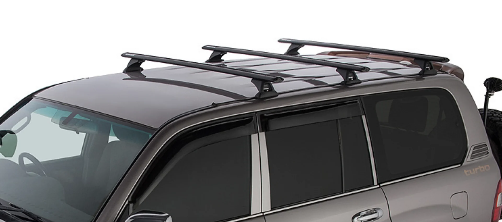

Yeah, it's definitely this type of system that I'm going to need, for the variable crossbar length. Rhino Rack's Heavy Duty Bars come in 44", 50", 54", 59", 65", 71", 79", 94". Looks like the Vortex bars might come in those same lengths. I could definitely assemble the entire system off the truck, and then if I ever need to pull it, undo the six feet. Looking at this photo attached, LC roof to the top of the crossbar doesn't look incredibly shorter than the 4" I'm at now. If anyone has measurements of this system, that would be amazing.
Does anyone else make this style of feet + crossbar system, other than Rhino Rack? Where the feet project up less? I've been looking, and haven't discovered any yet.

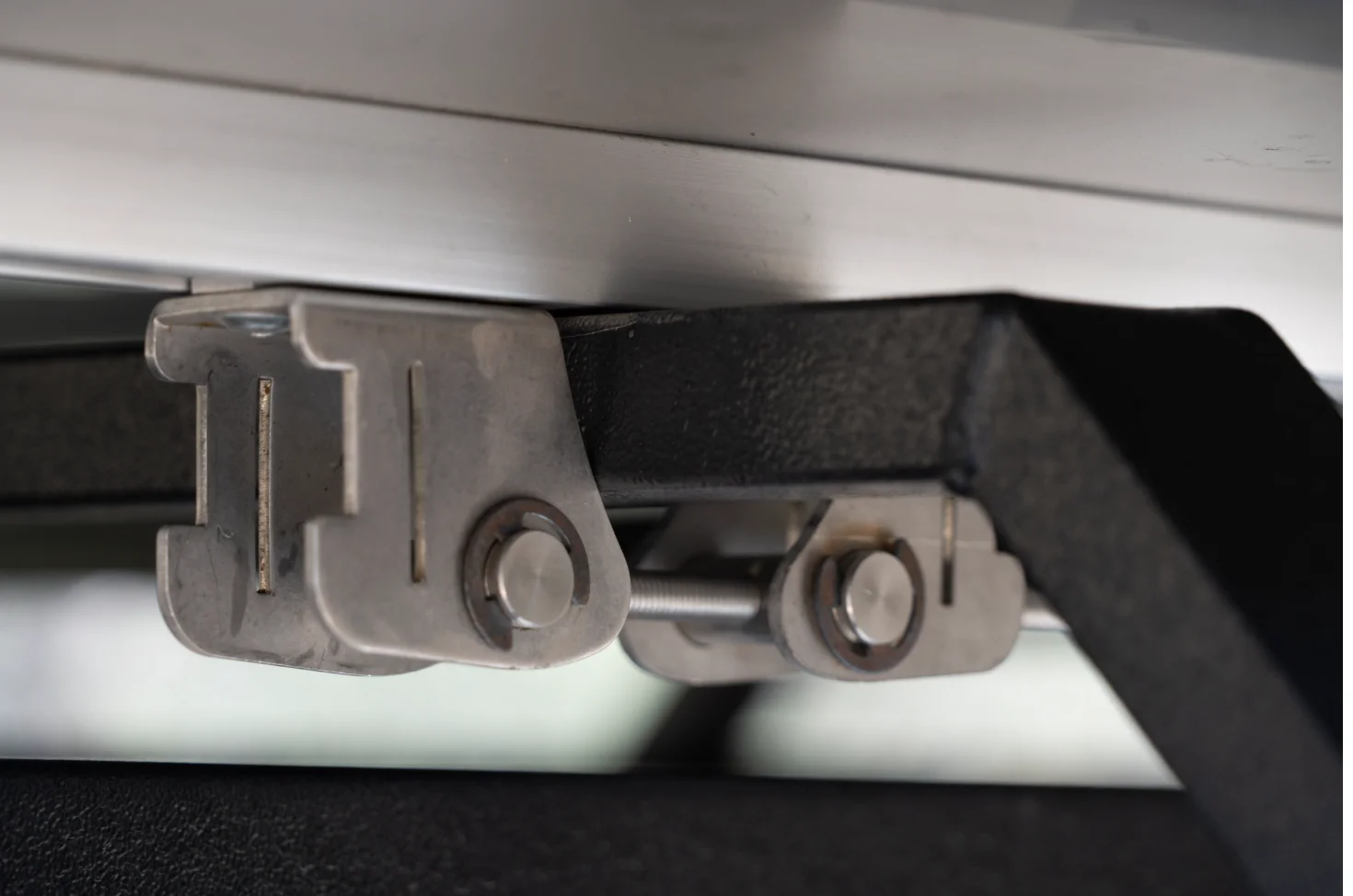

FYI - this is how the iKamper mounts - So I could lower my RTT approx. an additional 3" and not have these brackets hit my roof.

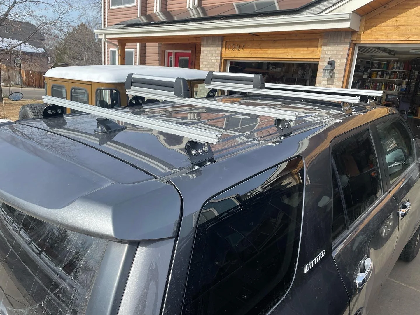

@porkandcorn hey thanks for the PM. So many options now.. if you want to run extrusion cross bars you could lay those essentially on top of your OEM rails, we have an angle bracket that makes that a bolt-up. If you want to replace all the OEM stuff and instead run our towers and 3 or 4 cross bars, either the Rhino heavy duty or some 80/20 extrusions, you can do that also. And of course a full host of rack options, happy to help you find a new solution here.
And yes thanks @jLB I'm literally up the street from you in Broomfield you're welcome to come see it all, just need to set up a time. :cheers:

Those are the older style feet that I don’t think they sell anymore. They are the same height as the RCH feet which is 15mm higher than the RCL’s. I have the RCL’s with the Vortex bars on that I can measure once I’m home in a few days.

Roughly 2.25-2.5" depending on where you measure. That's using a 1" tall extrusion. Setup would be similar to this one:
Those are 1" wide, you could also run the wider 1x2 or 1x3 extrusions, they'll all bolt up.. . wider is stiffer, your limiter is how wide your RTT attachment is.
