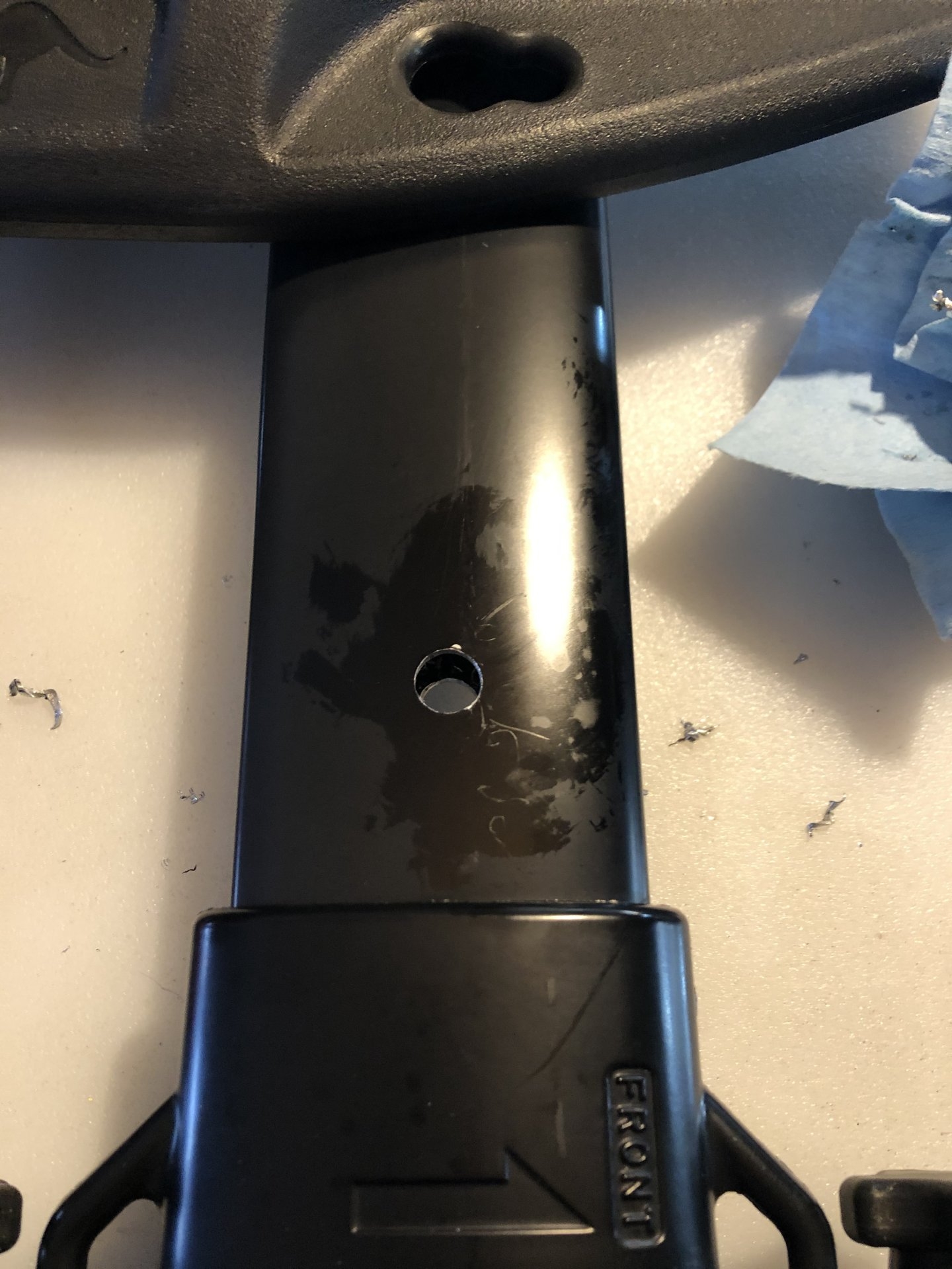

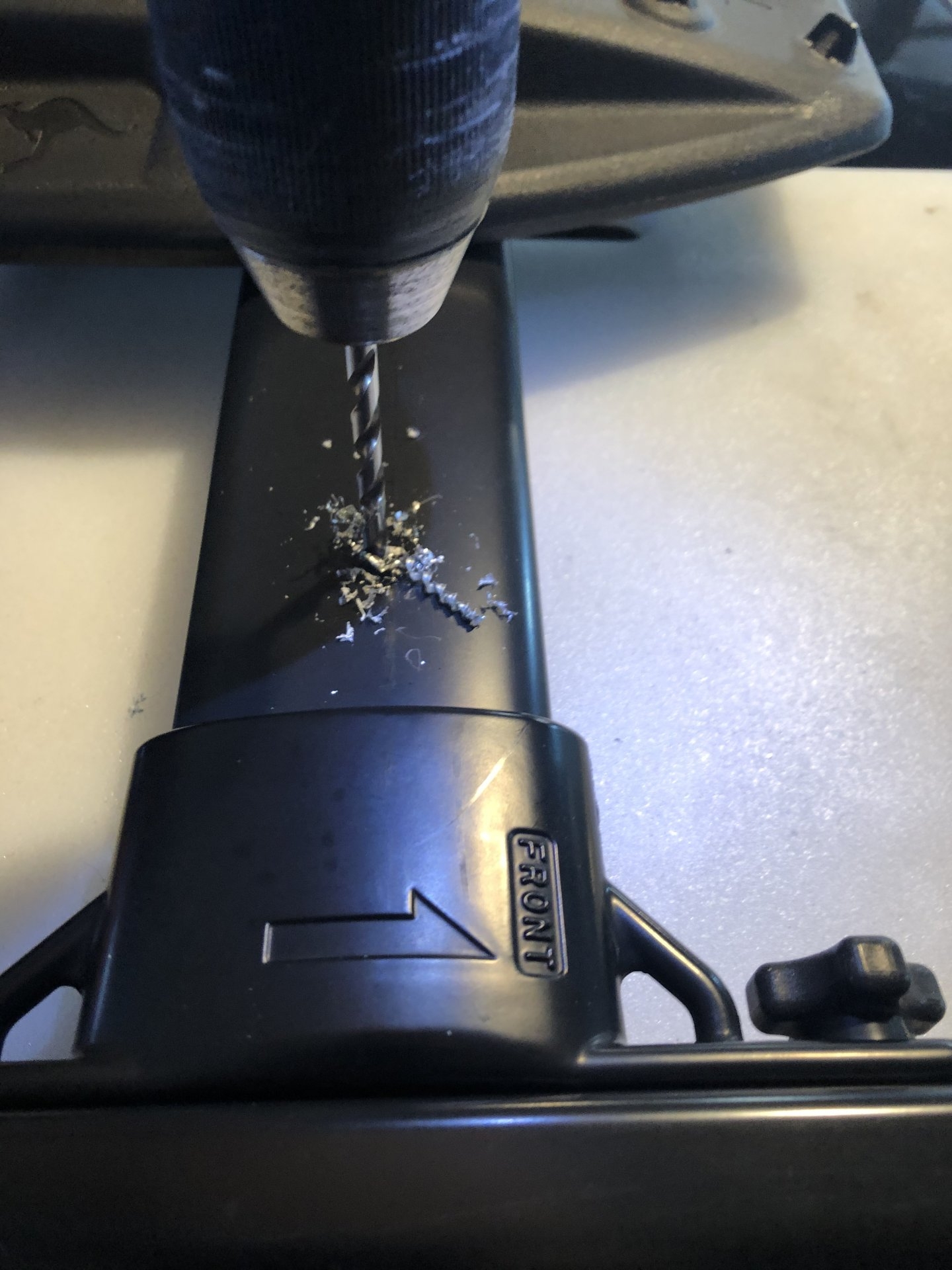

Drill into crossbars, use maxtrax pins.
There's no point in having them if you can't easily access them. The maxtrax pins are easy on, easy off, and secure mounts.
The holes don't significantly impact the crossbars, but if it concerns you, add a couple more. They are easy to add (I had 5x on my last 200, but haven't gotten around to installing them on this one yet).
They are super accessible in this position, mine have gotten good use.

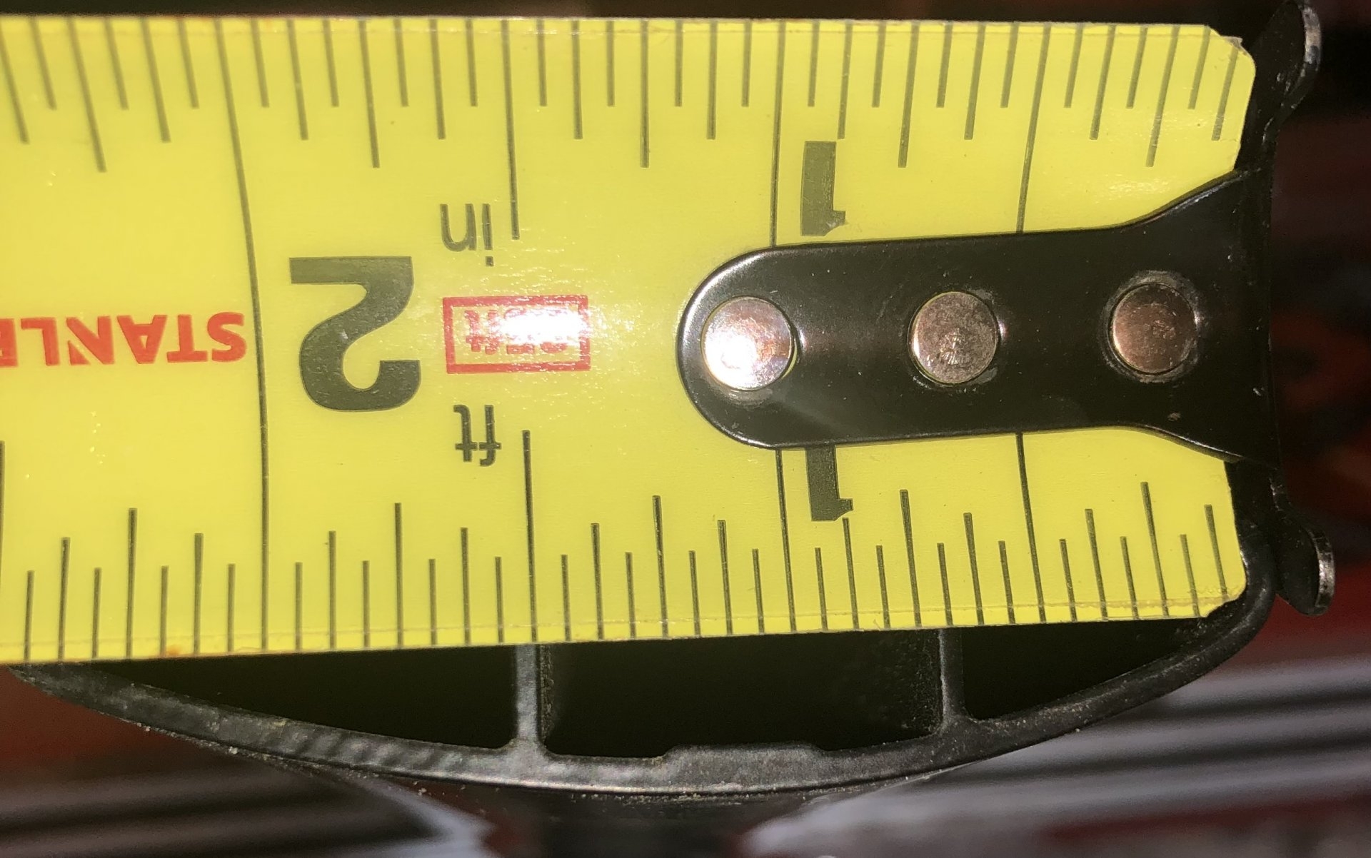

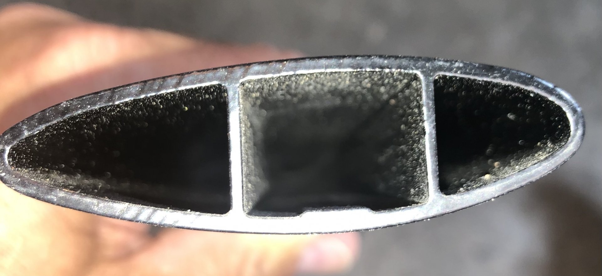

If you drill through the rail, you might want to take one off to look at the extrusion profile. Or look for a picture of it. It is hollow, but I know there is a vertical rib through it somewhere, but can't remember if it's off center or where exactly it is. I think you'd want to avoid drill through that rib. With that exception, i definitely agree that drilling through is cheapest functional solution (other than bungy cords).
Any idea where to get the cross section profile? TIA
I still have a rail in my shed. I can take a picture of it later after I get home. I noticed it when I was adapting a LX rail to fit on my new to me LC rails. 2 screws remove the end piece that slides into the roof rail. You can easily see the extrusion shape at that point.

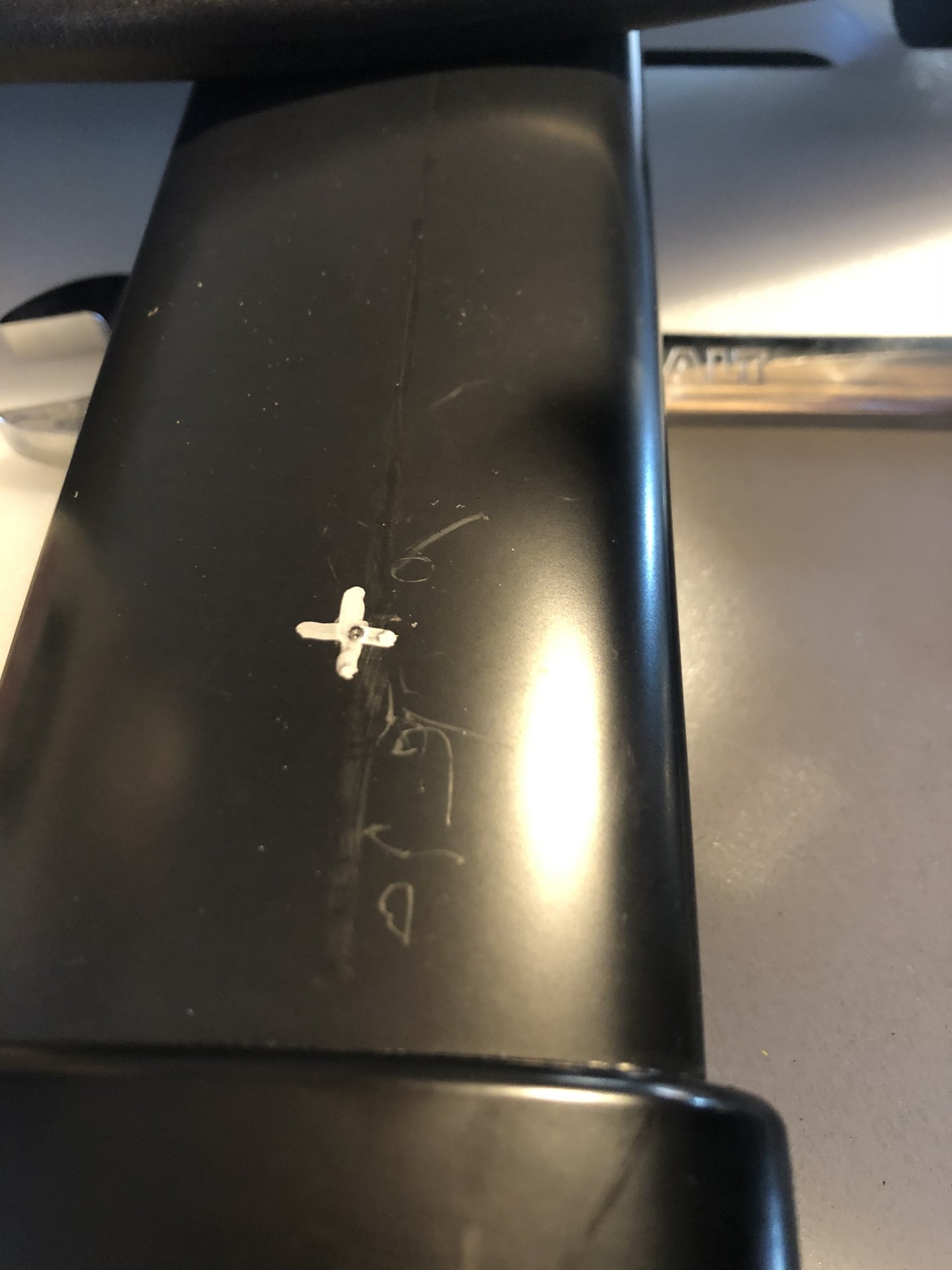

That would be great and potentially save me from embarrassing my self. Going to try just a hole on the top of crossmember with a rivnut.

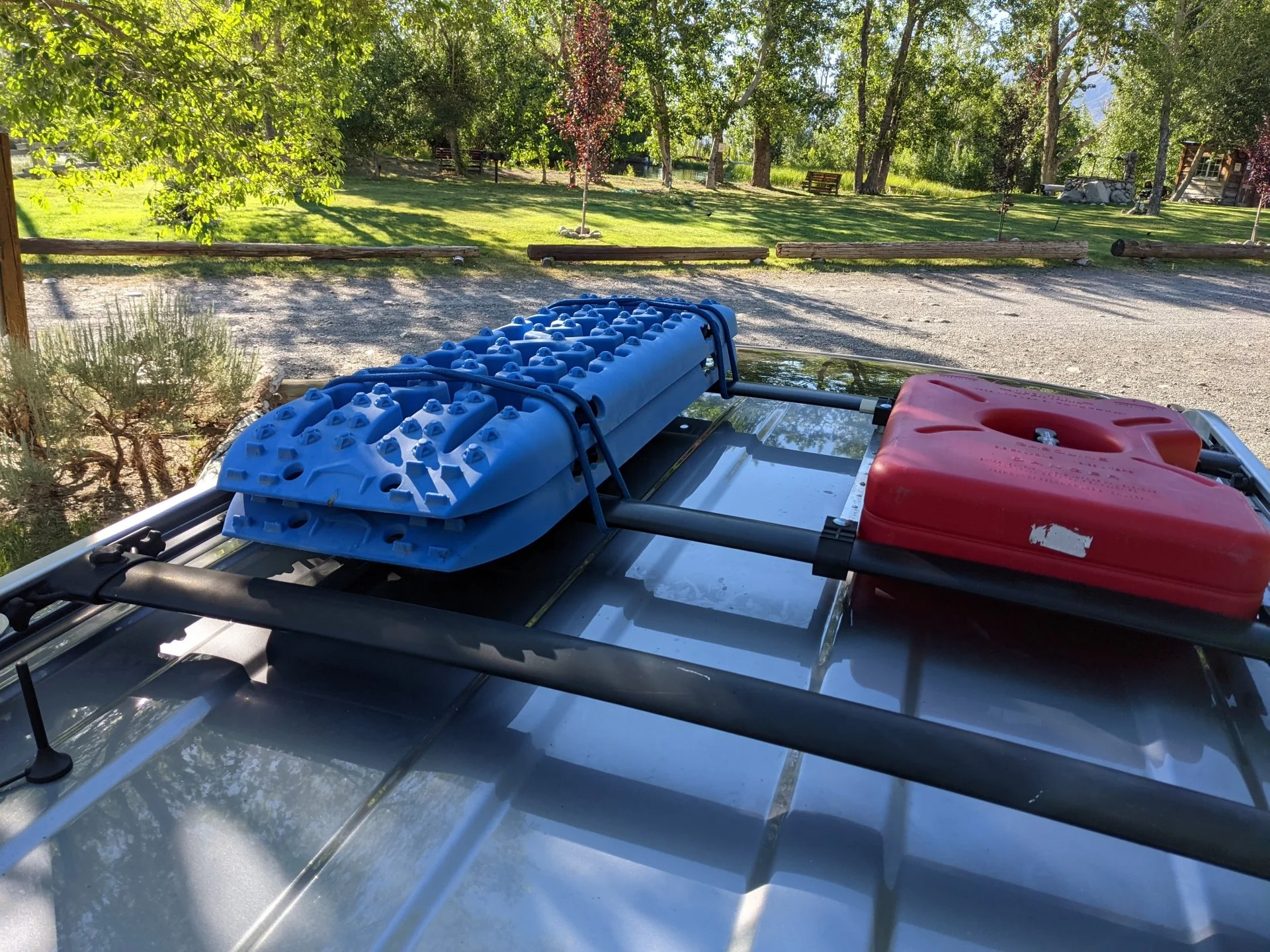

I purchased the maxtrax pins when I bought my boards. I didn't realize they don't offer a 2 board pin height. They add a lot of additional height when only running two boards. Debating the switch to a bungee/strap solution instead.
I purchased the maxtrax pins when I bought my boards. I didn't realize they don't offer a 2 board pin height. They add a lot of additional height when only running two boards. Debating the switch to a bungee/strap solution instead.View attachment 2723612
Couldn't you disassemble them and put them back togeter with a shorter bolt (or cut down the bolt) leaving off one of the segments? Or carry 4 maxtrax...they come in very handy.
I like that style, I can use that as a temp setup. How is your rotopax mounted on there? What is the antenna for?
Fuelpax on a DIY carrier with fuelpax retention mechanism
Antenna is a Weboost Reach cellular booster magnetic antenna
