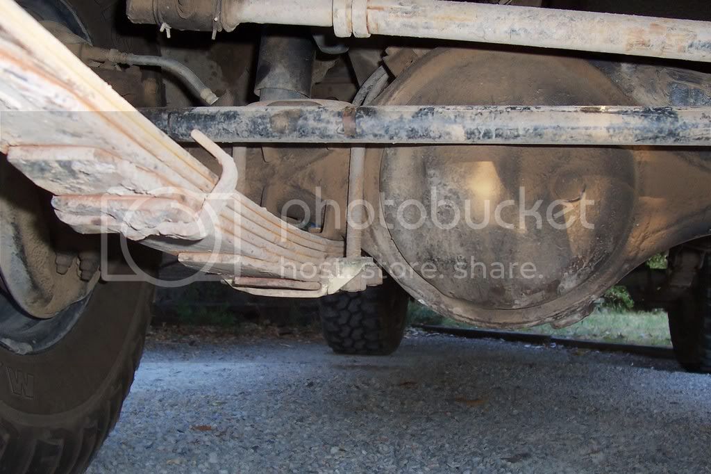

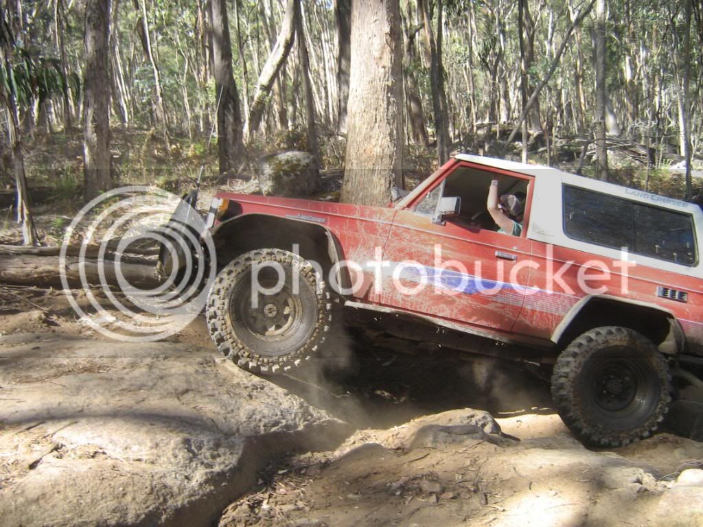

Hey Gib,
I've made a few changes since those photos were taken.
-Diff forward another 25mm
-Front tailshaft flipped
-25mm front spacer
-Front springs removed one leaf
-Front hanger relocated forward 20mm
-Flat U bolt plates
-New Toyota stock 80 series rear shocks, same length as my old stock front shocks
Below are some photos, if I had shocks that were longer I could achieve more droop.
Tonight i'm picking up some hi flex EFS springs for the rear.

Thanks mate, those shock lengths previously posted dont stand anymore. The flat U bolt plates have raised the lower shock mount ~25mm. Compressed length now is very short!!
Even if I had longer shocks I couldnt get more droop as the opposing tyre is hitting the guard. Maybe if I extend the front bump stops it could pivot more. Or a body lift.
