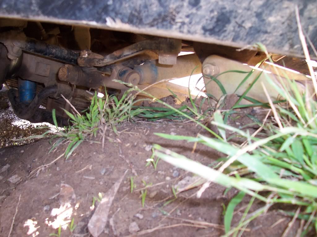

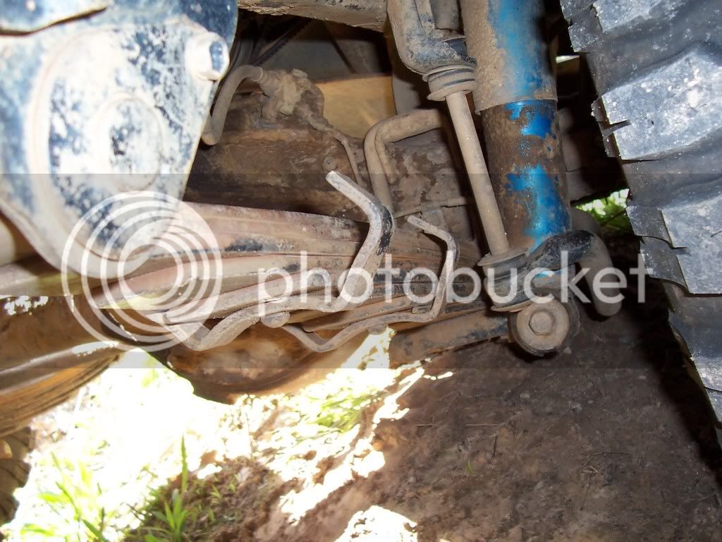

On my RHD FJ73 I have done a RUF, today I took out the shock absorber and the swaybar link to see how much flex I can get, I got a fair bit I think for a SUA setup. In the pics the front wheel is just off the ground while the opposing side is hard on the bumpstop. Question is, looking at the shackle I could probably get more flex but the tyre didnt want to do down anymore and I dont know why? The brake lines, driveshaft etc are on the compressed side so wont affect drop. All I could think of was that I have maxed out the steering links ? Any help appreciated.

To be honest they dont look too bad to me. Any more flex and they would rub.
Your next step is a SOA if want more.
IMO leave it as it is and concentrate on getting lockers
I think I will leave it, shocks probably only cost about 300, all other options will be more. From what I have found out its probably the bushes limiting me. Whats best to run rubber or plastic style ones? currently got plastic style ones. As for rubbing, the 33'' JUST clear with the guards chopped 50mm on the front with the inner guard raised. My 35'' will rub though, might need to get the mash hammer out.
