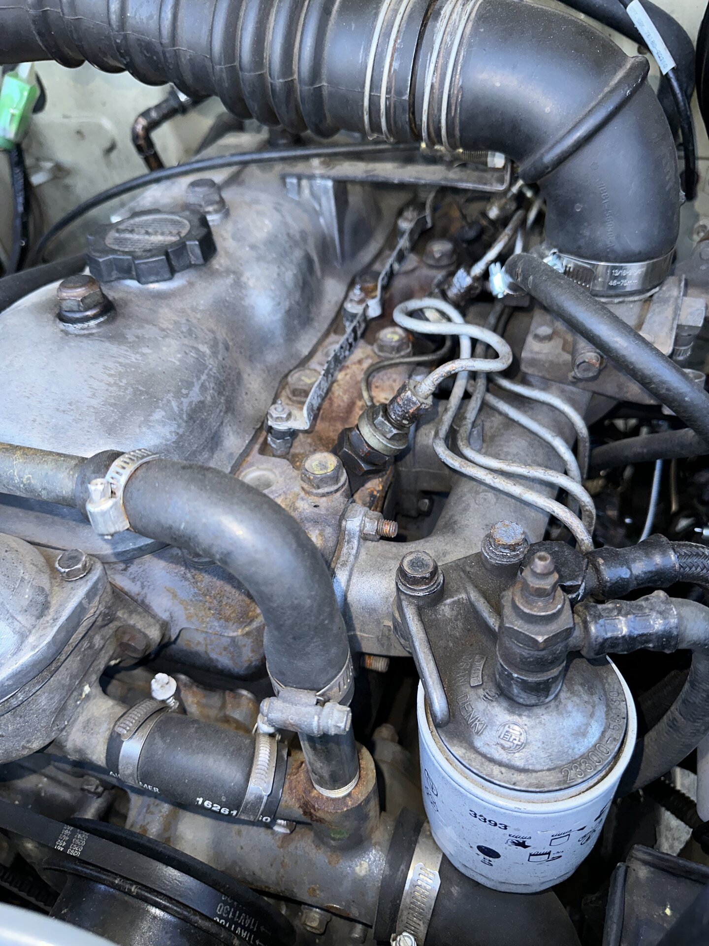

Gives us some pics specifically the injection side of the motor I think the 70 is a direct injection fuel system

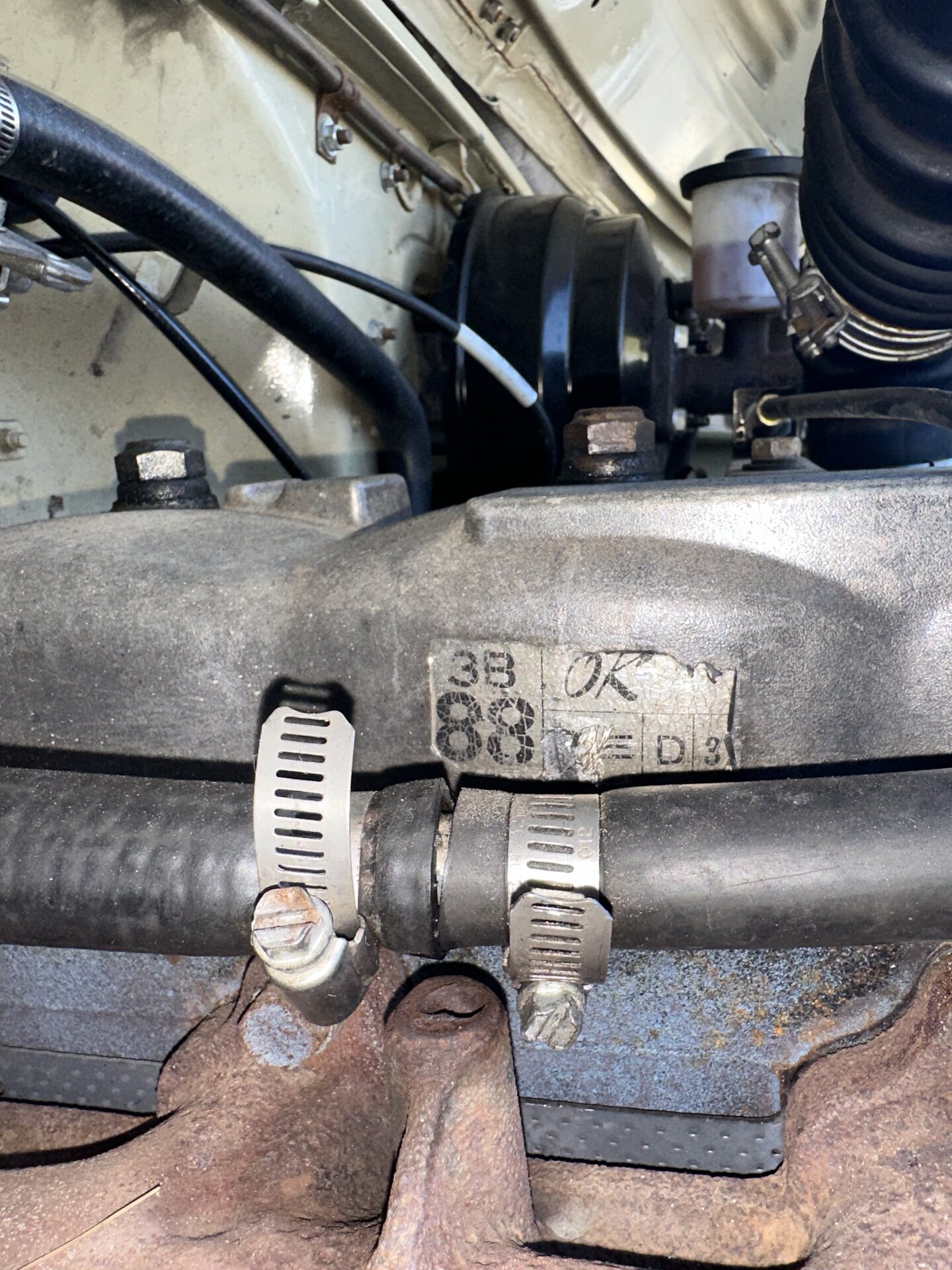

I haven't been able to find a reference for engine serial numbers (they are stamped on the horizontal , flat machined surface of the top deck of the block, just look straight down between the first two inlet manifold pipes (right below #1cyl injector))(you may need to use some steel wool and needle nose pliers to clean the rust off so you can read it...).
However, the block part number is cast midway down the block on the same side, pretty much right behind the fuel pump diaphram body. It's easy to spot. As far as I know, the early 3B's had 11400-58010or 11400-58011 between 10-81 and 09-82, those made between 10-82 and 8-84(or 09-84) had 11400-58012 cast in. These were 3 bearing camshaft models. From 09-84 to 09-85 the number was 11411-58040 and the camshaft had 5 bearings. These engines all had inline fuel pumps.

Ok, explain this one. The number cast into my engine is 11411-58030. Any idea?
Hmmm, sorry, I'm assuming it's 11400-58030 (I had typos in my post, too many ones and not enough zeros) as 11400 is the block group major p/n, but 58030... I just ran through almost all the B, 2B and 3B engined vehicles on TOYODIY and no luck, all the 3B's seem to be the (...-580...)10, 11, 12 or 40. Maybe Toyota can help.... it does have 3B cast in the block (same side, just on the other side of the casting plug to the right of the block casting number????

Can anyone help me discern whether my 3B is pre or post 1985?
