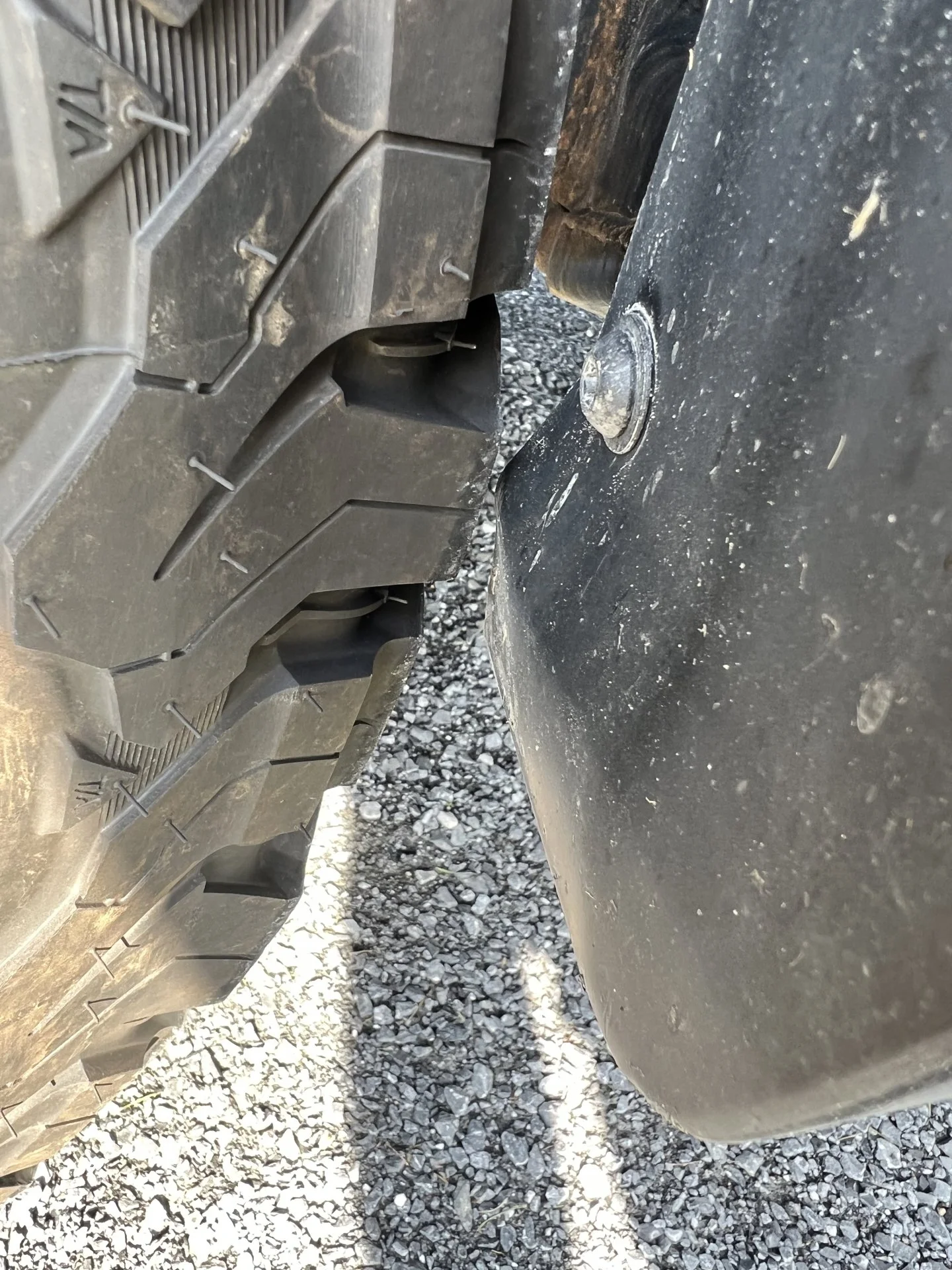

I put 34s on and am getting a tiny amount of rub, I think at the back of the front wheel well, but only when turning while driving, and only briefly.
My mud flaps are long gone, and I have tons of space with my TJM bumper.
I think I just need to take off a little bit of plastic to gain clearance. I'm not sure what tool to use on this thicker material.
This is a static photo of the area with the wheel turned to its closest point.
I'm looking to trim at the red line:

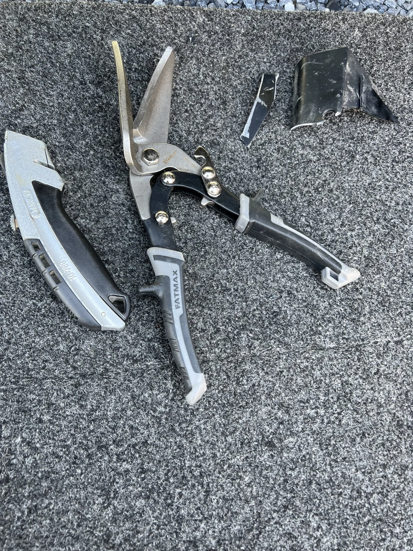

If you have tin snips, those do a great job too especially when you're trying to cut small bits off
Thank you everyone!

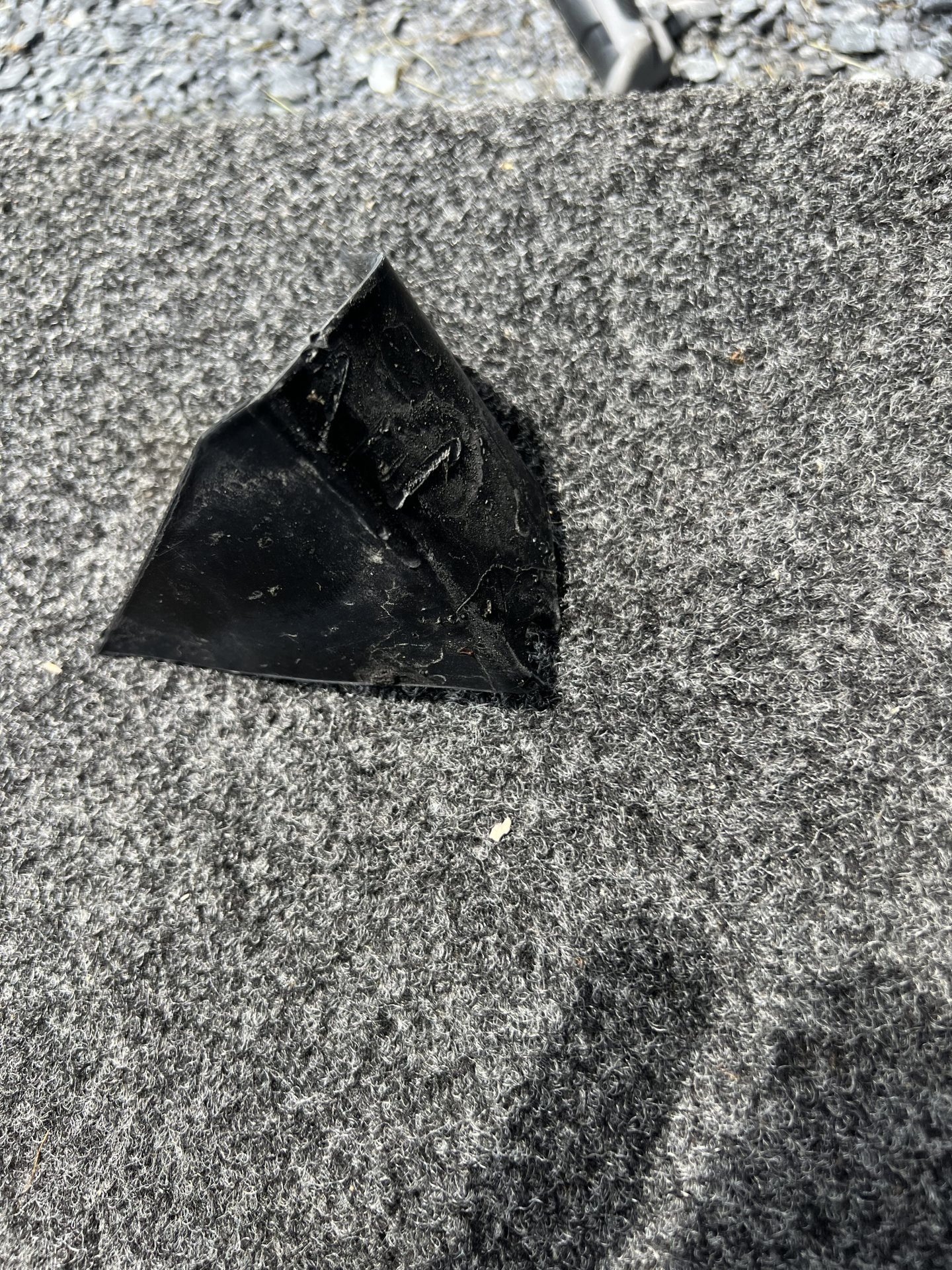

I couldn't find my oscillating tool, so I thought I'd the some tin snips. it worked great! Trimmed a rough corner with a sheetrock knife.
The plastic was a lot thinner and mor pliable than I expected it to be.
