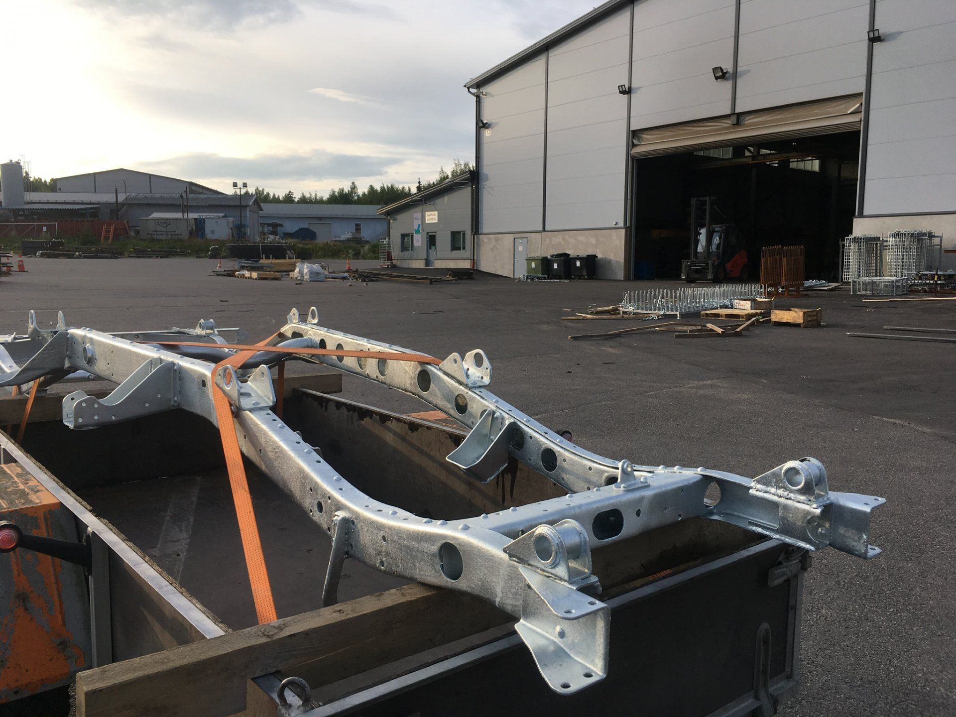

*If $$ was no object and I had as much time as I'd like to work on my 40....I'd have the frame galvanized. (two big "ifs")

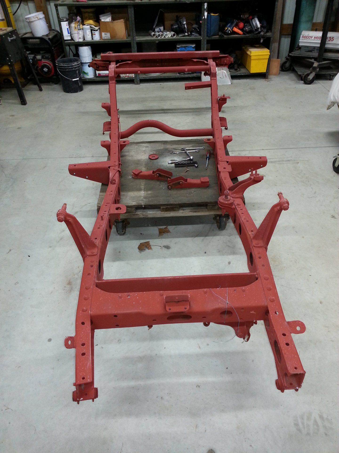

*Fourth choice...(what I did) - after blasting I had the blaster immediately paint with red oxide primer. It sat in my pole barn shop for a couple years like that until I was able to swap it for the bent frame on my '77. It held-up well in a very humid environment. As I've done the frame swap ,(and cut off all the V8 stuff from the straight frame), I've used a combination of Spray Max two-part, spray bomb epoxy, rustoleum spray bomb semi flat black, and rustoleum brush-on tractor paint. (Well, the tractor paint isn't technically being used on the frame. I've used it on axles, springs, backing plates, trans, and bell housing. But I wouldn't hesitate using it on the frame.) I use the rustoleum semi-flat spray can over the epoxy because it's super easy to touch up. (I'm not restoring the 40....Just a "refreshing" that is taking way too long. I don't want to worry about scratching/scraping it up on trails.)

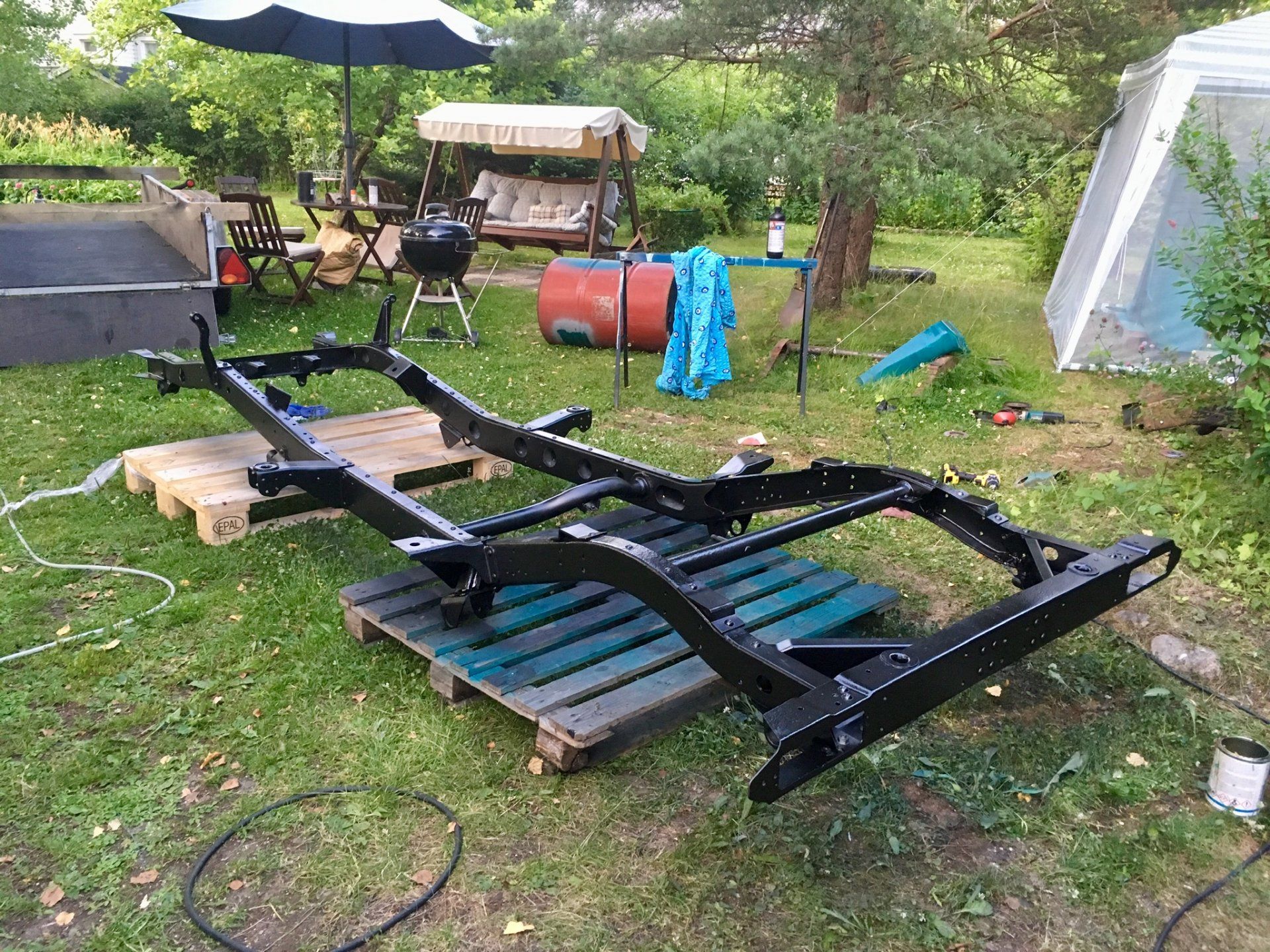

I would do the flowing:
Solvent wash
Blast to near white metal
Epoxy prime
Acrylic Urethane topcoat
Follow the recommended surface prep and other guidance in the tech sheets for the products you’re using. Don’t listen to some guy on the internet who says 10 coats is better than 2.
If not on budget:
If you sandblast the best is 2K Epoxy primer. Period. It is the most dense of all primers. No primer is completely dense, but epoxy is by far the best. To rust, oxygen is needed from the air, so you have to shut the air out.
On top of that some 2K polyurethane. Not that important, bud need to be tough to protect the Epoxy which is what actually prevents rust.

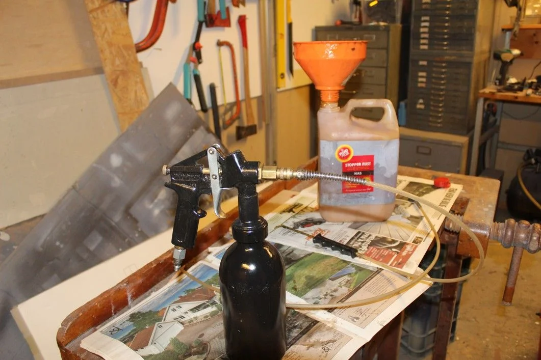

Short and brutal answer: No paint will help in the long run. You must use a good rust-inhibitor, like Fluid Film to stop air and water penetrating.
I have a writeup on painting and rust protection here: Paint and rust protection
On Fluid Film here: Fluid Film

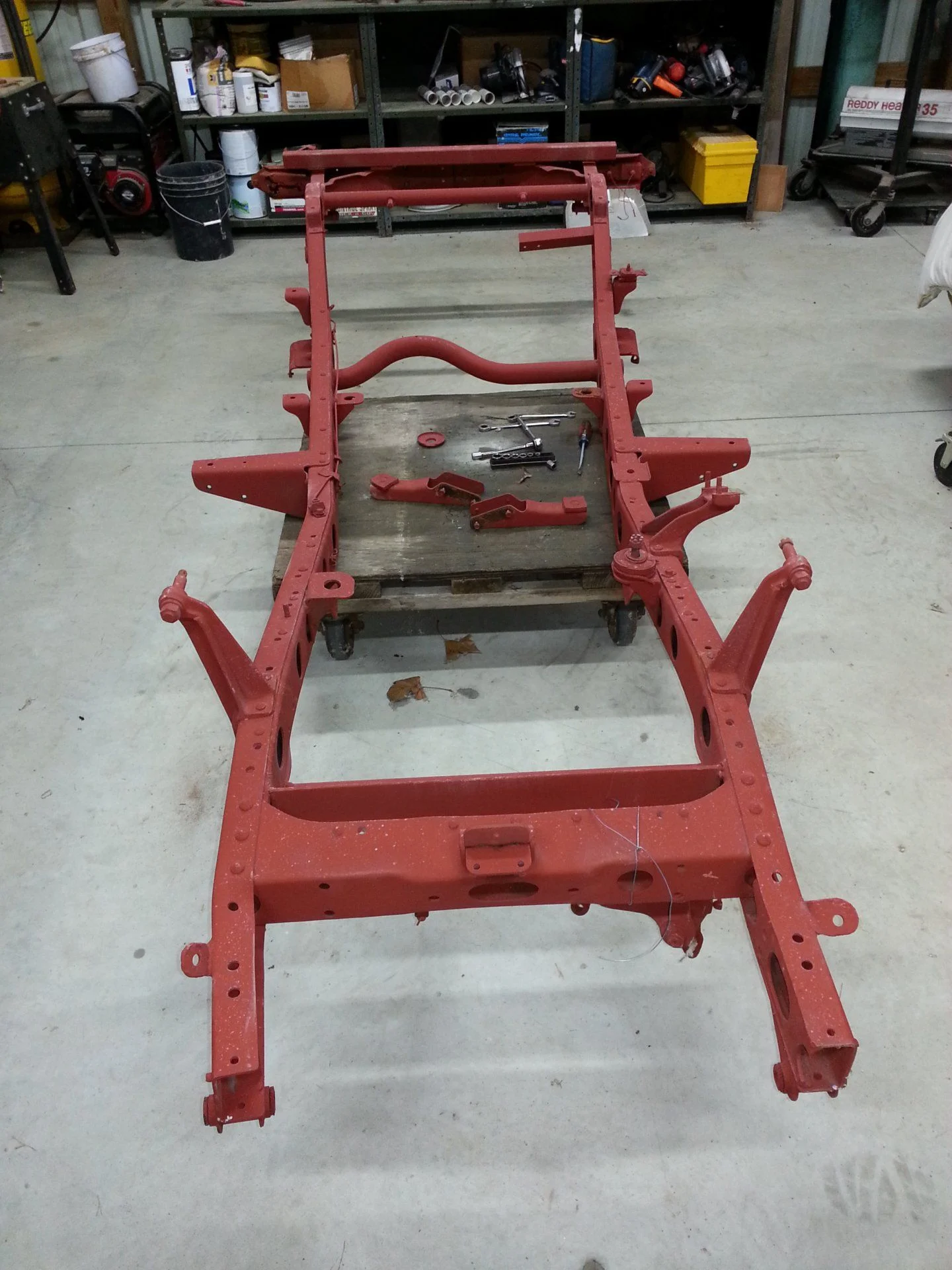

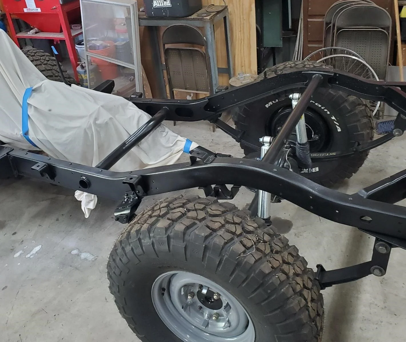

I have used a kit from KBS Coatings a few times on a few projects including my 42. It includes a prep kit and paint. 5 years on in Canada’s salty north east, no problems. Very economical and easy to work with.
