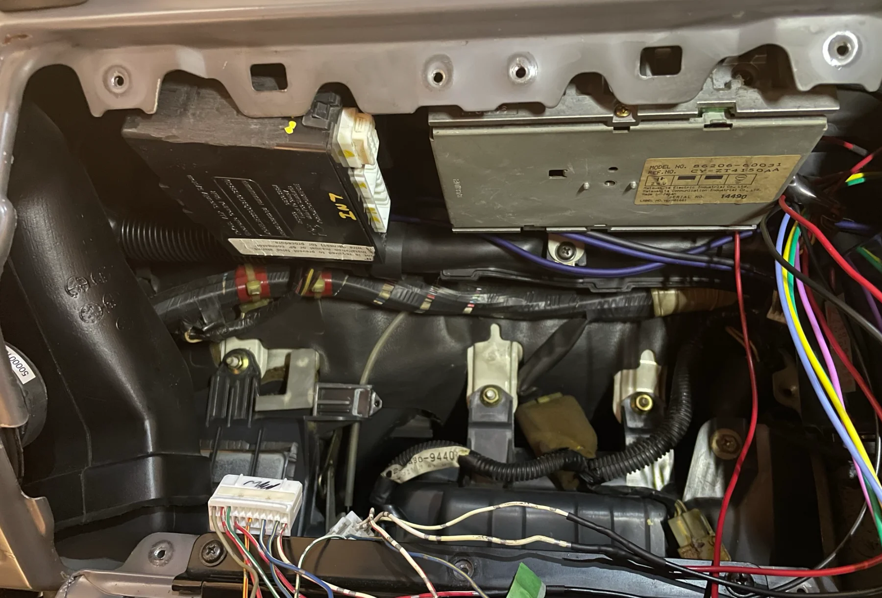

The JDM models come standard with a 24 to 12 step down converter ? I have found several different brands and models in the Euro spec 7x models but nothing oem or even dealer installed accessory

The PO installed a $25 24v crappy Amazon stereo. Which also has a non functioning memory… any pics of that inverter? Doesn’t look like mine has one. Or maybe it was pulled out?
That's a great question. My 1992 HZJ77 came with a converter behind the glovebox. Part number: 86206-60031 which does look like a Japanese market standard.
Here's a picture of the converter behind the glovebox on the RH side.
