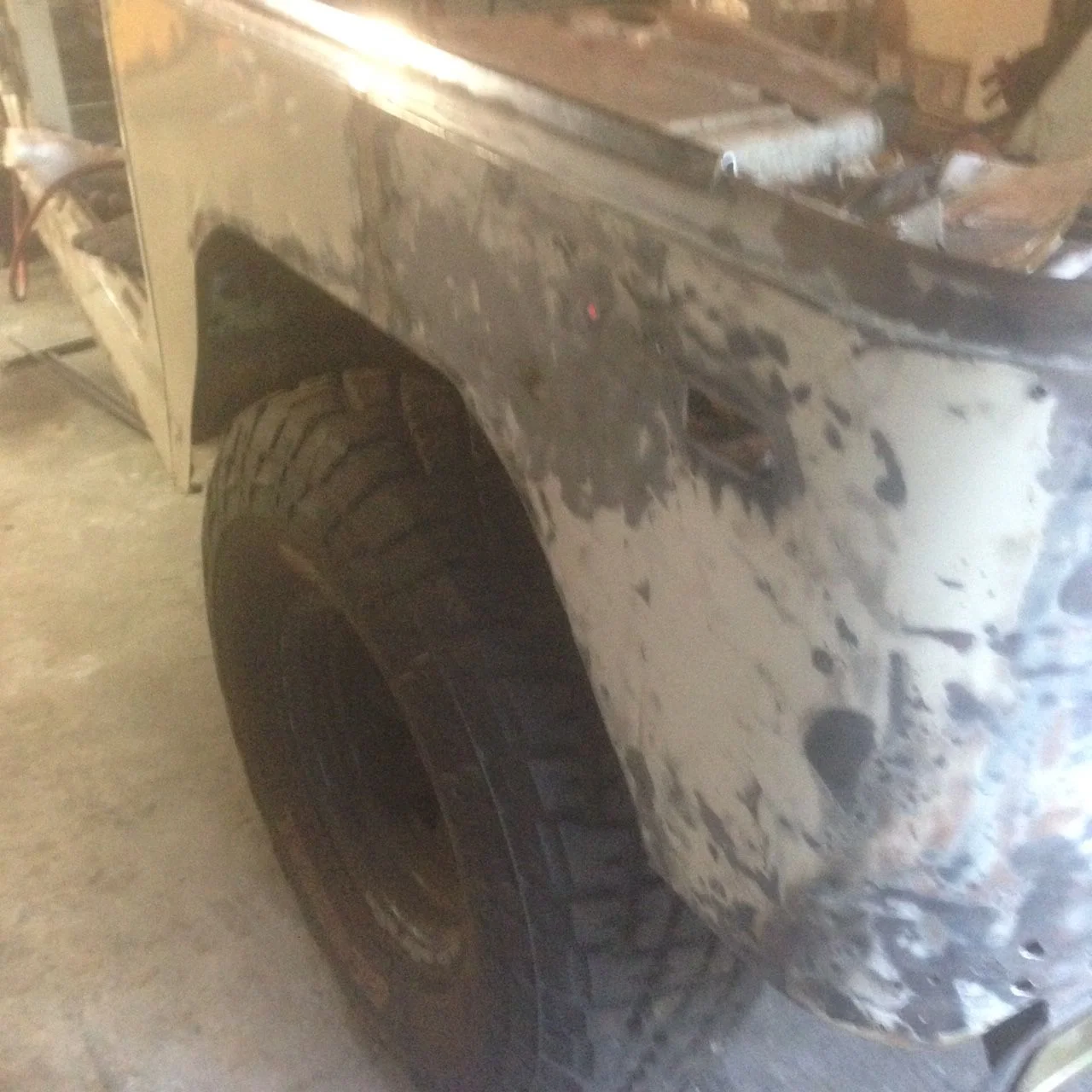

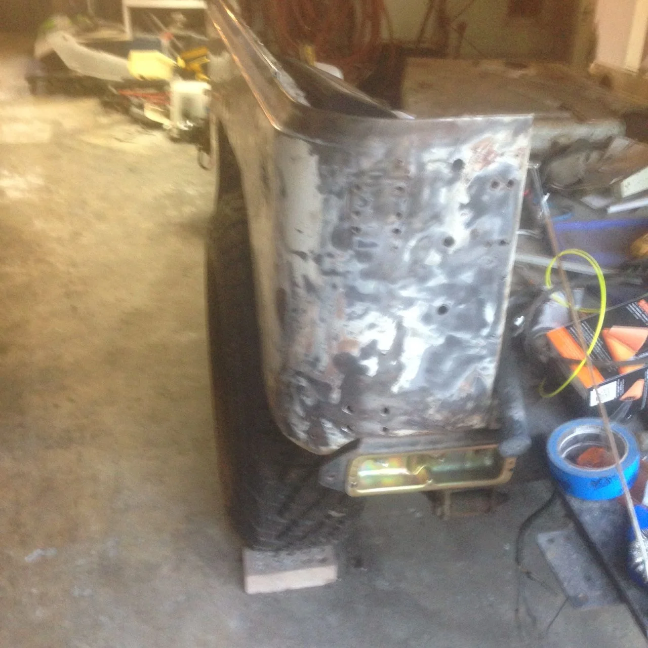

So began the dismantling: First the rusted front fenders fenders (Which are now less rusted thanks to some hackjob Cut/Mig work on my part) were pulled, cool, deal with later. Then the rest of the front end was taken apart with only like 3 broken/ stripped nuts. Pulled the heater to rebuild with the Metric TLC Kit. I wanted to get everything straightened up and working right and install the heater John Embrey gave to me awhile ago. Slippery Slope. Pulled thew radiator and drained that.

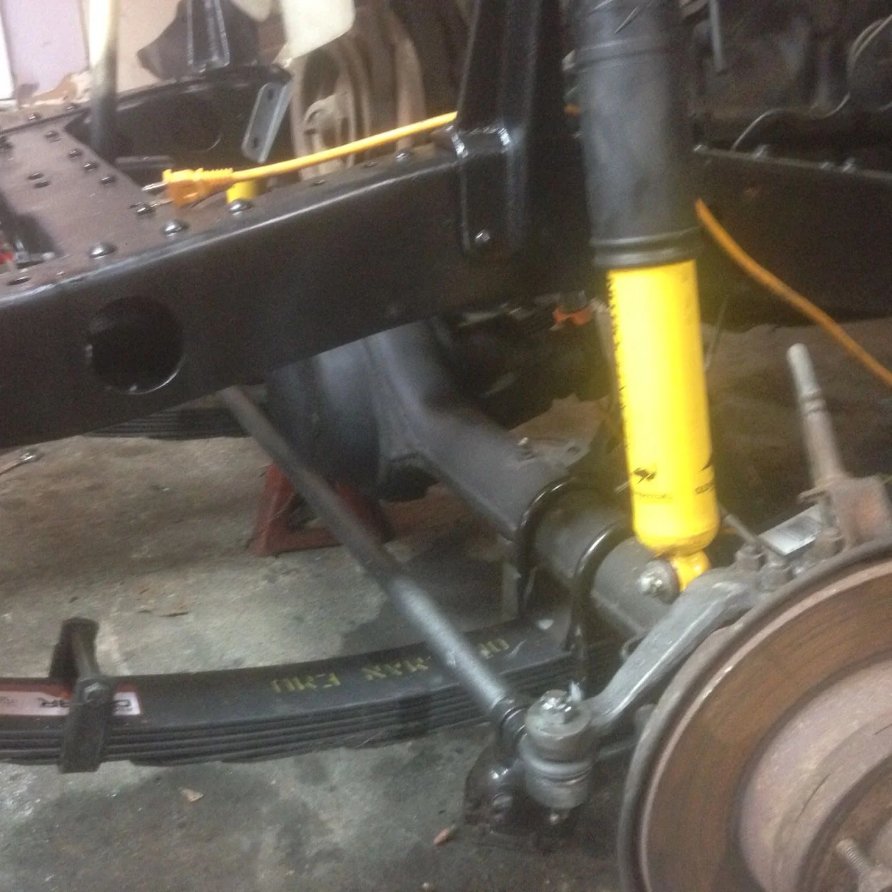

Steering box needed new seals and despite my willingness to do anything I figured I should let a pro do it. Several months (I am slow) months later I got the carb and steering box sent out to Jim C. for rebuild. In that time I pulled the front axle, blew some hard earned money on an OME 2.5" kit from Kurt at Cruiser Outfitters and pulled the front axle to strip and put new pinion seal and then repaint. Because I cannot just leave a rusty beat looking axle sit on top of my fresh springs. New U bolt Skid Plates (Originals were toast fropm being banged on rocks, had to grind off the old U bolts). When pulling the hard lines from the front Axle I broke one of the lines and decided I should just put on all new stainless hard lines while I was there. I am still waiting on them to send me the lines.

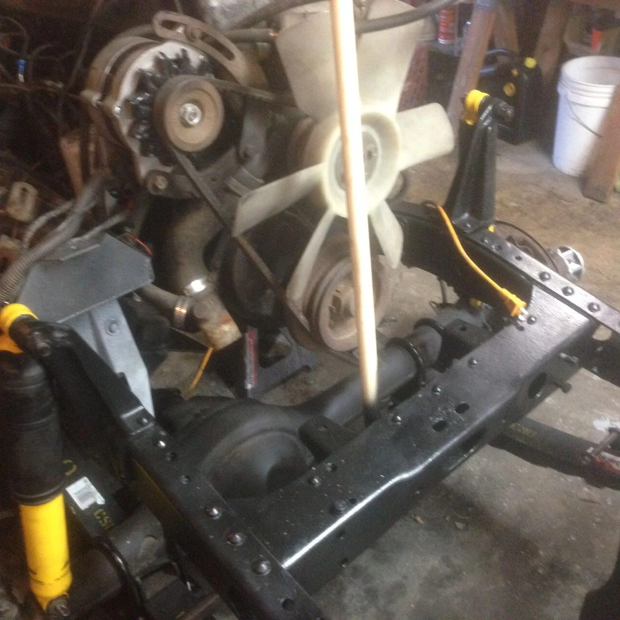

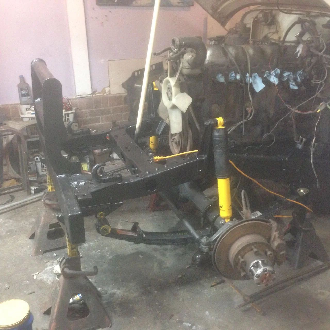

Status of FJ40 Front Axle is all set, new springs, shocks, shackles, pins. Entire front 2/3 of frame have been ground down to bare metal, hit with phosphoric acid, then 2 coats of Eastwood Rust Encapsulator, then Rustoleum topcoat. Every part that has come off rusty was prepped, primed, and rattlecanned prior to installing with new hardware and anti-seize (Well ones that I can Anti-seize). Fuel tank and all interior pulled. Gas Tank is in good condition and interior needs some small welds and then paint and put back together. Have new Poly body mounts that I need to pull out an impact and install. My dumbass cross threaded one of the shackles on install and need to get a new one from Kurt. Need Torque everything down, put on new brakes and move the efforts to the rear (Or I need more Jackstands). My buddy is supposed to fab and install a new rear sil for me but need to take it to his shop and currently is not driving.
I still have the engine compartment and steering to deal with; I have redone all TRE's and Tie rods (see my awesome rattle can job), need to rebuild Center Arm (Have kit, am lazy), and whenever Jim C. (Has the Carb as well, he has had them for about 5 months so I hope it might be close) gets the box back to me have it buttoned up. I am hoping for minimal mechanical issues by covering all my bases beforehand. But I am a rookie.

I should have had the courage to pull off the diamond plate off long ago; the metal doesn't look too bad at all.
