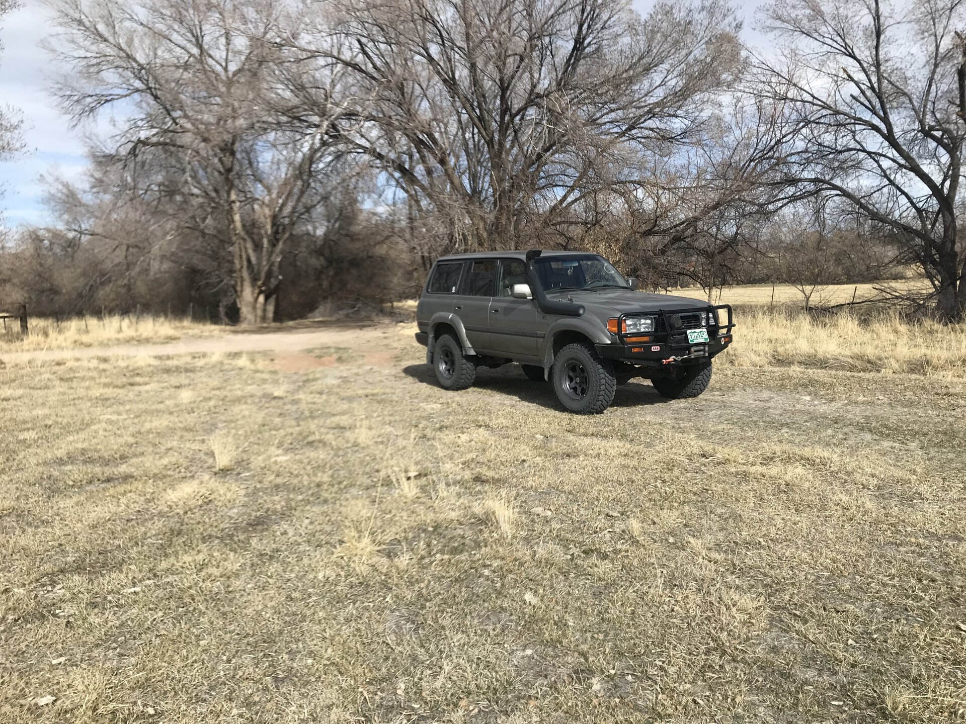

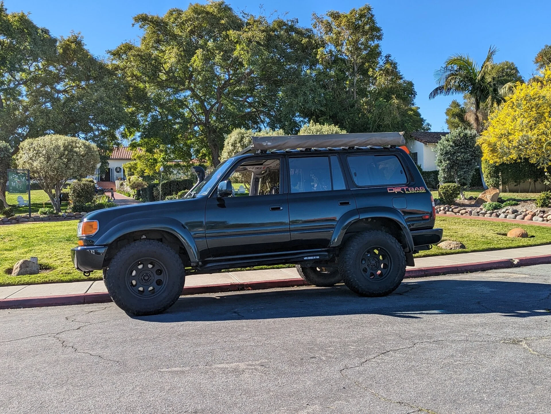

I ran 37s on a slee 4” front and OME “j” spring 15 years ago with flares. Went back to 35s for a long while but installed 75mm slinky’s and went back to 37s now flareless a year or two ago. Probably rub more now than before because of the extra flex. Build weight has remained about the same. The rear may have added 100#
I rub the rear frame rail most. No real contact in front. But a lot of that has to do with 5.5” backspaced wheels. Bump drops and wheel BS will help you fine tune the areas of concern
