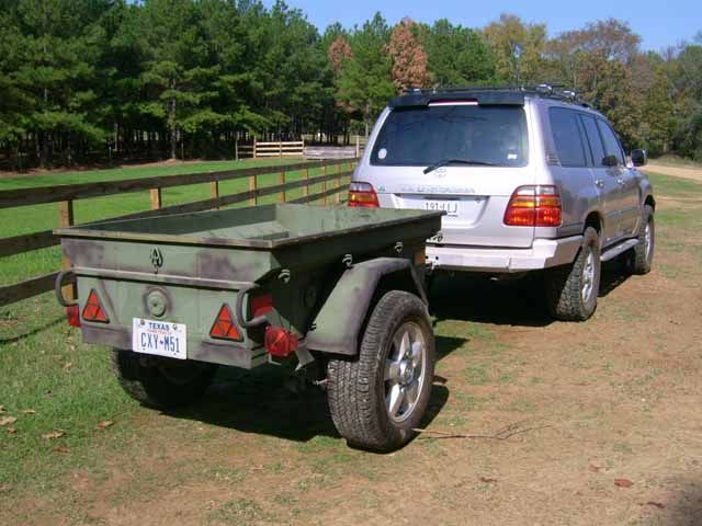

I have 1" spacers on the front of my Cruiser along with wider tires. You need to look into the 33 x 13.50 x 18 Terra Grapplers if you want a wider tire/look.
I got my spacers (not adapters) at performancewheels.com. They were $85 each.
This is the only picture I have on this computer of the width of my tires to the body.
I have the OME lift, but Christo Slee ran these tires without lift for a while and they worked.
1" spacers up front on mine too; Slee Offroad was my source.
