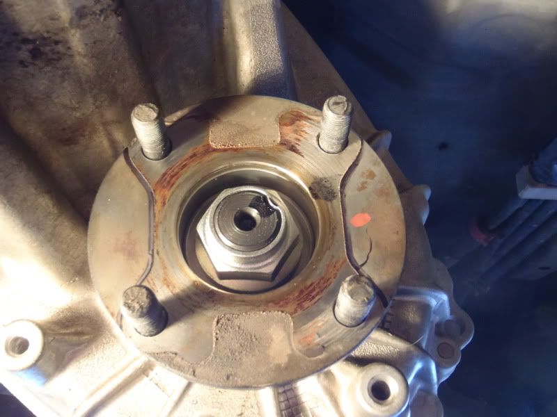

What size is the stakenut in an FJ62 rear transfercase seal
Nov 13, 2012
11
155
Under down under
confirmed as a 32mm for 1989 FJ62.
being a bloody pain to get off - especially while on the ground and no leverage.
32 use an air impact gun.
Done.
Georg @ Valley Hybrids
Thanks George, tried impact gun, no good as it seems at some stage the Po or a mechanic reused the stakeout multiple times so was crimped in a few areas. In the end resorted to punching the bolt to bits luckily no damage to thread.
4ft cheater bar with a 2ft breaker bar finally got the bugger off.
Now just have to get old seal off, new seal in and oil top up and bolt drive shaft back on.
