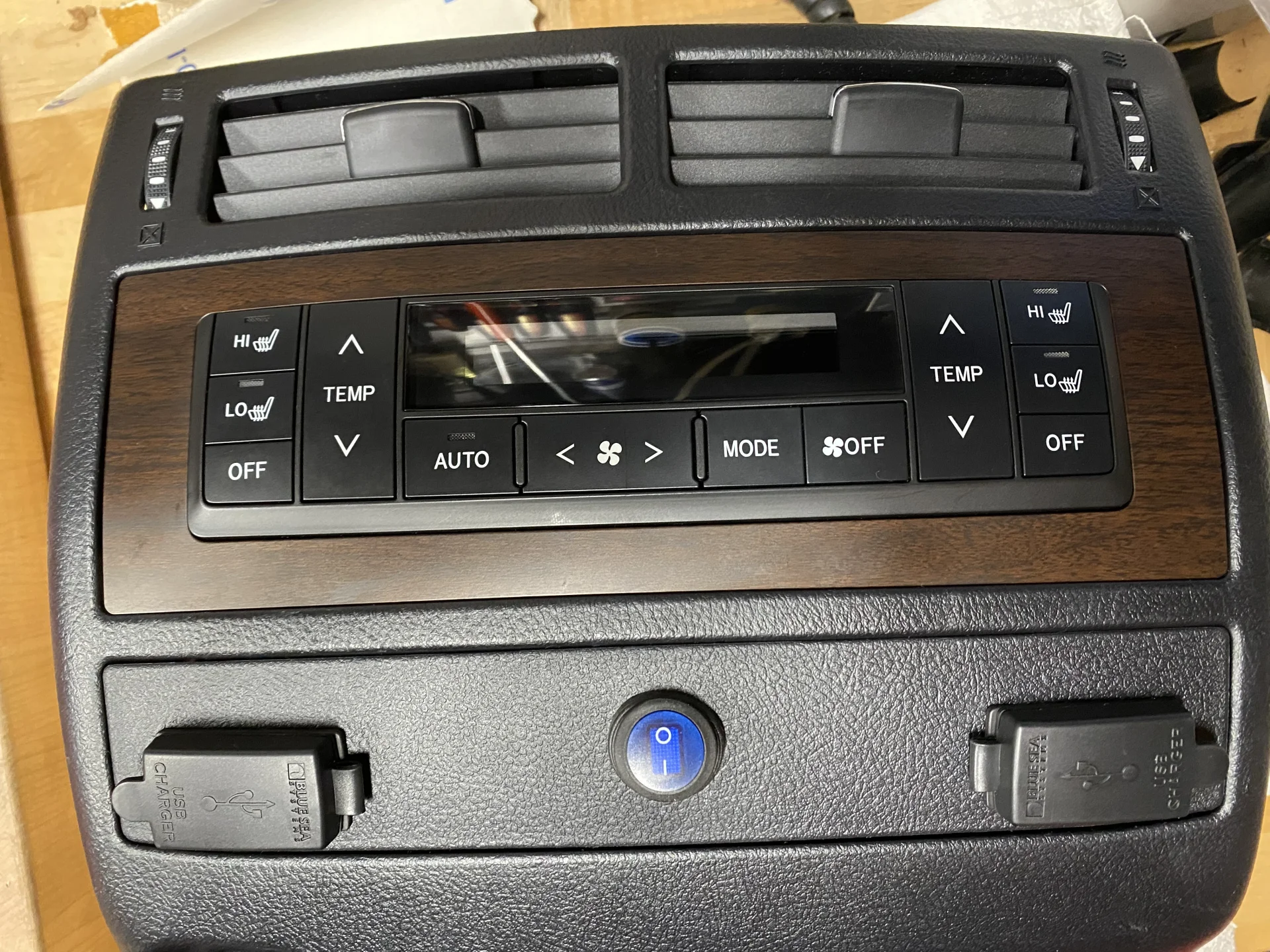

I added 2 2-port high amperage smart USB ports from BlueSea #1039 .. best single mod I've done the vehicle.
@Julian73 that look nice! I'm hoping to make something similar (close to OEM look) as possible. Thanks for the pic!
Did you disassemble anything with the center console before drilling?
Mine is a 2021 HE without cool box and I can’t see how to disassemble that center console.
