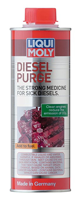

    Buy 3 cans of this stuff and disconnect your fuel line from tank and directly feed all 3 into your pump and let it sit for an hour. Every 15 minutes start your engine and rev it up for 20 sec or so. After a couple hours take your truck for a good drive. Works wonders on old pumps with deposits.
