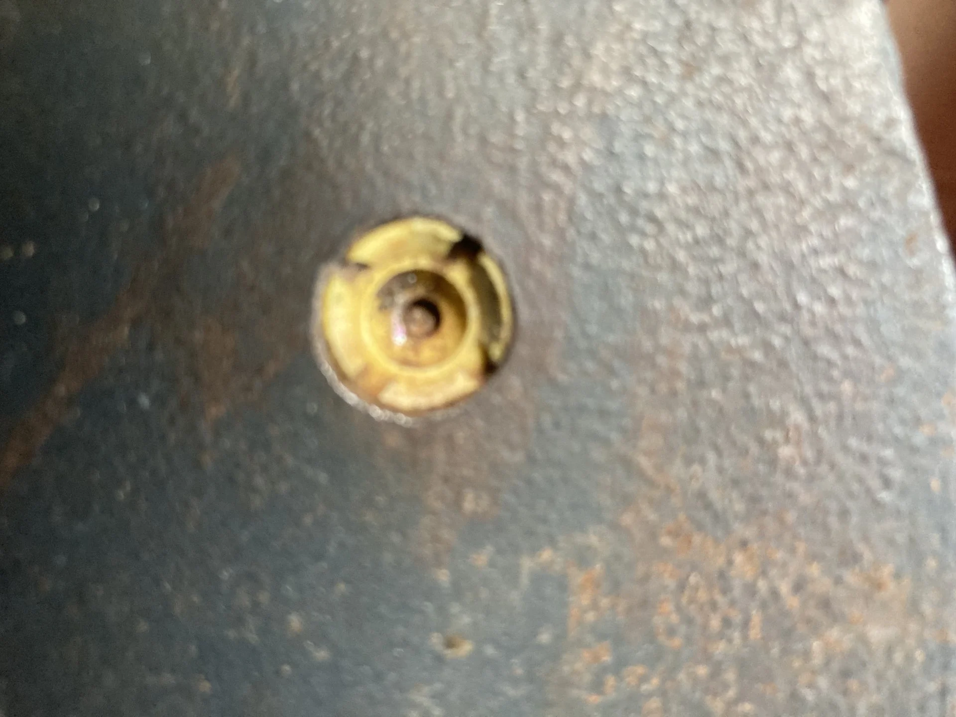

do you use to grease the anti friction pads on OME leaf springs? thx
None.
But if you really want to, there are needle tip grease tips that can be used. Lift up the frame high enough so the springs droop way down, then pry a gap between the leafs in question with a big screwdriver - then squeeze in some grease or smear it in there with a thin metal rod or putty knife.

It's not like you need high pressure for the friction pads. All I do (on my oz patrol with ome leaf packs) is click a grease nipple (spare) into the grease gun. The threaded end of the nipple I just press up into the hole on the friction pad, then a few pumps & it's done. There's probably a big $ome special tool that you are meant to use :)

There you go- thanks george
