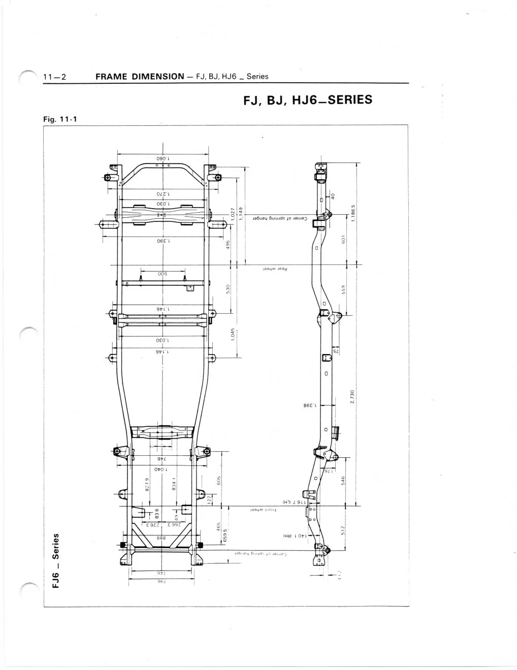

What is the maximum bend "tension/compression" load limit before a frame can buckle under load?

I like to know and see how if even possible, future frames could be built vi 3d printing. The other idea, print each piece and then bolt/weld together.

You would have to identify the alloy of the steel used, measure the wall thickness of the frame, and then model the overall cross section of the frame to determine that analytically.
3D printing frame components is not ideal use of 3D printing. The frame components can be bent up from sheet stock much faster on a brake or press.

If we forget the 3D printing for a minute and focus on your first question this is a pretty easy question. You will just need a diagram of the frame and some information about the material used as well as its cross section dimensions. You can look at the moment arms in the frame and the loads and put together a freebody diagram and just work your way through to figure out what sort of loads you will see.
The 3D printing question is not so easy to answer and is really a theoretical at this point simply because I don't think there is a metal printing machine big enough yet to print a whole car frame. 3D printed parts are better than castings but not as good as forging. You could however build a scale model of your idea but just be aware that not everything scales linearly.
