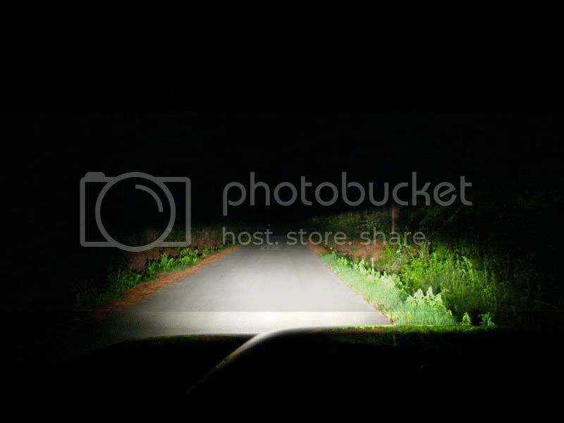

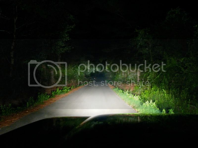

I love my Hella 4000s with a 4300k hid kit. They are ultra bright and cost about $250 with the cheap HID kit.
Back when I still had depo halogen headlamps
low+high
Low+high+4000 hids
