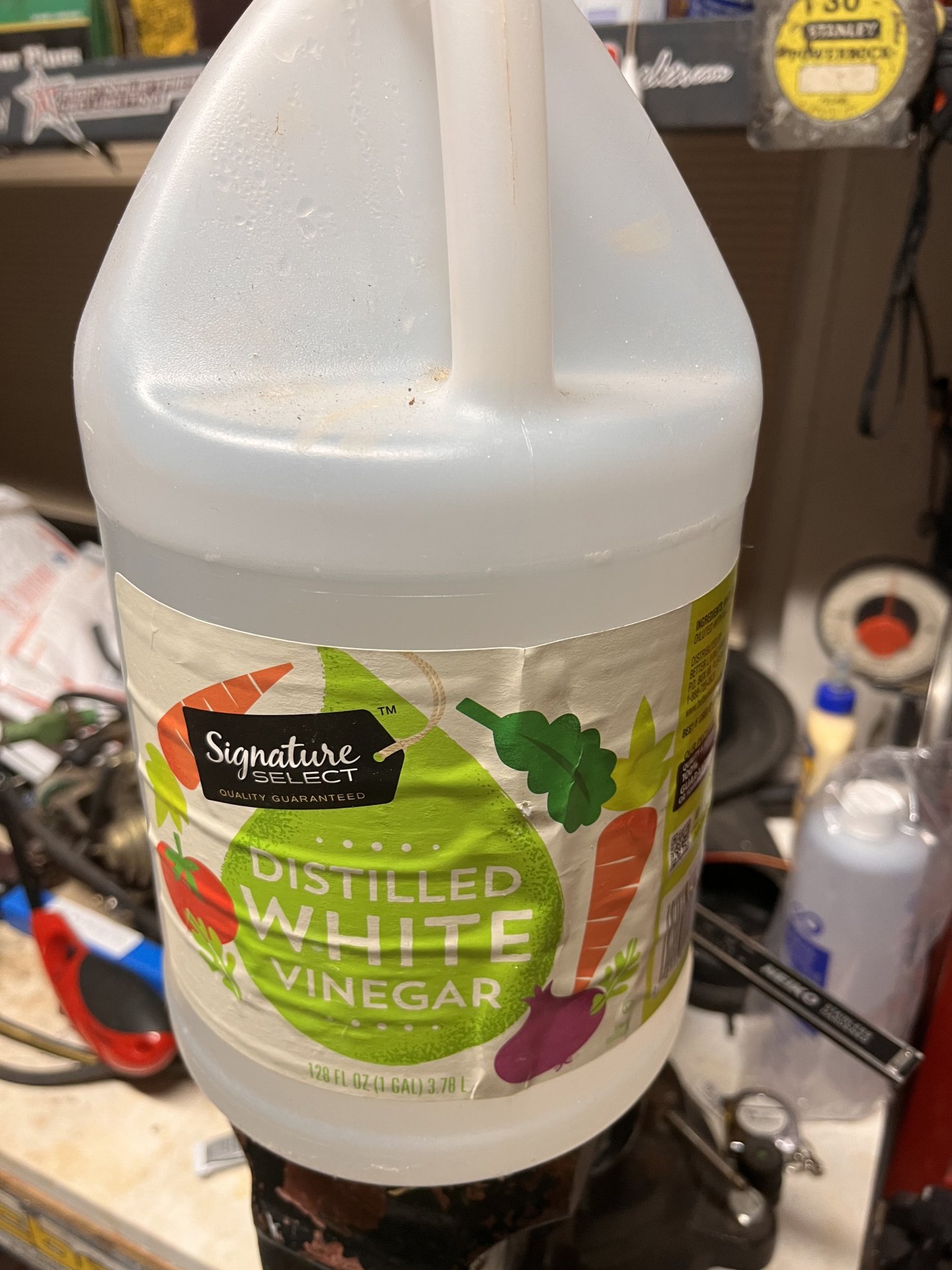

does it matter if it's just distilled vinegar, or white vinegar?
Whatever my wife has on hand it’s the acidity that does the trick. I have used phosphoric acid from Home Depot as well, but if not removed right away it’s a problem (like muratic acid). This can be an issue in hard to reach places and PPE becomes a lot more important which is why I switched to vinegar.
Looks like it’s distilled and white:

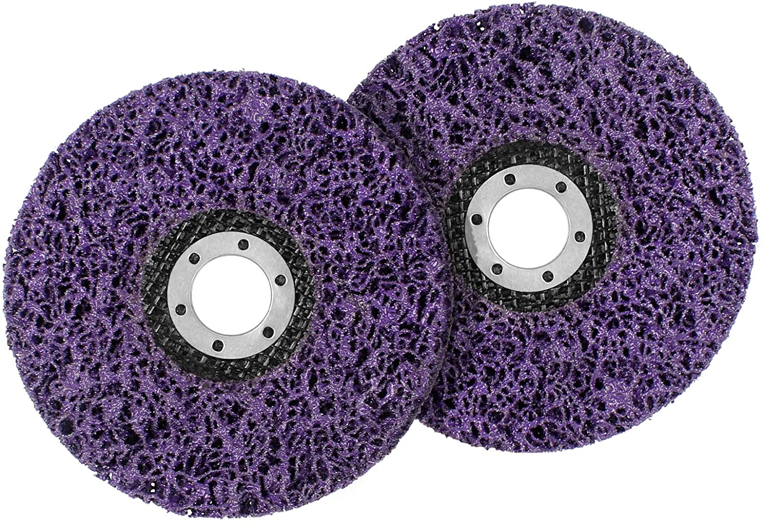

I use these or similar discs/ wheels for removing rust. They will eat rust out of the metal but not remove any steel. I find them to be very good on smaller or localized areas .
