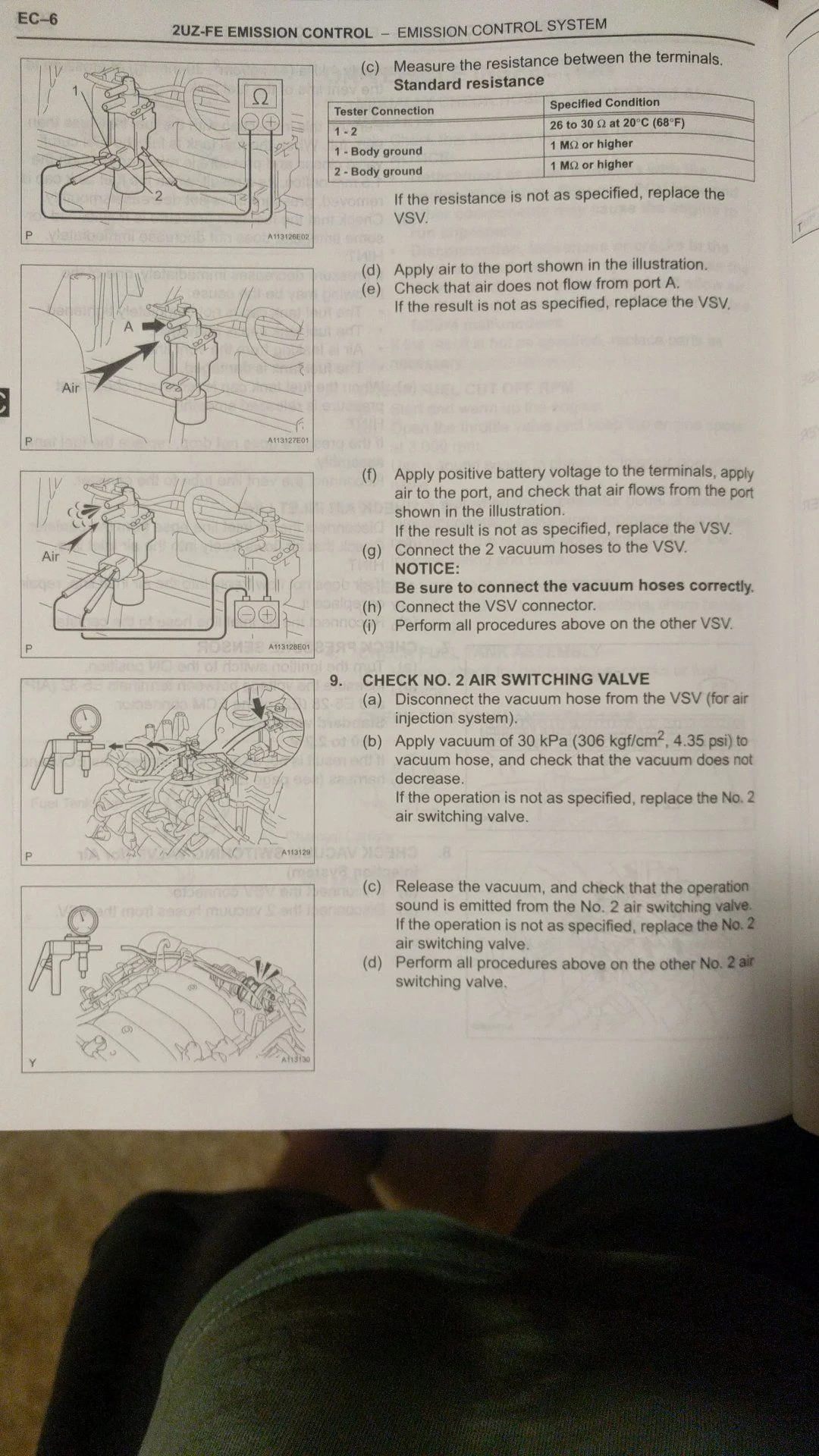

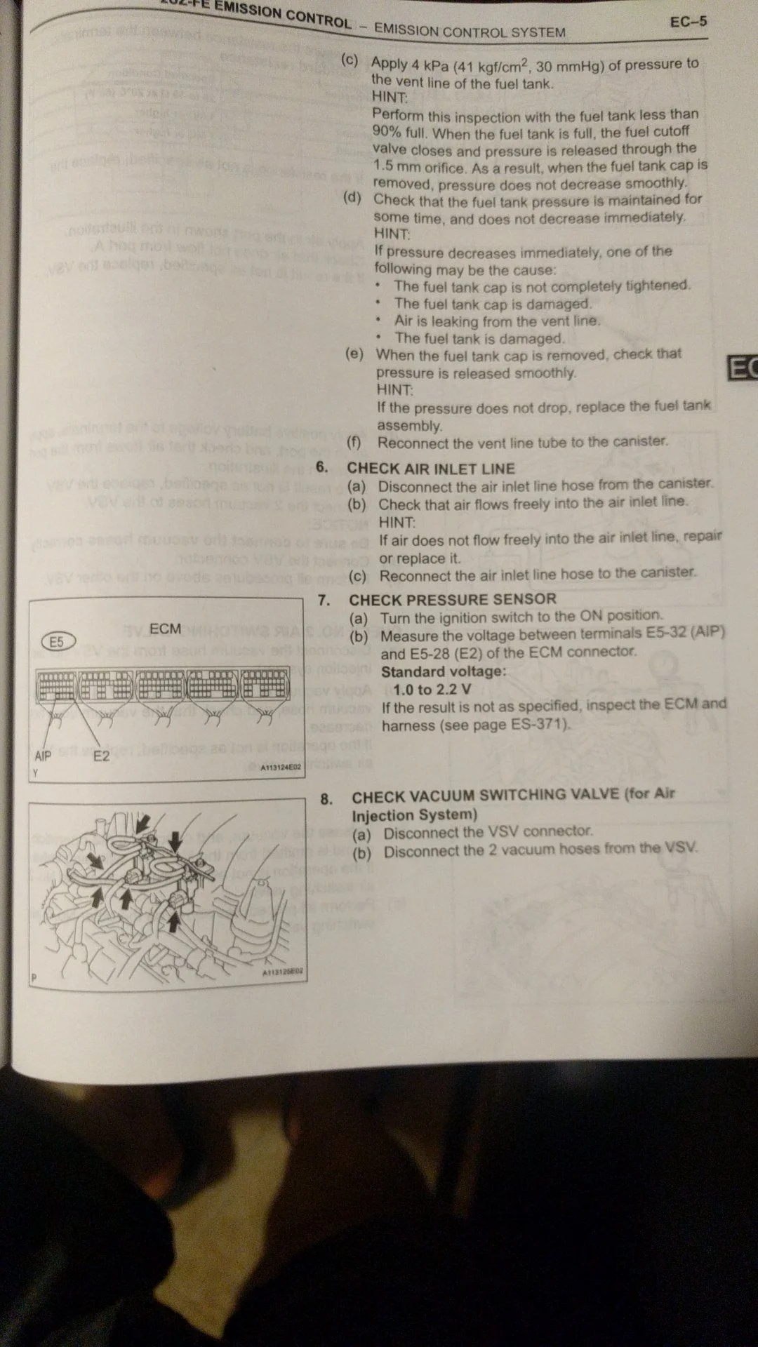

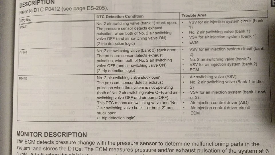

Hi, just got the exact same issue. About a month ago the check engine light came on, it was the gas cap. Ordered a new gas cap, reset the check engine light, about a month later check engine light comes back on. I was thinking it would be the gas cap again so instead of going to the garage I purchased a OBD2 code reader but this time the code is the following:
P1444: Secondary Air Injection System Switching Valve No.2 Bank2 Stuck Open
Has anybody else gotten this check engine code

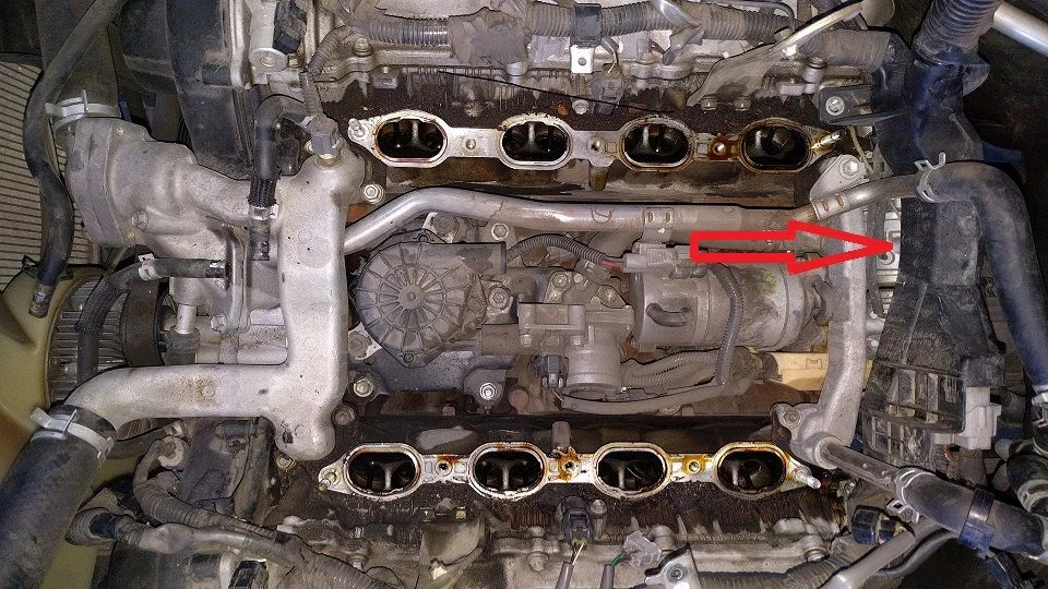

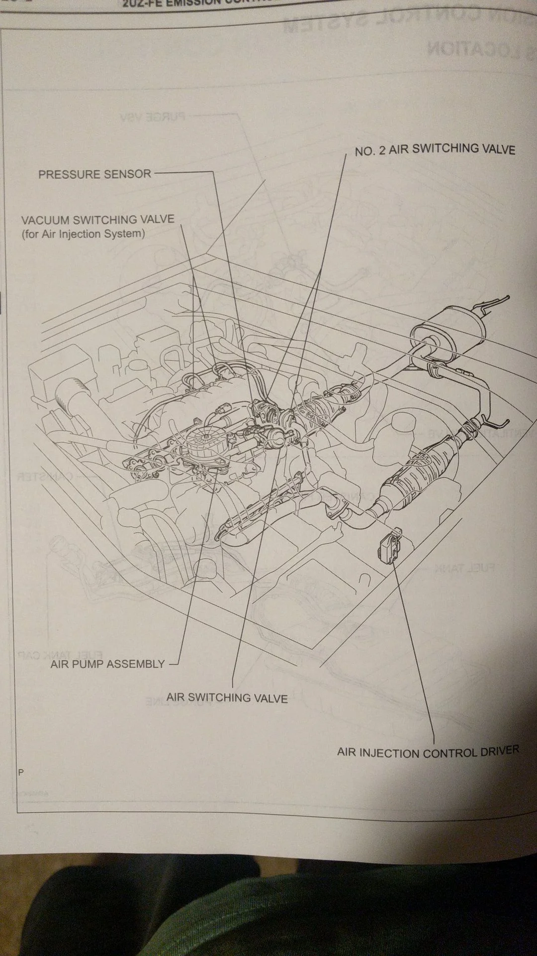

I would like to try to take the valves off and clean them, does anybody know where they are located? Has anybody else gotten this code? If yes, what was the fix?
