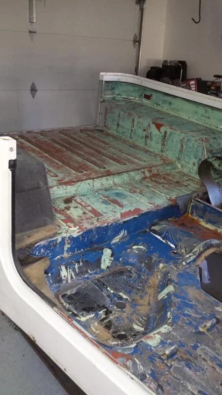

Two Hours of Hard Labor
Turns out this stuff is Smith's Ultimate Linings in Albuquerque.
According to their web site: "While you would rarely want to or need to remove it, the Ultimate Lining is intended to be permanent so it is not easily taken out".
Definitely worth the effort - I don't want any hidden surprises down the road.
And I'm rather enjoying the exposed palette of colors and patterns.
After another hour or two of this and I get to learn about media blasting.

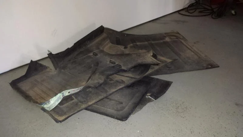

Maybe you could take that stuff you pulled out and make some custom floor mats.
that's a great idea! it probably has some sound deadening and heat insulation properties. all a bonus in a 40!

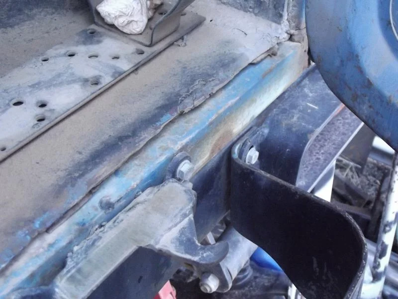

here's my simple angle iron rear sill. there was so little to attach to, we just put it on the rear frame x-member body mounts and welded it on the ends to the fender wells. not sure this helps you, but if you want I can get pics of the under side.

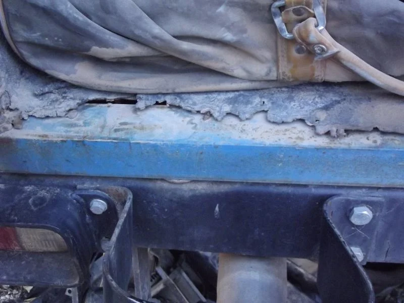

John,
A little patch work can go a long way. Careful cutting to remove all the cancerous steel, cut a new piece and weld it in clean. Good prep work front and back and your repair will be as solid as the rest. Cutting out the whole rear sill and replacing is doable but I wouldn't waste the time on the cancer you show in that pic. There are much bigger projects coming in your build. I didn't want to replace mine either but as the pic will show, there was a bit more rot than I could handle with small patches...

But if you want to cut in and burn a new sill in: go for it! It's your rig, don't let me tell you how to build it. :cheers: Also NICE PROGRESS! I was just telling David that your progress is making me really feel lazy about finishing my rig.....:bang:
Happy Welding!
