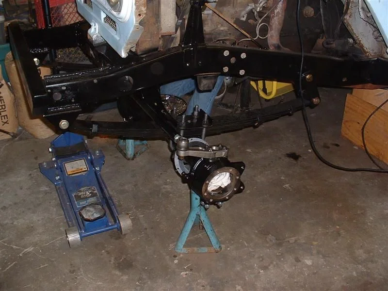

I took a hole saw to the frame, cut out the tube part of the old shackle mounts and welded it in.
here is someone else's pic-
attachment.php
