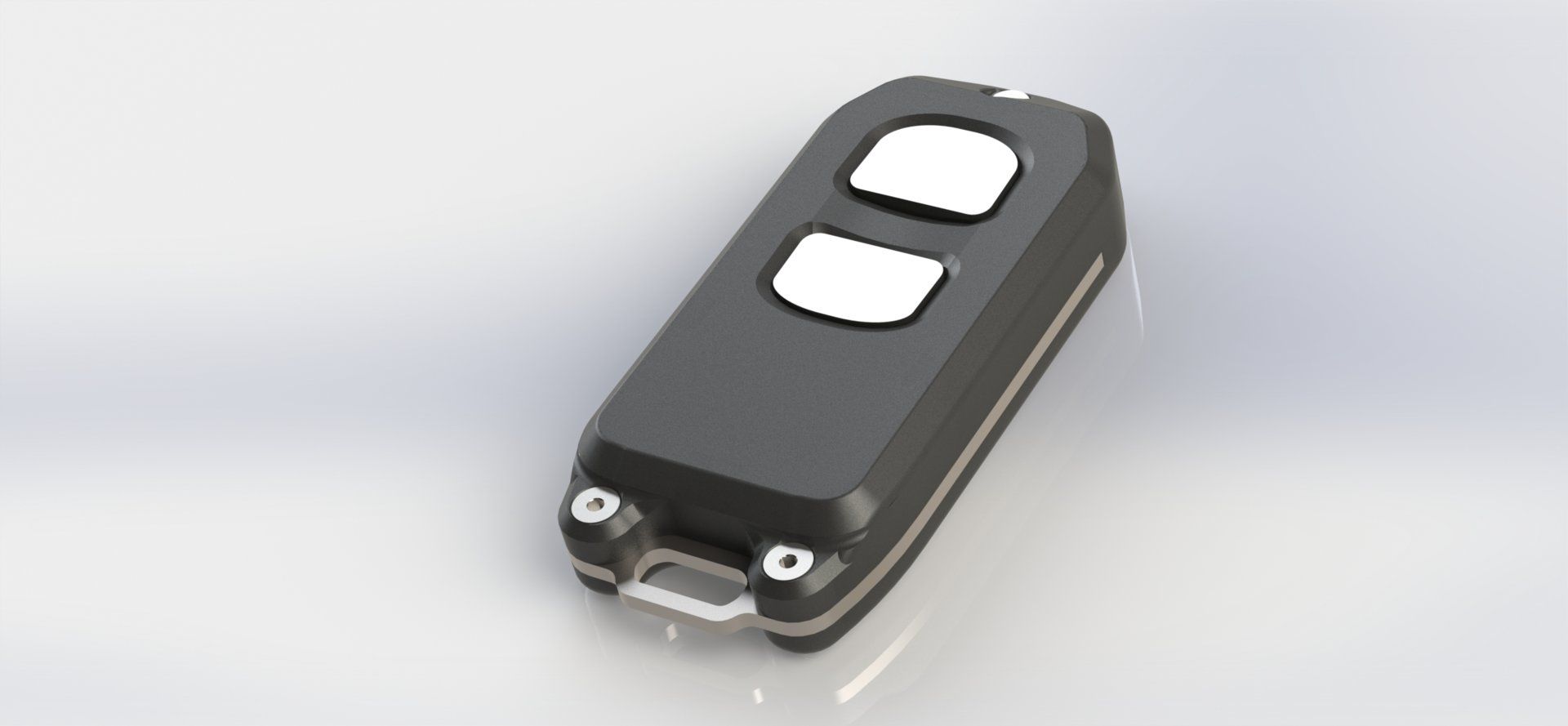

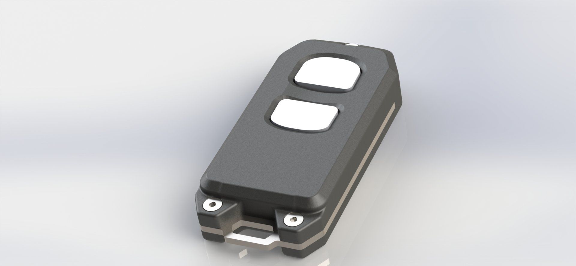

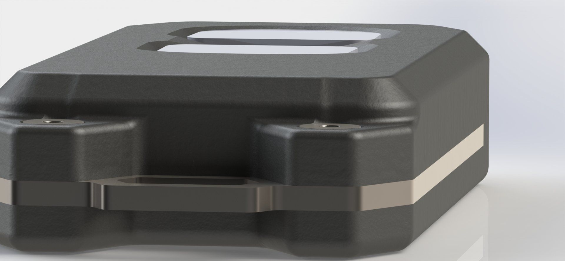

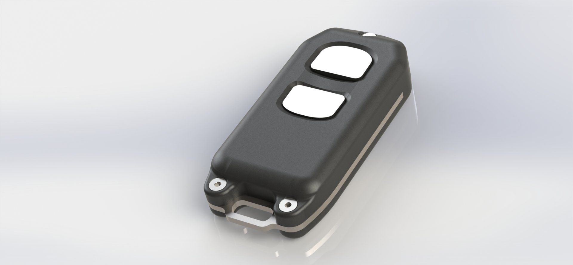

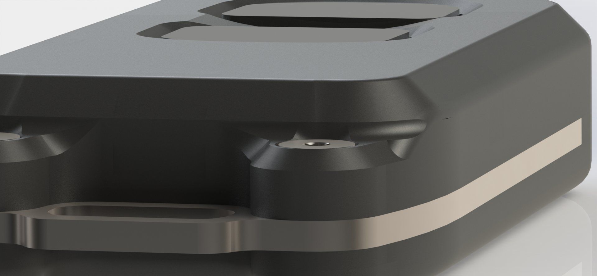

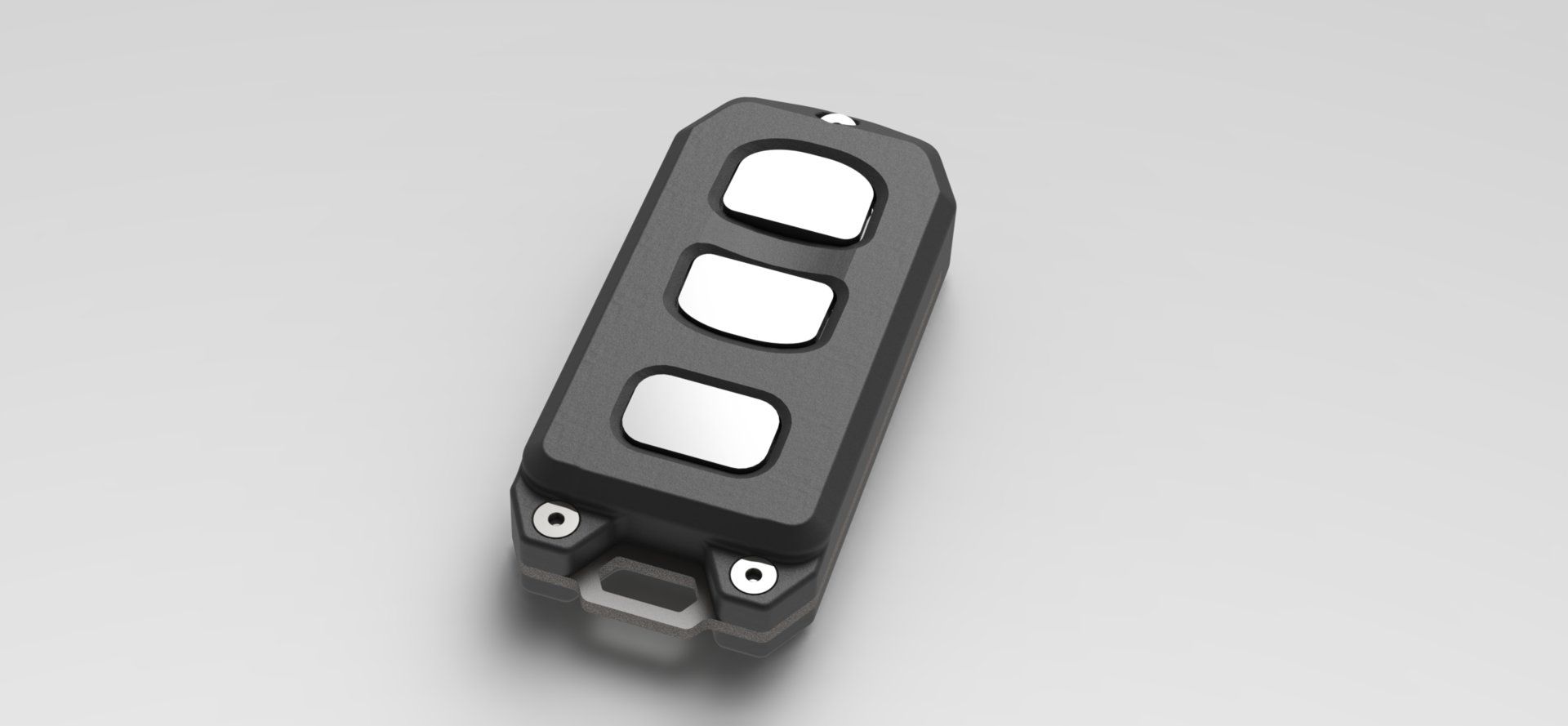

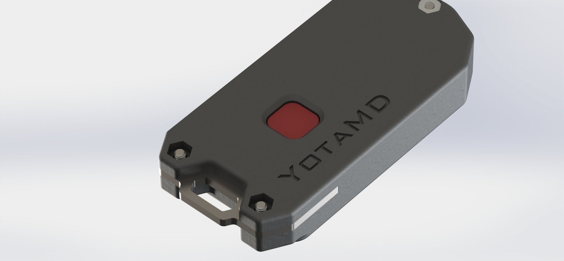

@abuck99 @BMThiker What do you guys think? Here are the two current versions.
Rounded (filets):
Sharp (chamfers):
Sharp-Chamfered for me. IMO the rounded style looks similar to the stock fob- kind of dated.
If you care to square off the fastening points like your other Trapezoid fob, it’d be even better.
Either way I’m in for 2 sharp when available.
I like this idea. It's a pain right now, but I think the redesign is worth it. There are a lot of design choices in that YMDT you pictured that I was really happy with. I should repeat some of those in this design. Hang tight, I'll get to work on that and show another render.

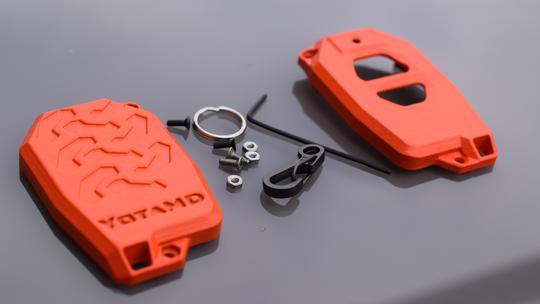

The OEM key shell is semi-flexible plastic. You can feel some squish as you turn the key, even in a perfectly healthy OEM key as you turn the ignition. That's the best case scenerio for an OEM key. Worst case, the key outright fractures and leaves you with a key blade stuck in the ignition which cannot be removed by hand. See an actual customer pic here. Notice that vehicle is on and running with no way to turn it off without pliers. This has happened to more customers than I can count at this point. No biggie if you have pliers on hand, but a major pain if you don't.
YotaMD YMD1 kit has two grade 5 titanium plates precision cut to within about .002" in the critical features. These plates hold any style of OEM key blade more firmly than any OEM key shell and will never fail. In addition to that, the YotaMD plastic is a durable nylon and the hardware is all stainless (optional black oxide if you want the black look). Since the YotaMD kit re-uses your existing key blade and remote it also saves you the hassle of any reprogramming or key cutting. I do also offer new key blanks if you have an existing OEM key in good shape and don't want to tear out the existing key blade.
$78 gets you the black shell kit. $88 gets you into the Cerakoted shell ktis. Those shells are the same durable nylon with an additional Cerakote ceramic coating to provide added durability and some optional vibrant colors.
Let me know if you have any other questions and feel free to ask around the 100 section of this forum. There are literally hundreds of customers on that section that can offer a wealth of real world, unbiased testimonials.
The YotaMD kits are intended to last a life time, but I've also got some world class service to back up the product should anyone run into an odd failure or something. IE, one guy threw his keys in frustration after some life event (forget exactly what it was, but I remember he felt dumb). He managed to crack a corner of the case and I sent out a replacement.
The YotaMD kit should be the last key you ever need to buy for your vehicle.
