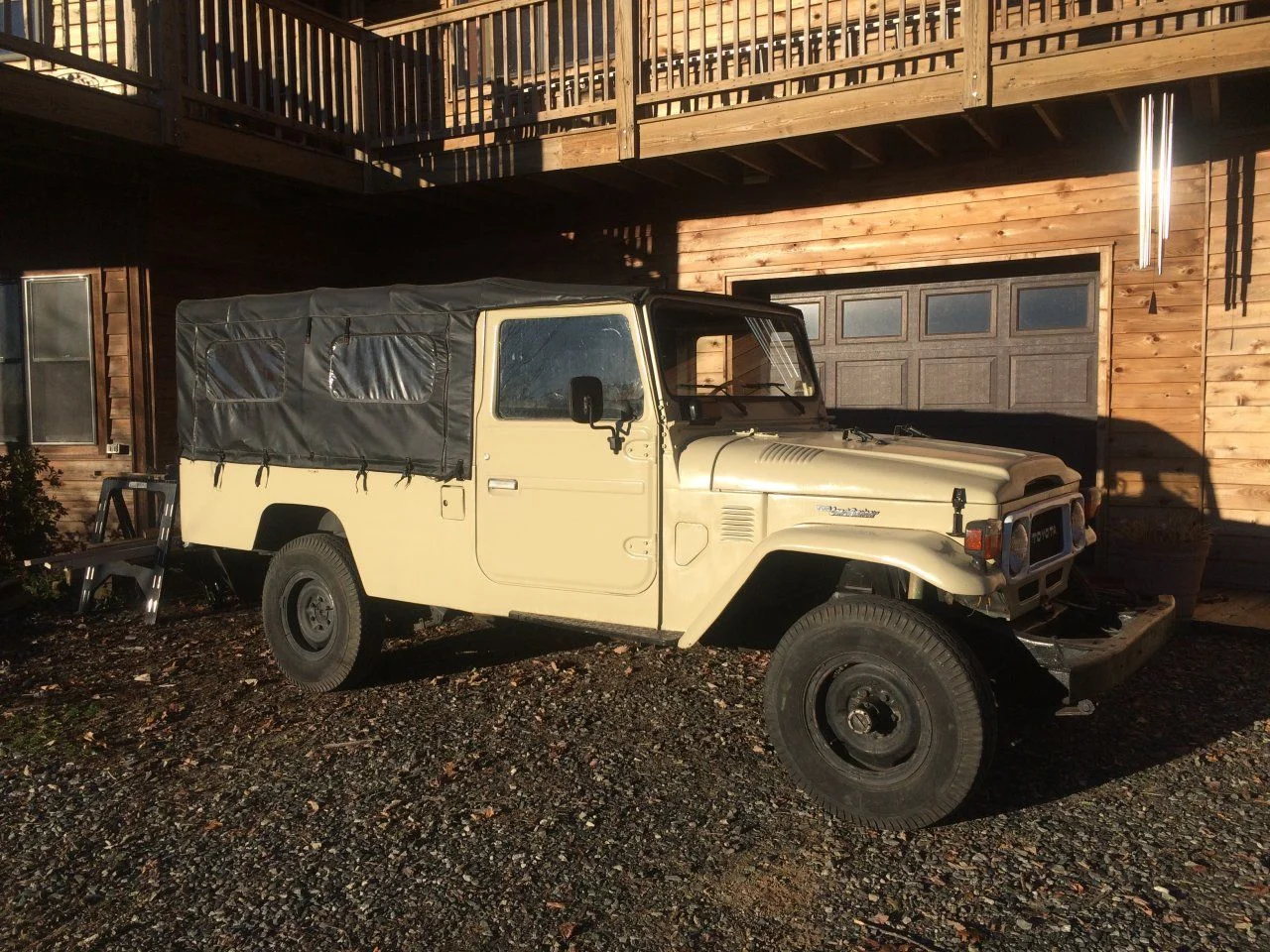

I took this one with my phone when we got home a little while ago. Like I said, if you want a picture of anything in particular, anything, I'll go out there and get it for you. Thanks

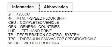

toyodiy.com is your friend for ID'ing later stuff. I entered your chassis# and it came back with this: http://www.toyodiy.com/parts/q?vin=FJ45-0285427
From there you can access all part #'s for your truck, making sourcing parts easier. I believe you can even quote Toyota part #'s to places like SOR and they should be able to help.

Looks nice and it seems you have already picked up the madness !
You are located in a colder and more humid climate then Chile. If you are going to drive it daily I would check up under how the sheet metal would hold up over the coming winter.
My experience with these snow tires on the split rims is the bad watercontrol that makes driving on a wet road very slipery.
Are you going to put powersteering on it ?
Always good to see a troopy.
:cheers:

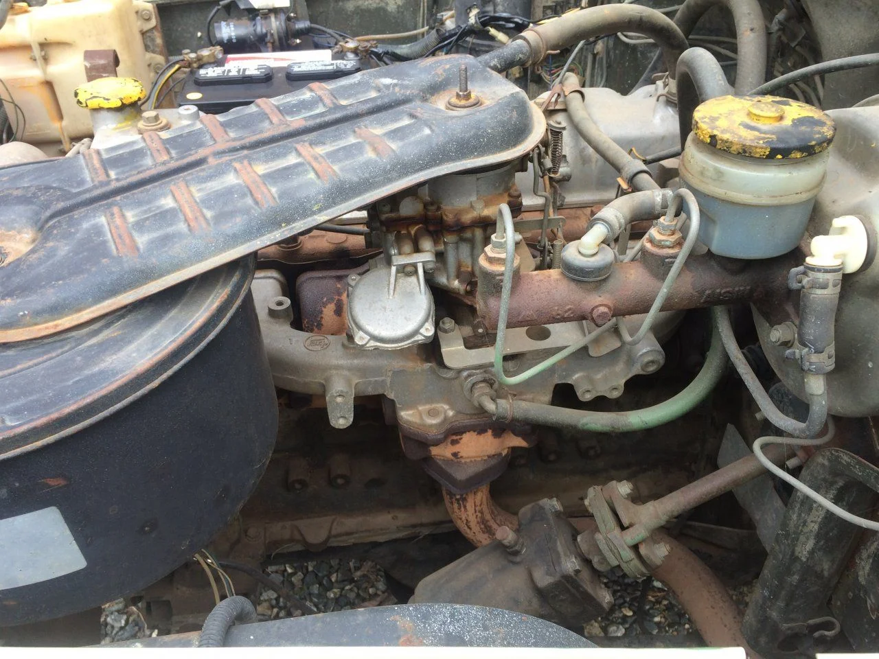

Looks good to me...I wouldn't change a thing. You might be able to find a 73-ish F paper element air box to replace the oil-bath. I run an oil bath air cleaner and have no issues. You're lucky to have a non-U.S. carb as well. If you had a U.S. spec'd 81, you would have a mess of tiny vacuum lines (like 27) snaking all over the engine, hooked up to plugged, cracked and non-operable plastic emission control devices.
You can easily replace the points with electronic ignition as well. I ran points for years and had no issues with them either...just kept a spare set in the glove box.

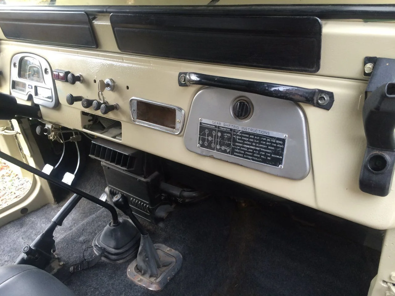

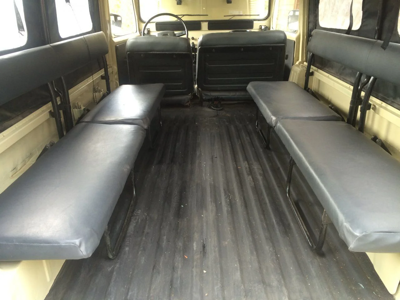

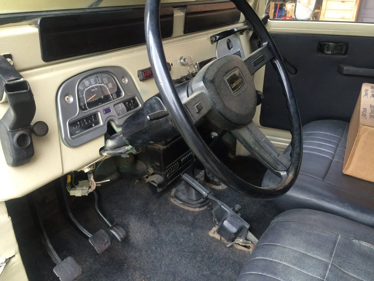

Interior looks like it's in great shape. I have a Chilean spec'd FST as well, mine isn't in nearly that nice of condition.

X2 on ToyoDIY website for finding non-US spec part #s. Availability of parts is another issue. You can check availability in NA (some stuff in Canada) on Toyomotorparts.com, Toyotapartszone.com or toyotaonlineparts.com (latter seems to have best prices). Round air cleaner is original for General Market (South America) late model 40 series. You can convert to oval air cleaner, helps if you plan to run factory p/s pump on left side. You are correct about the older engine configuration on 40 series from South Anerica. You will find differences in ignition, wiring, water pump (no fan clutch), t-stat housing... Most of the differnces are due to not having pollution controls. It's is nice though to not to have that mess of vacuum lines in the engine compartment.
Thanks to you all for the comments, information and input. Now, let's see, no, I'm not going to put power steering on it and I'm going to leave the oil bath air cleaner on it. Like Dan alluded to, leaving it as stock as possible is what I want to do, that's the major draw it had for me. There are two things I'm going to change: first is the headers. More power and better gas mileage is too good to pass up seeing as how I've got to fix an exhaust leak at the manifold anyway. The other is front disk brakes. I live on a very steep hill and I've noticed the back wheels lock up when I apply the brakes going downhill. That being said, the brakes seem to work fine on pavement: no pulling to one side, no rear wheel lockup, simply good brake manners. But I know, in the future, disk brakes will be more efficient, especially in the rain, less costly to maintain and much easier for me to change pads vs. shoes. Any parts I take off will be boxed up and kept, available for replacing to bring her back to the "stock" condition she's in now. Again, thanks for all the input. Please don't stop. rog

I think the L stands for left hand drive. Mine is a 45LPB. I'm assuming the PB is for pick up.
