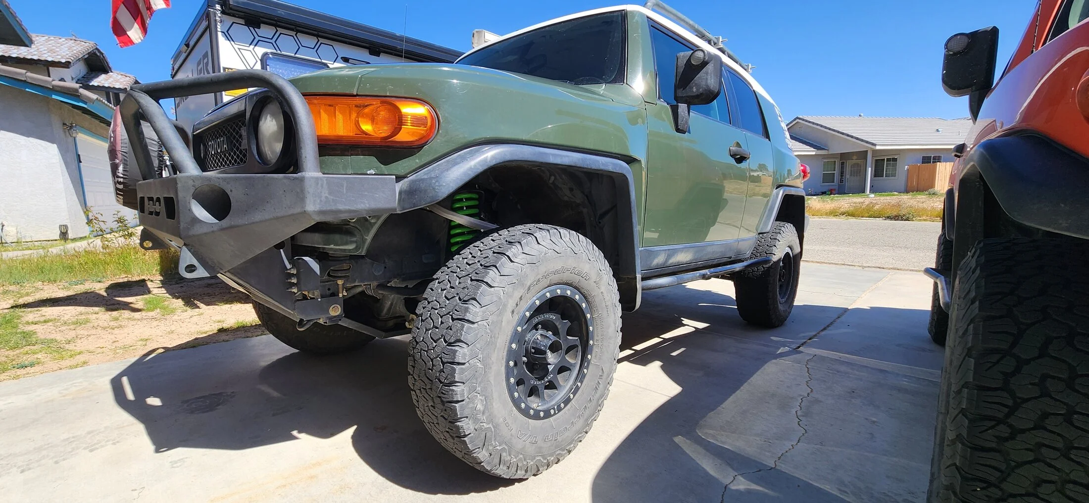

2007 6MT, locker, a-trac, black/white, factory sliders, 213,000 miles. Has the slight 2nd to 3rd shift grind. Not very rusty for being a Colorado truck it’s whole life.
The wheels that are on it are hilarious, so I picked up a set of the FJC 8 hole rims with tires off of marketplace.
