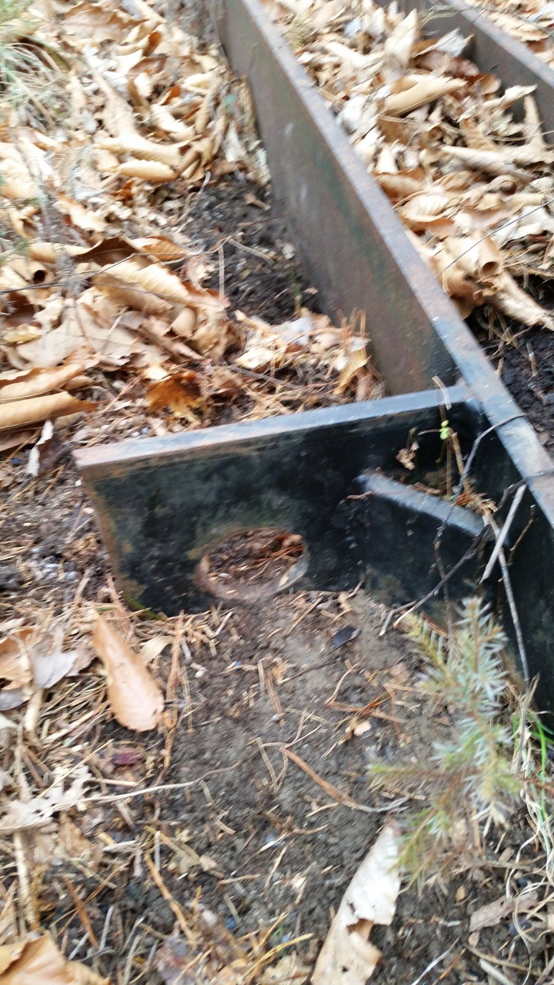

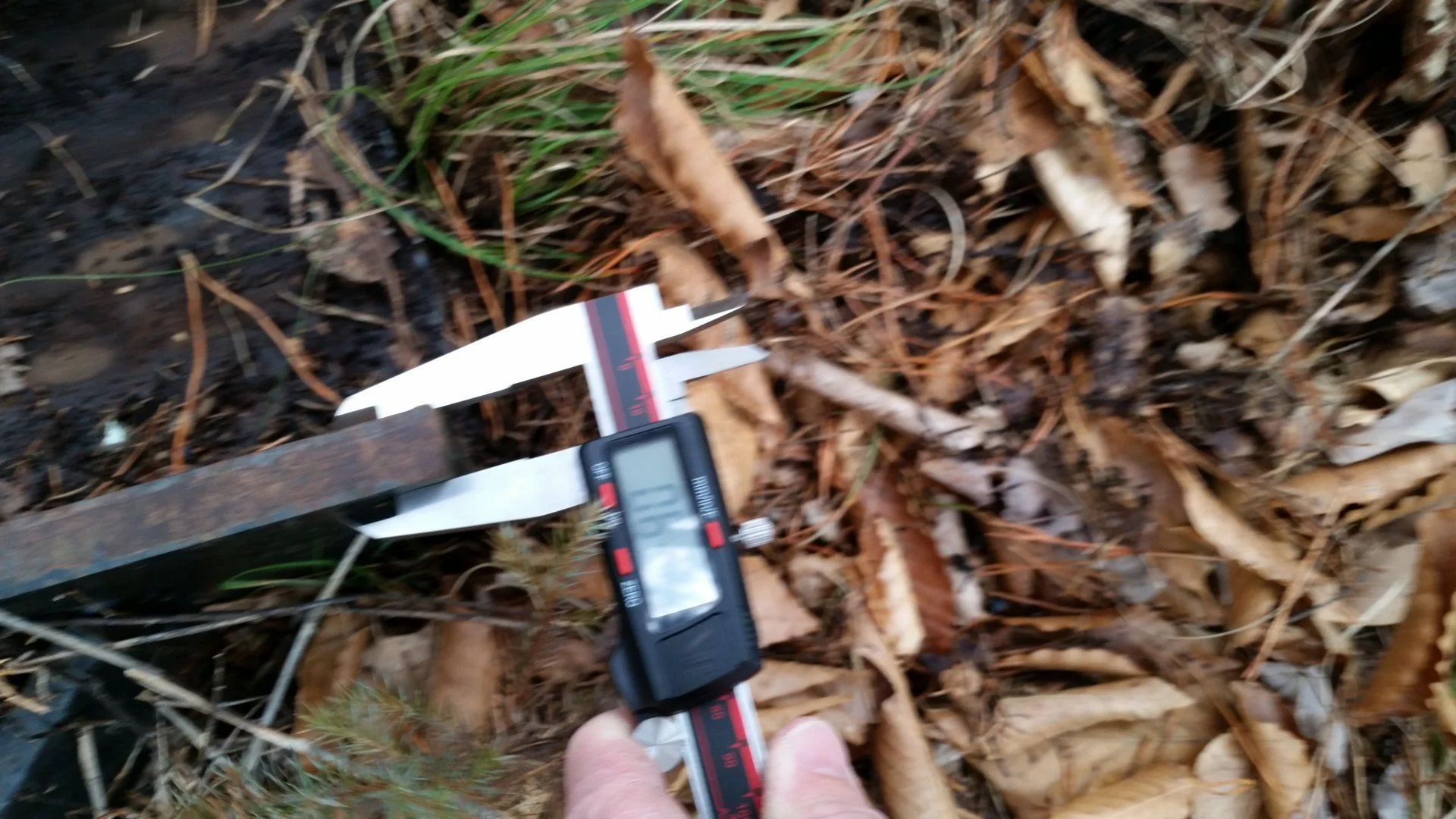

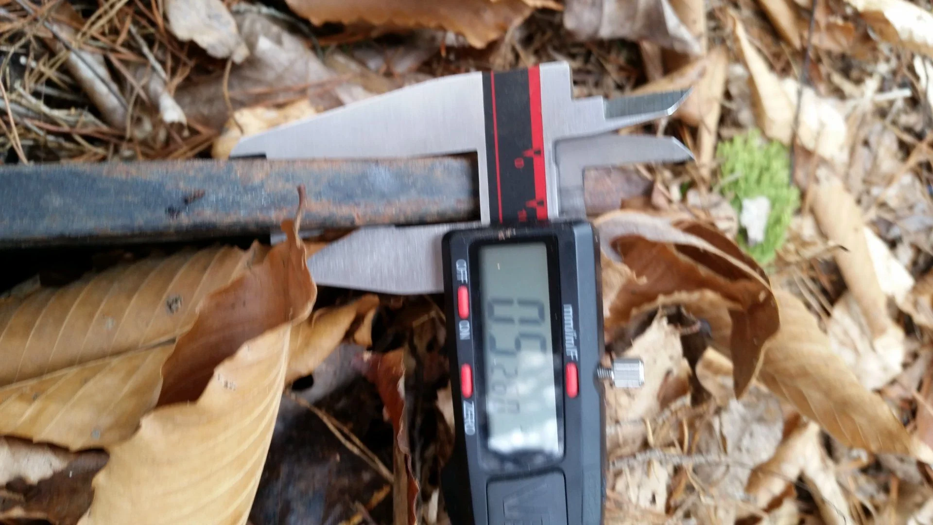

In the woods near my house on my HOA common property...I think no one will care if I get it. A 12ft long steel i-beam 8 inch sides and 8.5 inches across from beam to beam. Really thick it measured .69 inches thick (edit) flanges. (edit)Webbing and outer support pieces are around .52 thick.
I don't have an O/A cutting torch nor a plasma cutter. So I'm not sure how to even attack this. May have to borrow a bigger welder and rent or buy a cutting torch. I was thinking sliders or rear bumper but maybe this metal is just too big. Probably would be great for making recovery points. Not that I need one hundred of them. Any re-purpose ideas? Anyone know what this is? Any guesses as to what it would weigh?

In structural parlance, that is not an I-beam, it is either a WF (Wide Flange) or an HP (H Pile) section. I don't have my tables with me to fully identify and won't be home for 3 more days. I estimate it weighs approx 45-50 lbs per foot. So if it's 12 feet long, you're looking at around 600 lbs to move it (and support it).
If you decide to use it, I can estimate the maximum safe load at the center. It's gonna be pretty high.

So some more terminology, since I'm a former statics teacher ( I love statics and structural design).
The entire thing lying on the ground is not a beam, at least not like it is. It will be a beam when it is installed in a structure horizontally, holding up a load. Then it's a beam. If it is positioned vertically, then it's a column, which is probably what that shape was originally designed for, due to being square.
The part you call "beam" is actually the flange of the section. The part between the flanges is the web. Many structural shapes are welded together, but most common sizes are actually rolled, which is why the flanges will have a slight taper.

thanks for this. I couldn't remember flanges and web. Looks like the web is welded to the flanges. What kind of metal do you think this is? Cold rolled, etc. Not sure how long it's been in the ground but even the lower half of the flange that is sunk in the ground looks to only have very light surface rust. Is it true that older USA steel has more iron in it or doesn't rust like the chinese metal imported now?
