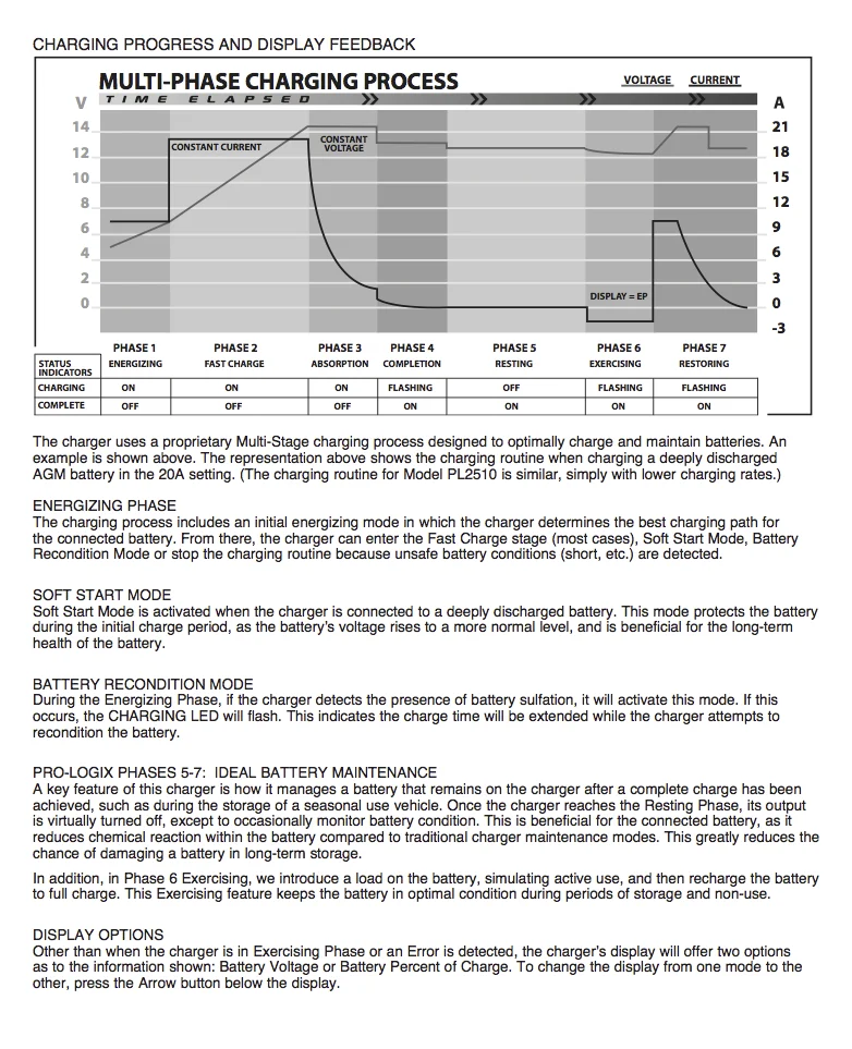

Earlier this year I picked up a Clore Automotive charger/starter at Napa when they had it on sale: https://www.napaonline.com/en/p/SORPL2520
A friend bought a similar Mac branded Clore charger off one of the Mac Tool Truck. It doesn't have the start function and weighs less than half what mine does. He paid about double (tool truck, remember?) what I paid for mine.
I'm really pleased with it. It has started my K2500 in cold weather on the start function and I also "reconditioned" a battery that showed as 0 volts when I started.
