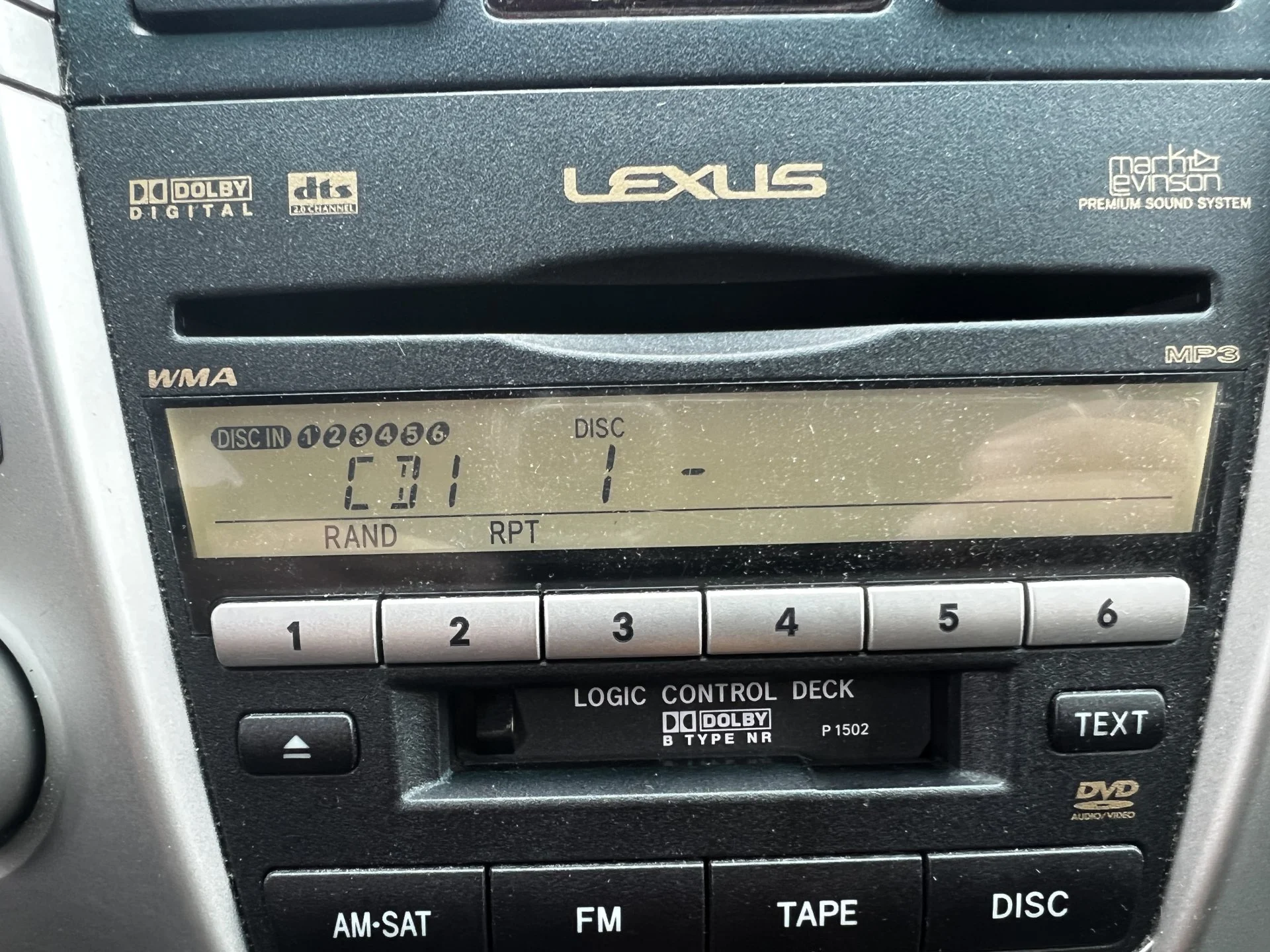

Based on your experience, do you think that Bluetooth module will work? What button do you select to activate that source?
In the RX400h application, I select CD1 Track1.
Interesting, I'll play around later today when module arrives and report back to group.
Ok, so good news and bad news. When you click the CD/Aux button and select CD as the source, on LX it plays audio from your phone perfectly over Bluetooth.
The only problem is that you cannot be connected to LX570 for phone and this device for Bluetooth media. You can only connect to one at a time so you have to chose which to use.
I have reached out to the manufacturer to see if they have another model that can handle music and phone.

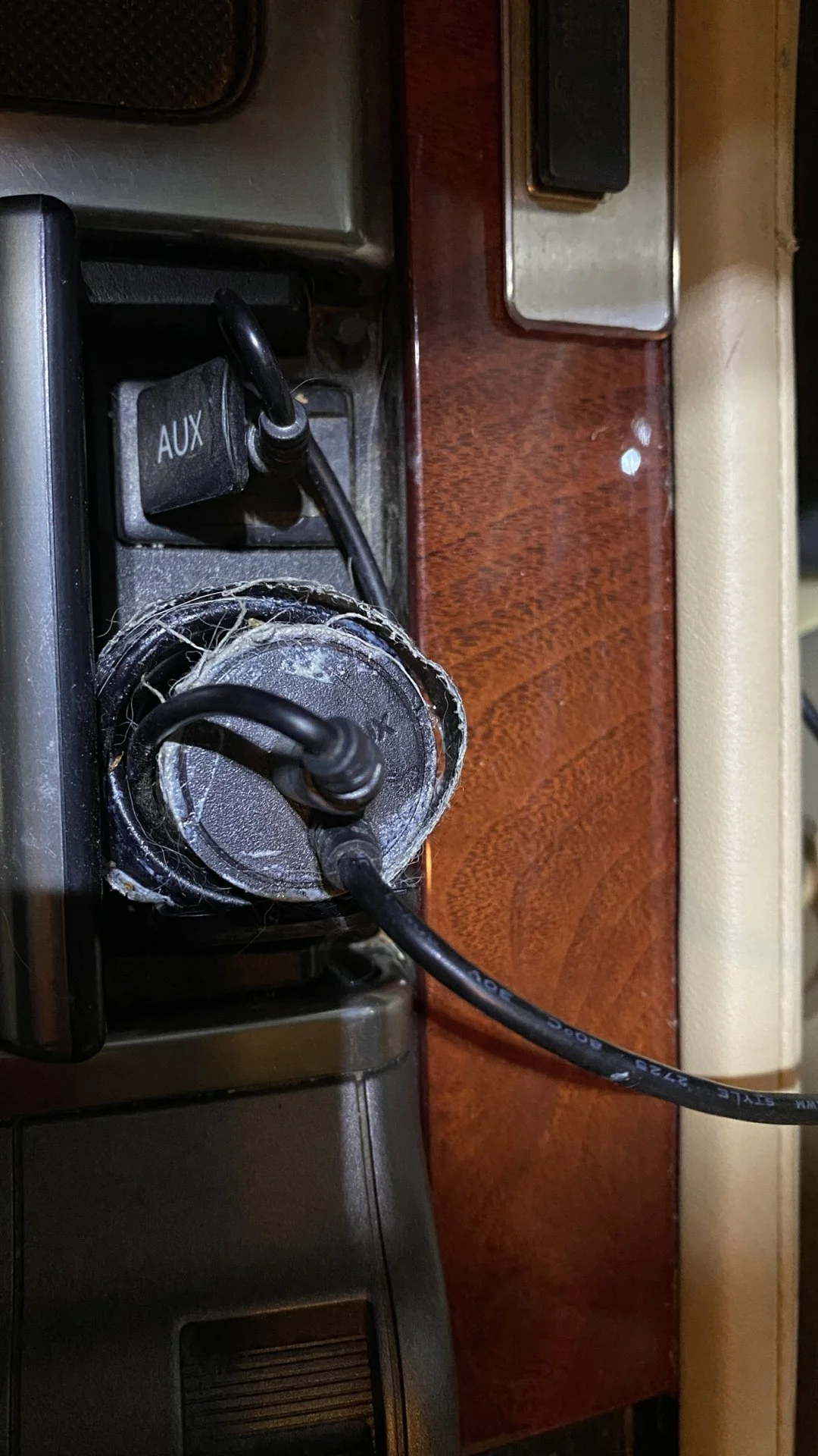

I bought this for my 2007 LC but swapped it over to my 2008 LX. Works every time and was an easy install. I don't use the microphone. My iPhone 11 connects to the Lexus system for the phone and the BT45 for music. Somehow, it gets it right and just works.
