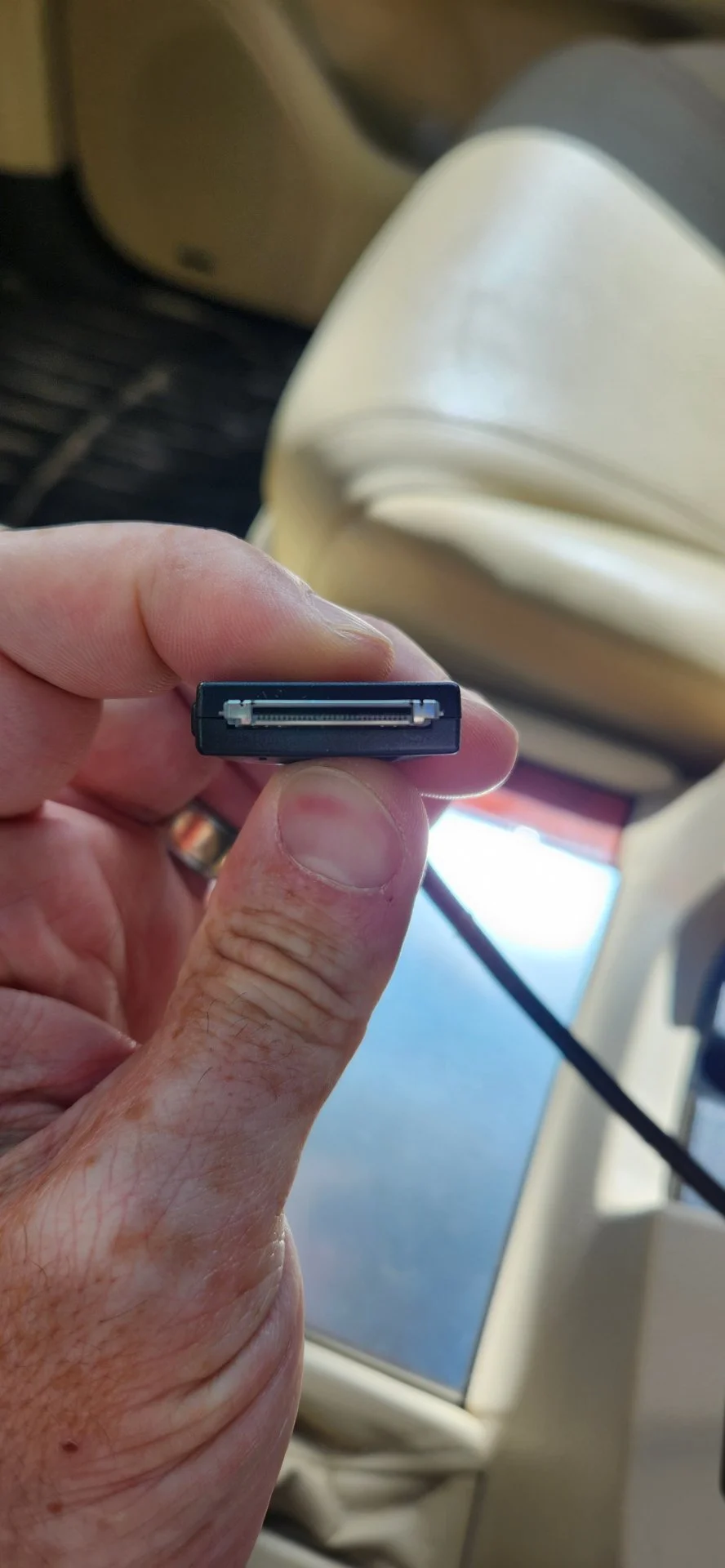

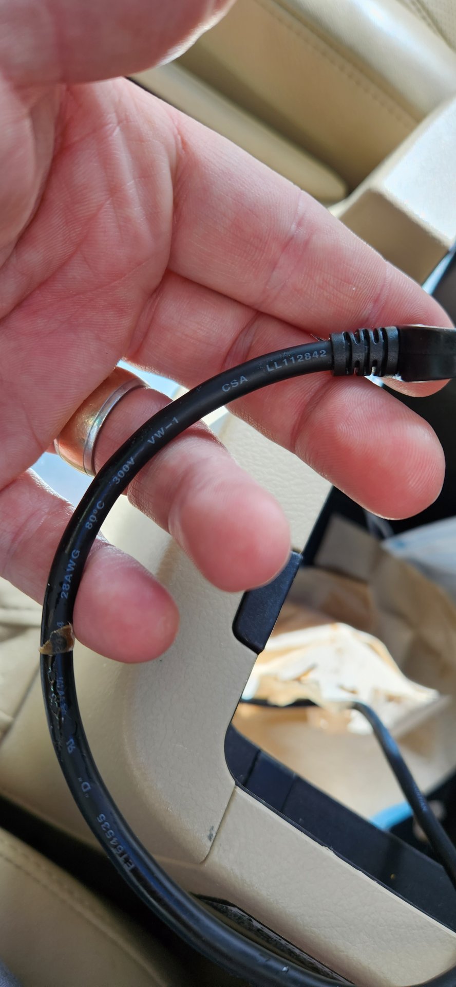

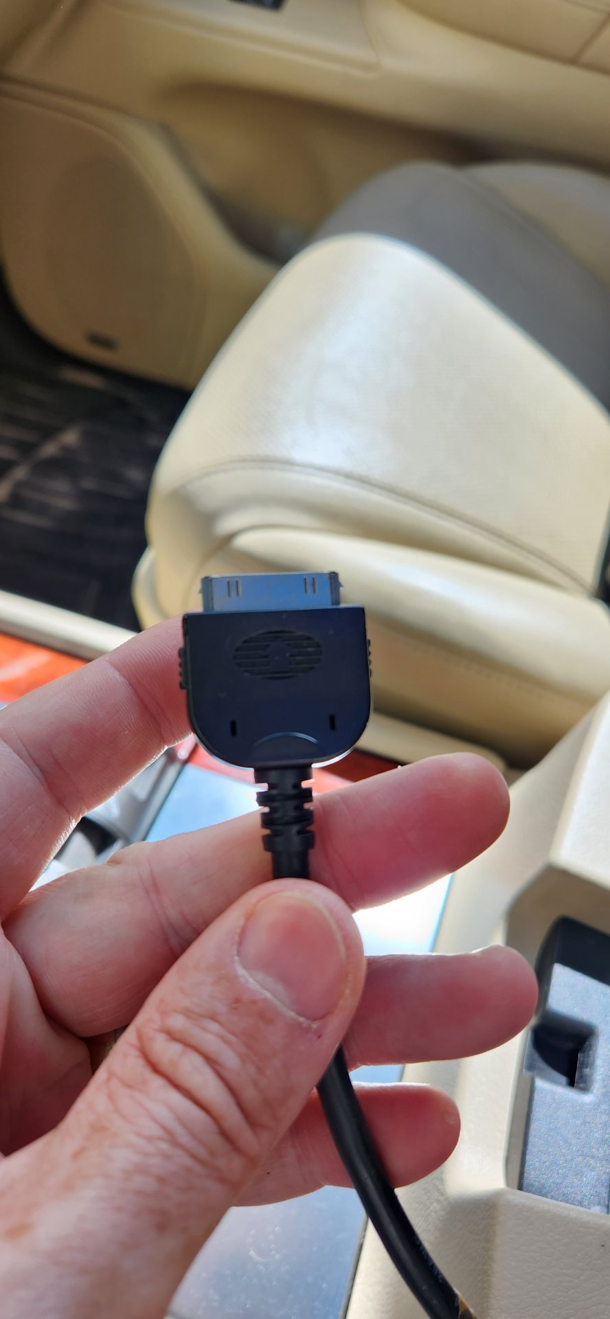

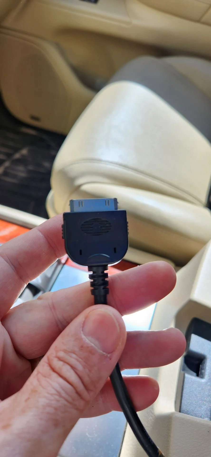

What about the media plug that's in the bottom of the armrest compartment? Is anyone aware of a Bluetooth adapter to that? In my opinion that would be the best option because it's hidden and when you want to stream Bluetooth music, you just select that option through head unit.
I suspect that's aftermarket. Looks like an old apple 30Pin connector. Wonder which input it's connected to .
On the plus size, there appears to be a market to convert that to bluetooth so that people could keep using their old 30pin all in one speakers.
Amazon product
Maybe it's this, although doesn't list as compatible with LX570. But i wouldn't be surprised if it works, especially with a pre 2010 model. Not sure what year yours is (although i guess you wouldn't be asking if it was 2010 or later, because you'd already have bluetooth)
I don’t have a media connection in my 2009. Interesting!
I used to use an usb powered 3.5mm plug Bluetooth dongle , but lately have been using the Bluetooth connection offered by my Alpine dsp. That signal never touches the Lexus audio stack at all and gives an almost CarPlay like experience (phone based though)
I have a 2008. It appears to be a stock audio cable in my center console. No indication of aftermarket. I wonder if that unit you posted would work for me.
I would bet that IS and iPod cable. Or something similar for a mid aughts music player. Probably hard wired to the aux input
I just bought this: Amazon product
I'll report back if it works.
I briefly thumbed through some forum posts and they said that the Toyota part worked with models that had a SAT button and it replaced the satellite radio feature. But there were other aftermarket kits available that might have provided that connector and connected differently.
I've never used the plug in the center console so I don't even know how to activate the source. I will say I have used the 3.5 Jack through aux and it still works fine. I also have satellite radio active in my truck.
Maybe the headphone jack and center console plug both tie into same aux button and you need to chose using one or the other.
Amazon says my package will be here today....gotta love prime!
