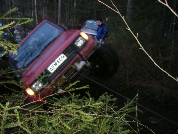

Yeah well... I bought that RD23 to rear until I hearded that it wont fit to rear axle, so I installed it to front.
Havent even cracked any joints
, theres bigger joints than at older LJ, allmost big as HDJ joints.
Here I wondered will it break but luckyly it didn´t
They dont even knock at all.
