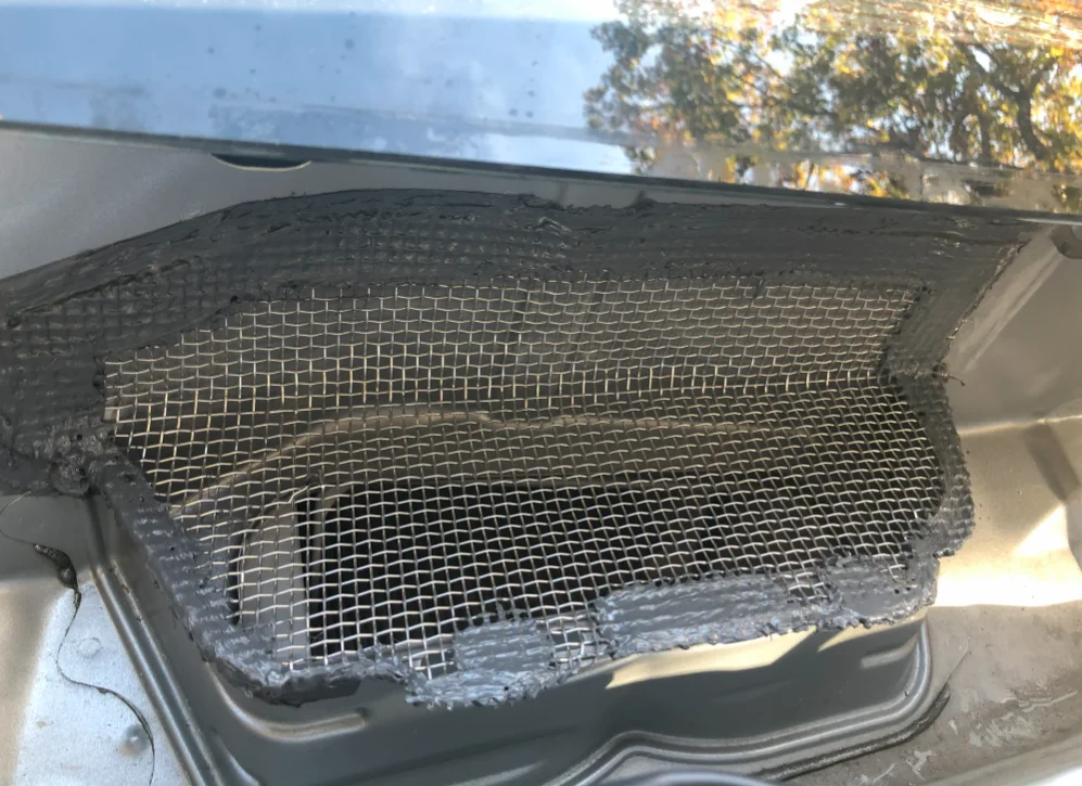

Finally got around to doing this. Used the seam sealer. Worked very well.
Before: Freeloaders Paradise
After: Secure Border
Could you post which brand seam sealer you used, we have the same problem with the fleet I worked at. Rodents are everywhere and they die inside too when they cant get out.

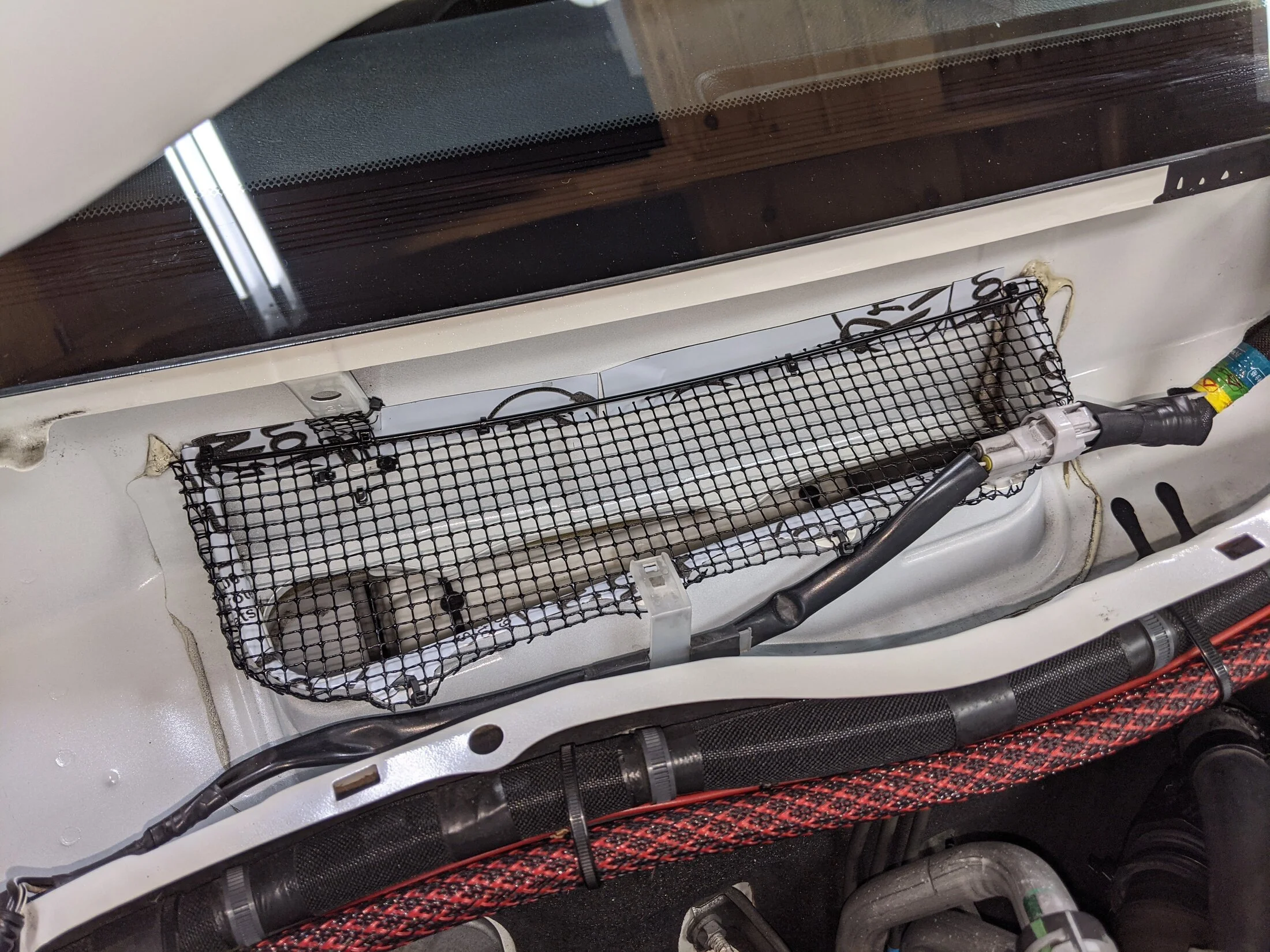

I did the same thing on my 200 four years ago, I put peel-and-stick flashing tape on the edge of the intake to protect it, then fastened the hardware cloth down with zip ties. I was worried about if I ever need to remove it.
