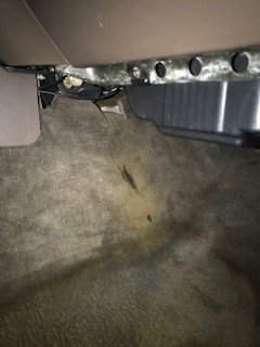

So for the first time in months I washed the LX twice in one day, trailered a boat for 200 miles and noticed radiator loosing coolant. In the past, my passenger floor board would sometimes by lightly damp, I assumed it was from the massive heat under the passenger floor board and the plastic bottomed oem floor mats creating a sweating environment. There was no coolant loss noticeable. Last weekend, I did the above mentioned activities. When I got home the floor board was soaked when I removed the mat. To the point where if I rubbed a towel along the floor it drenched the towel. Checked the radiator and did notice level about an inch down. While trailering around 65-70 mph the temps hovered around 196-204. It was cool out. Around 65 degrees that day.

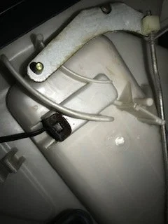

I thought at first that it was a bad windshield gasket, until I saw the coolant loss. Then I accidentally found the upper area of the firewall damp water was dripping off the wire that goes into the white plastic. I then took the picture attached. Now I am trying to figure out if I have a leaking windshield that happened to leak above this item, and have a head gasket of coolant issue or heater issue too. Too much happening at the same time. Any help or methods of checking would be greatly appreciated.
Was wet above the black spot, no water from under passenger seat. Just in front of it. Kids just told me they heard water sloshing when I would accelerate or slow down suddenly. Said it sounded like inside the car. Another variable. I might have a bunch of issues.

Going to clear panels with zip ties in am. Water is brown. But can’t be sure it’s just not mixing with all the dirt etc.
There are rocker plugs (about the size of a 50 cent coin) on the inside of the rocker panels under the car. Pull those to drain. Clear the seam weeps to prevent future sloshing.

Checked grommet. It is there. Was not really using ac recently due to weather. Ran ac an nice drip out of firewall through the grommet. Stupid question. If it was the front heater (white box in picture) , would it leak down when I top off the radiator and leave vehicle sitting, will it leak out while running or only if I use the heat?

Ok, this crap was driving me crazy. Went home from work, removed carpet on passenger side, started truck, let reach 175 temp and put heat on. Nothing. Then 30-60 seconds later I guess when pressure was right, water started dripping in a steady stream out of the spot in picture above. The white box with the wire going into it. Water was warm. So I guess I found the culprit. Search results showing removing rear heater or heater in total. Is there a simple way to delete the front heater only?

Add dye to your coolant to find the location of the leak. If it is coolant coming from the white box, then it is likely your front heater core. If it's your front heater core, then it will continue to leak even when the truck is not running, as BILT4ME said above.
I replaced my front heater core just this week. For me, the heater core was leaking so badly that, when parked on an incline, the coolant would soak the carpets and drain out the back passenger side, leaving a stream of coolant on the concrete. You may also notice your windows fogging up when it's cold out (not sure you get much of that in Miami) and a sweet smell coming from the vents. Just dye your coolant to be sure.
