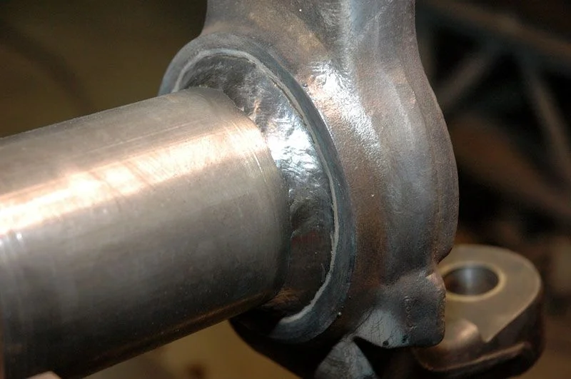

If you want 'no-spatter'...you run dual-shield wire period...everything else spatters..that way you have flux and gas shielding. The picture is one pass..dual shield..3/4" across. No spatter and fluid with excellent penetration. Now your welder does not have the current capacity that ours do, but you get the idea. I can not strees enough the two things that will help you in welding...good consumeables and a great helmet. For those that dont want the expense of buying a second bottle....i disagree, just buy one and be done with it.

NICE!
It amazes me how you guyz can do a radius weld without stopping at least 3 times...
For the life of me, I cant keep my had steady enough to make the turns without BLOWING it.
Very nice!
