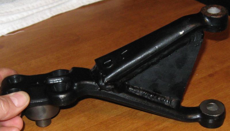

If steel, my plan was to weld the hole closed, heat the whole thing to cherry red with the O/A torch, then put it in a bucket of sand for a few days to slowly cool. After it had cooled, I was going to drill out a new hole then have it tapered.

It is definitely forged steel. You would not use cast iron, nodular iron or even cast steel in this application. While you can weld cast iron it almost always compromises its strentht and ductility. The exception is OA welding cast iron with cast iron filler under the same cooling characteristics under which it was originally cast.
If you weld up the hole and drill it and taper it, it will fit, but you will lose the strenght due to the forging process in the part that was welded no matter how you cool it or heat treat it. Whether the result is strong enough is up to you.
Bump I’ll add a pic.
So are you then using just the upper hole? Or are you running a bolt through both and have a “double shear” situation? If the first, that seems like a sketchy moment arm on the welded area. I’m not saying it wouldn’t work, just makes me stretch my head.
