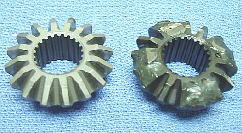

An option is to just weld a couple of teeth on the side gears. This is done out of the diff, so less chance of dingle balls, welding debris, messing up the works. Also is easily reversible, if you decide it's not for you.
Like this, pictured is for a 4 pinion diff, 2 pinion diff would only need to be welded in 2 places.
This is the kind of info I'm looking for! I'll probably end up putting a small piece of plate between the carrier and the pinion and seal weld it also. Just to ensure I get a "full" lock.
