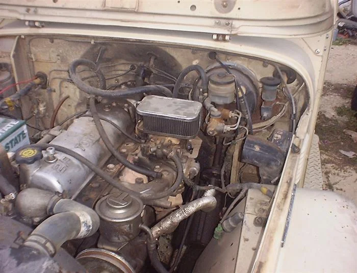

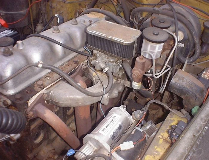

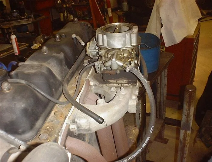

    the 32/36 is offered as a fuel mizer option... I prefer the 38/38... did a yard survey of 43 cruisers and 11 had webers... here is 3... 32/36s ...webers are very popular in my area....
