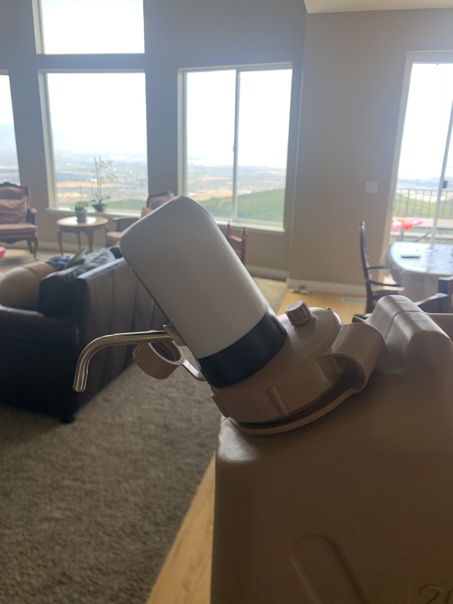

@MTNLIVIN how did you get this to mount to your water can?This is what I'm using on my Scepter water can. It's a little slow but gets the job done.
Water Pump
Same here.I'm in @Markuson's camp, keep it simple. But as has been stated here before, to each his own.

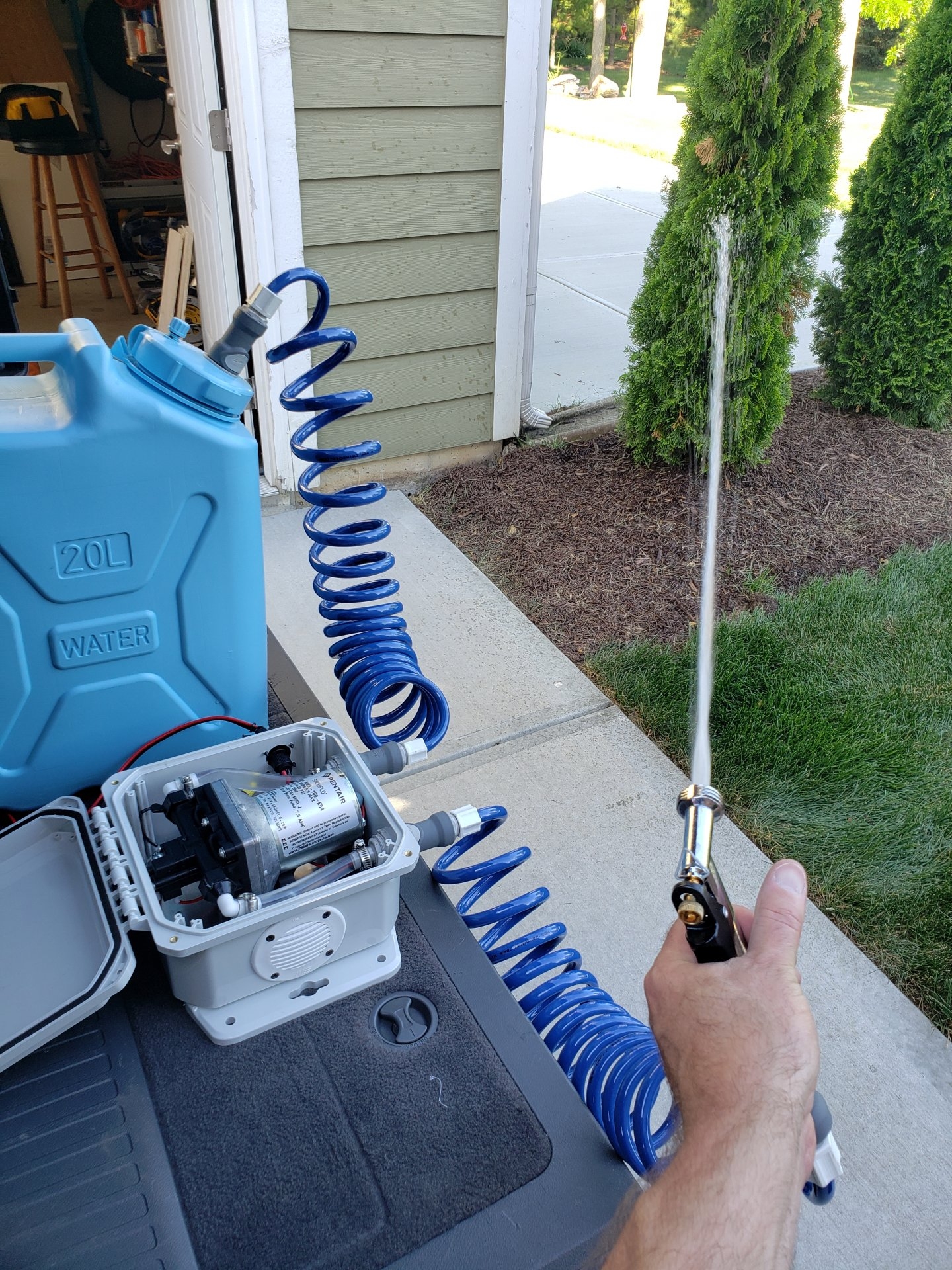

I just press it on and use it. Once I fill up my bottle I remove it and close up the jug.@MTNLIVIN how did you get this to mount to your water can?
Where did you source that case for the pump?Those quick connects are colder fittings. CPC NS6 line.
I get mine from Freshwater systems. They are spendy but pretty much leak proof.
I only use the fittings for pressurized water, not with gravity fed nozzle that just screws on and off when needed.
Hinged Electrical Junction Box from Polycase.Where did you source that case for the pump?
