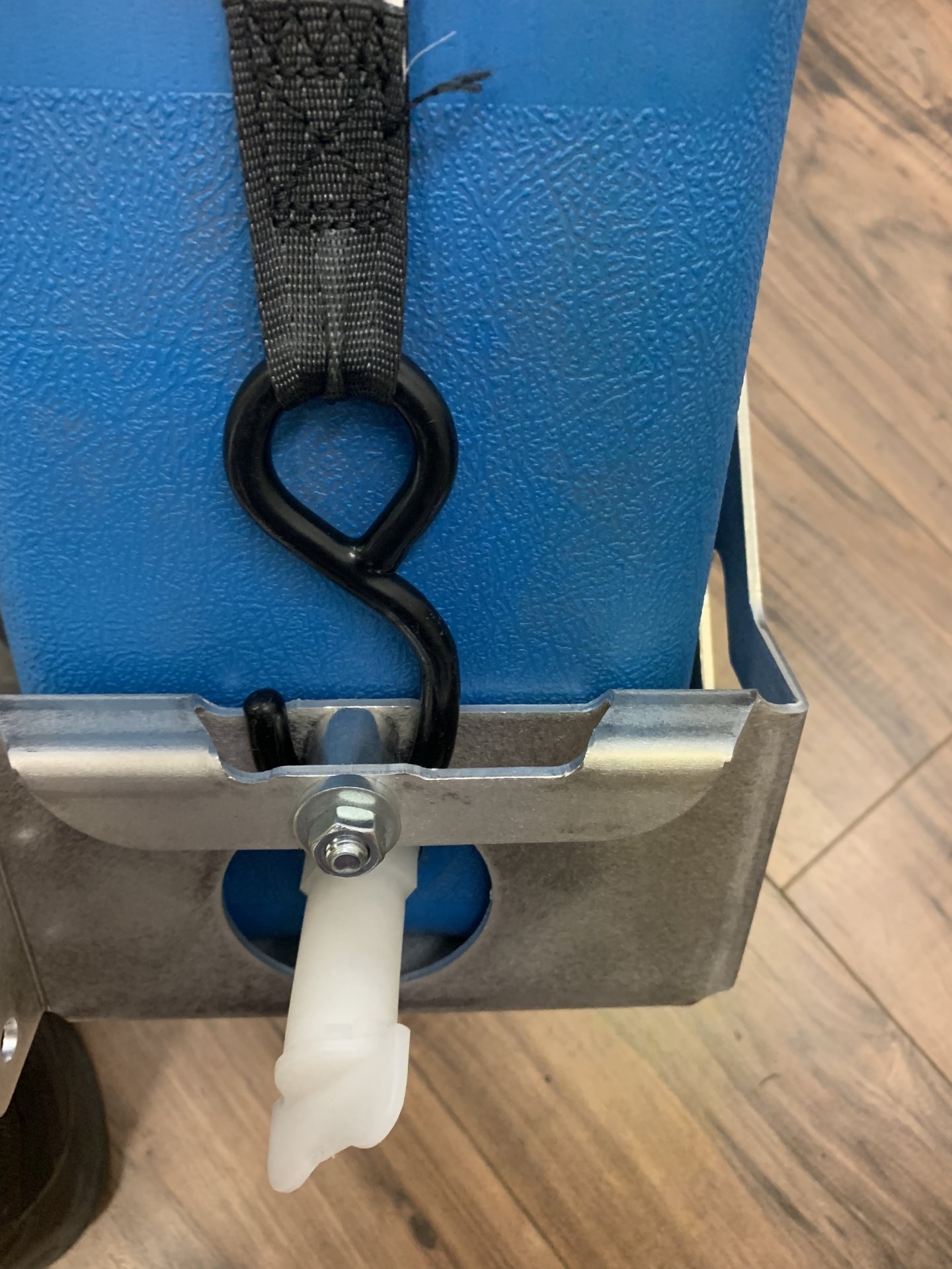

Yeah, spigot is hit or miss unless you have a good way to have it sitting somewhere or mounted. Yanking it in and out of the car with the spigot on is not worth the risk of a catastrophic leak happening with the spigot on while stored inside the vehicle. We are getting this mount for our rear bumper which makes the spigot more functional. Otherwise we pour into the bottle from the top.

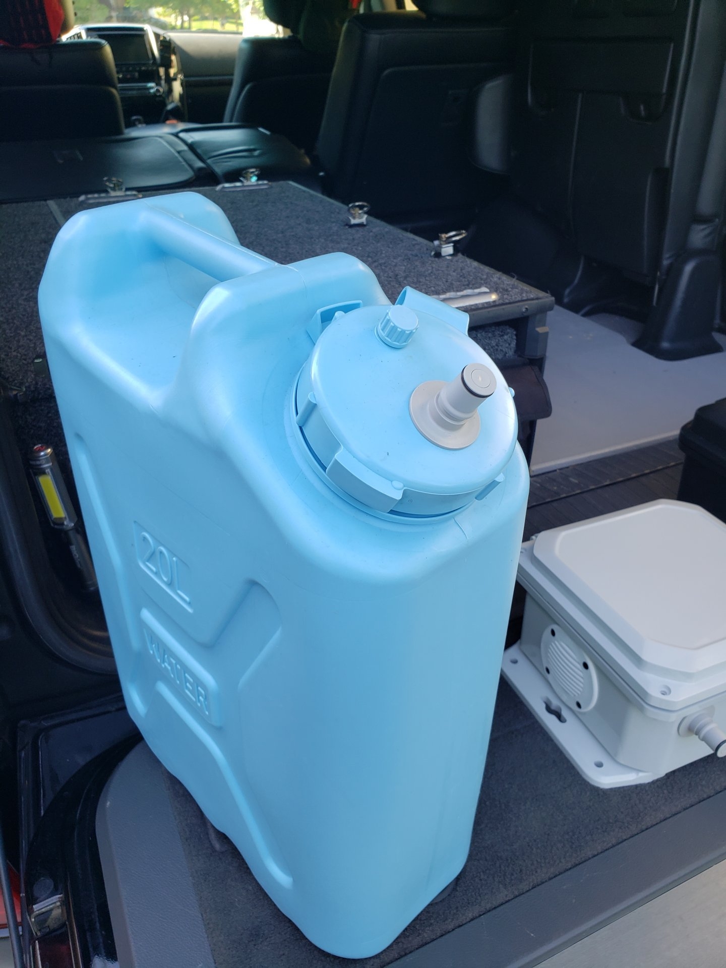

After researching water solutions, I ended up running the military style water can with a syphon setup. No power needed, can remove the entire hose setup and tighten the can for no leaks. Super simple and can use all the water in the can when standing upright
you can get them on ebay under "Siphon Pump Kit- For Scepter, LCI Military Water Cans, or any water container"
@borfoo3 This is super interesting. It would be easier to tie down this can in the back seat. Once I get a roof rack or rear bumper, this can be moved there for easier water storage. This might be the winner.
I did something similar a using a scepter water can with fittings and pump box.

Exactly.. I run two cans on the rear bumper carrier and one hose. Wherever you mount it, just keep in mind that the output nozzle has to stay lower than the bottom of the can to maintain flow. Once running it can keep flowing continuously till the can is completely empty.
