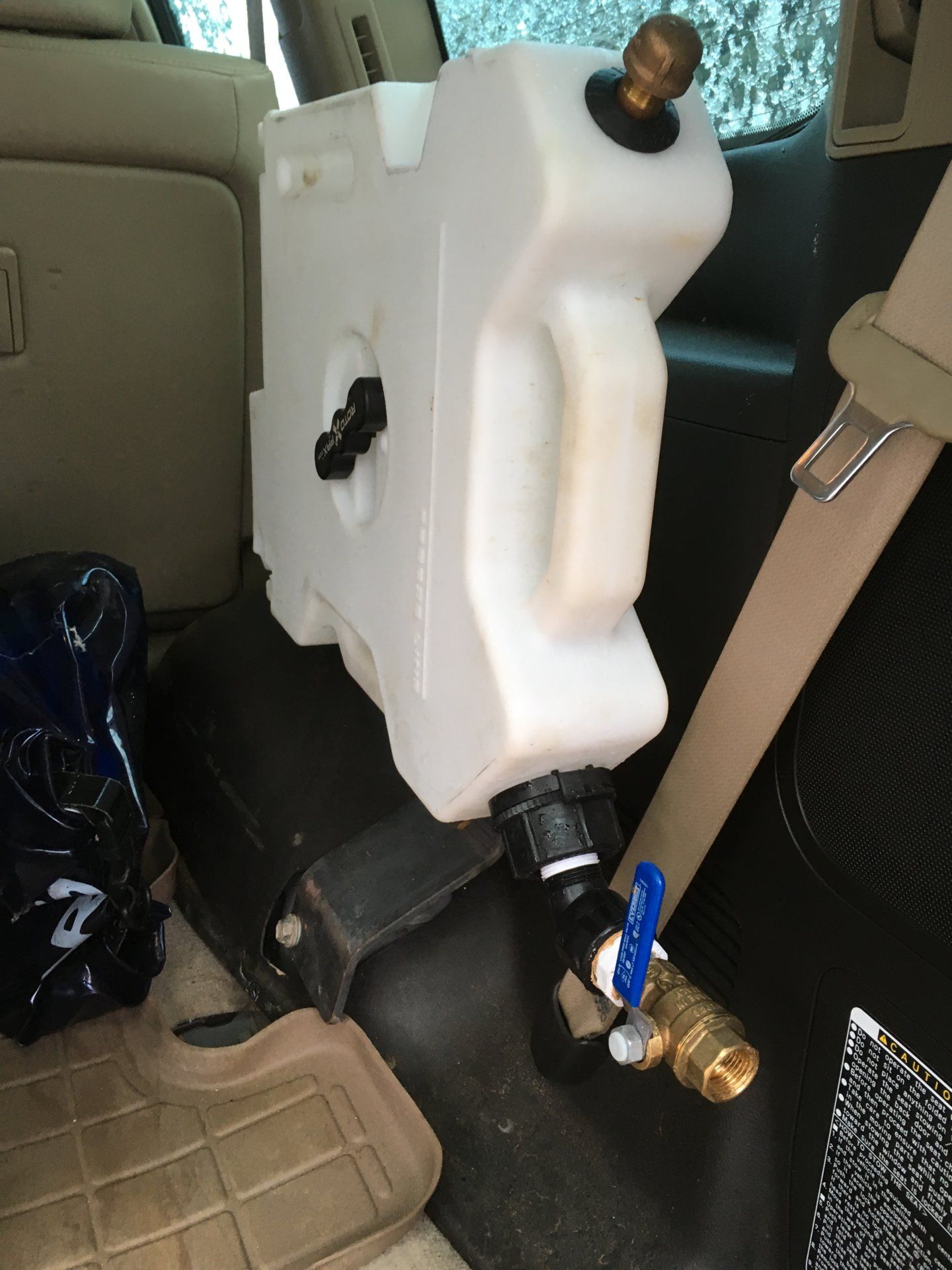

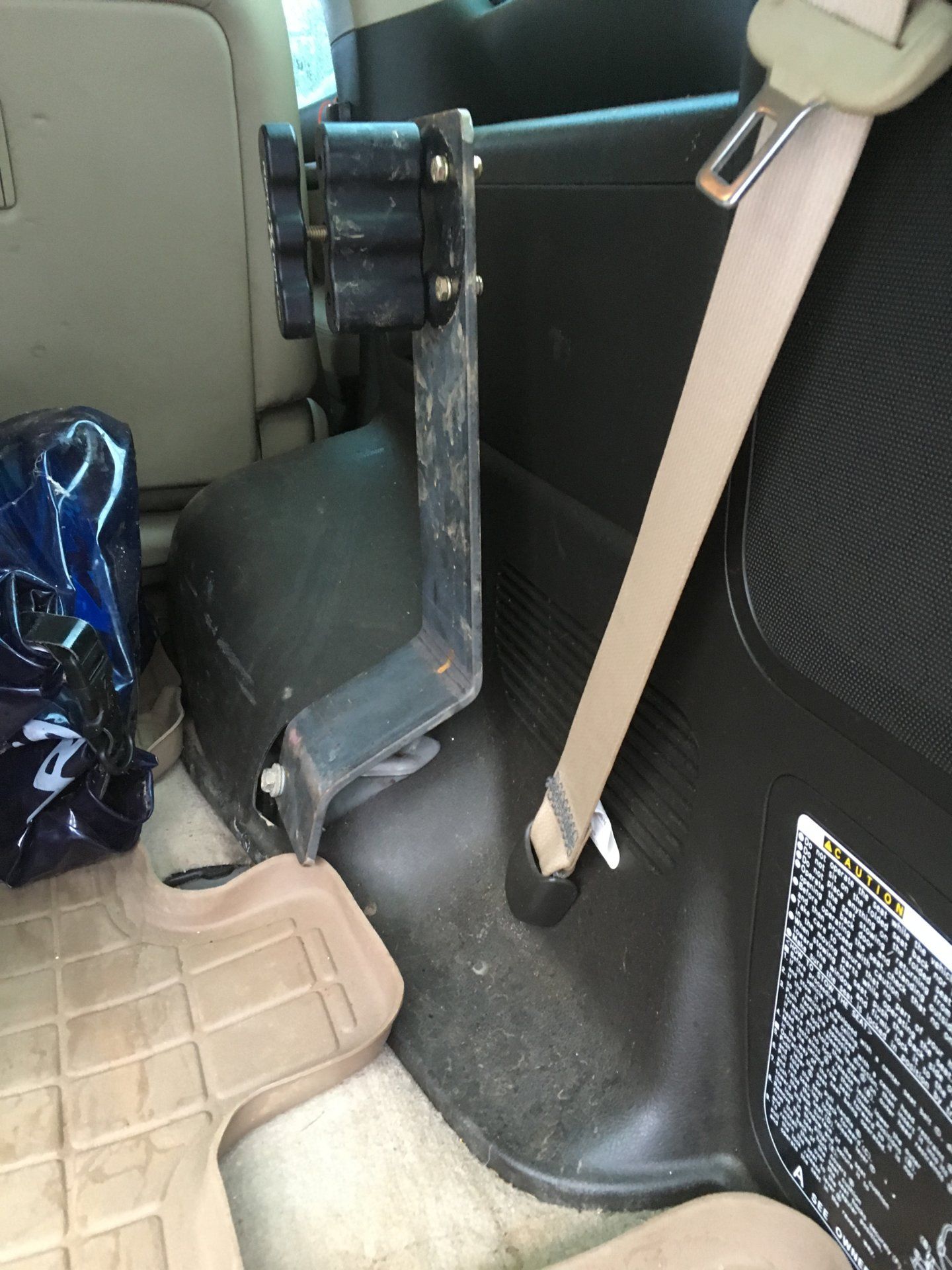

I mostly wanted something secure in case of a sudden stop or accident or rollover situation there’s isn’t a lot of water weight flying around the cab. Plus I get my water from a spring I’ve drank from since I was a child and I’m kind of a water snob for it. View attachment 1898590View attachment 1898591
Quick suggestion on your water faucet opener lever...
Loosen it and adjust the OFF position to be downward instead of what appears to be upward. If up is the OFF position, a bit a cargo moving/falling/shifting onto it could drain your water into your truck before you realize it. That would truly suck...
If you just loosen the screw & make lever-down the off position...that little potential disaster is less likely. :)

To the OP - I like your solution - and I'm thinking you could likely reproduce that bracket, powder coat them and sell them!
I used to work in the Child Passenger Safety industry and have seen crash tests and injury/death reports related to items left loose in vehicles - especially SUVs and MiniVans. Heck, a can of soup could easily introduce you to your maker....and how many parents actually secure their stroller in the back of the van/suv.....but a rollover event could send that thing flying forward into the passenger compartment.... Securing a 16 lb brick like that makes a whole lotta sense!
