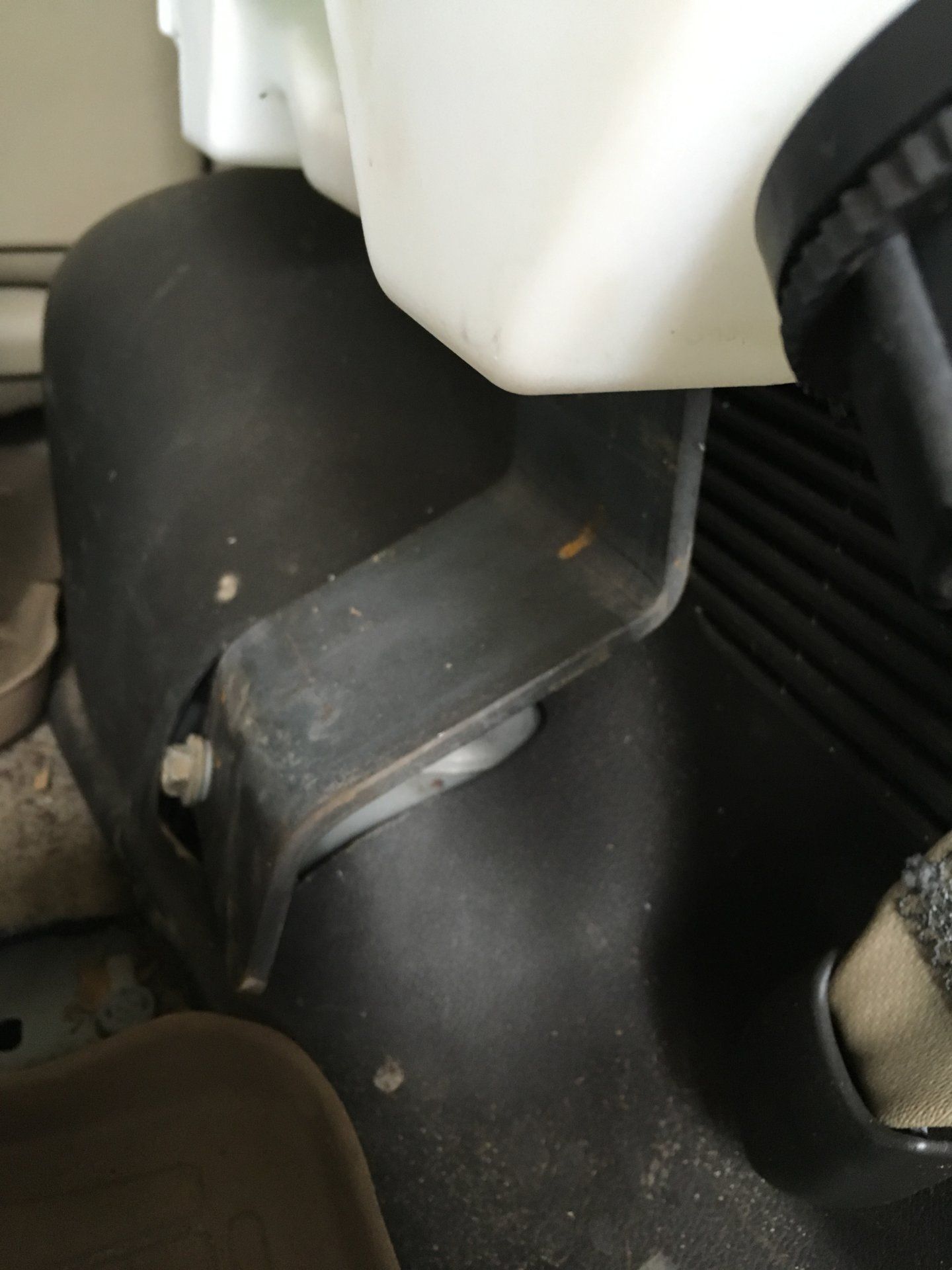

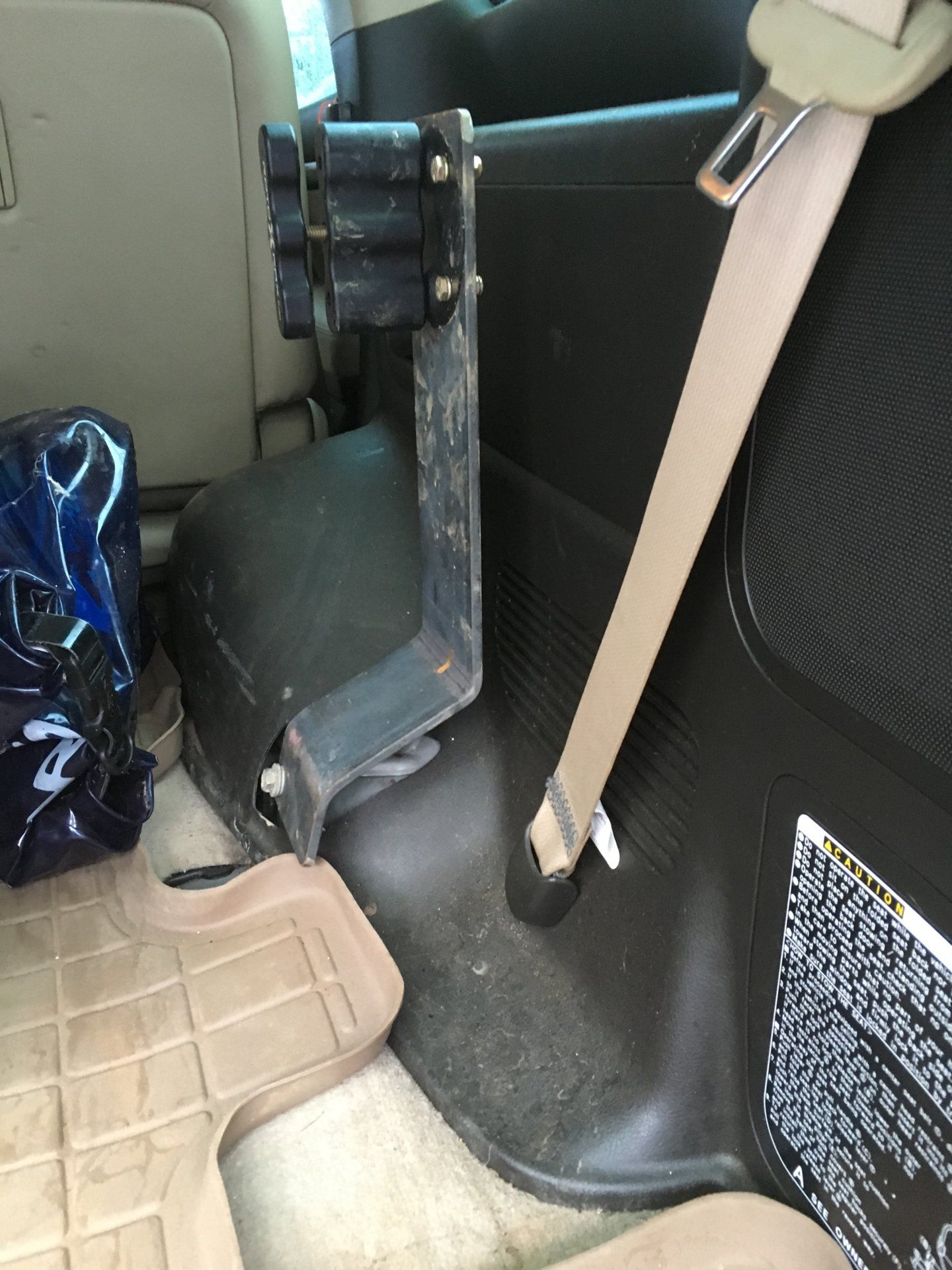

I finally figured out a nice solution for onboard drinking water storage for my 200 series that secured the water pretty well in case of sudden braking. I used a 2 gallon water rotopax container with a spout kit.
I have the 3rd row seats removed and used one of the mounting holes to secure a flange I had a welder fab up for me. I used flexible sheet metal to get just the right bend to follow the contour of the inside of the cruiser and then had him copy it with steel.
Since I took the pictures I’ve added a better shutoff valve on the spout and a uniseal with a threaded nipple for an air vent on the top.
I wonder why they don’t make a 3 or 4 gallon water version like their fuel packs. Then you could maximize that space from the back of the seat to the tailgate.

Any details on your spout?
@cboyd
I got the spout off amazon from gowesty. It worked alright but I upgraded it to a lead free quarter turn ball valve that I like more. The gowesty spout has a nice adapter piece though so id still reccomend it.
